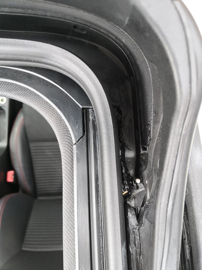

Just to cover the issue i had with my roof leaking. I had only owned the car a couple of days having bought it from a really good mate. My drive has a bit of an incline and after a heavy downpour I found water in both foot wells and traces of water emerging around the bonnet release in the passenger foot well. The Octavia 3 is very well put together and the interior trim is a bit of a pain to get apart, but removing the A-Pillar trims i found water travelling down the A pillars so knew it was coming from the roof.  I checked and cleared the drainage tubes as above to no avail - unfortunately my trim tools wouldn't allow me to drop the headliner and i didn't really want to get into that on my driveway, so booked it into a my local VW specialist.
I wet vacced a couple of litres of water out of the carpets -  they didn't need lifting, been there done that before on a fiesta and it would have been a nightmare, fortunately this coincided with a little two day heatwave and I managed to get it well dried. Shampooed the carpets with some biological washing powder, hit it with a steam cleaner and then air freshener and everything came up well with no nasty pongs.
My local VW place were spot on - stripped the headliner and water tested it,  confirming that water was getting in from the roof. They acknowledged this wasn't their usual work and suggested i contact Skoda for any recalls or TPI's for a known issue. My two local Skoda dealerships were totally useless and said there were no known issues. In the meantime my VW independent had been in touch with a friendly bod at Audi Technical who had found a TPI directly linked to my VIN for a panoramic roof fault - sums up dealerships for you IMO.
The TPI related to the seal between the bodywork and roof failing, leading to body corrosion - they could find no evidence of any corrosion but suggested it may be worthwhile as the roof would have to come out to replace the seal and this may allow for a thorough look for any further issues, so i asked them to go ahead. In the meantime i spoke with a fellow member on here who had a similar issue and had DIY'ed it, having removed the roof and found that part of the boding has failed and needed renewing.
Funnily enough, when i went back to my garage, they also mentioned that they had water tested the roof out of the car and had found the bonding had failed between the roof and the plastic tray which it is supposed to be bonded to. They renewed the bonding, water tested it on the bench and there were no leaks. They then fitted the new seal, refitted the roof and water tested on the car - no leak.
Touch wood a couple of months later there have been no issues - I regularly check the carpets for damp and have whipped the a pillar trims off a couple of times since to find it bone dry.

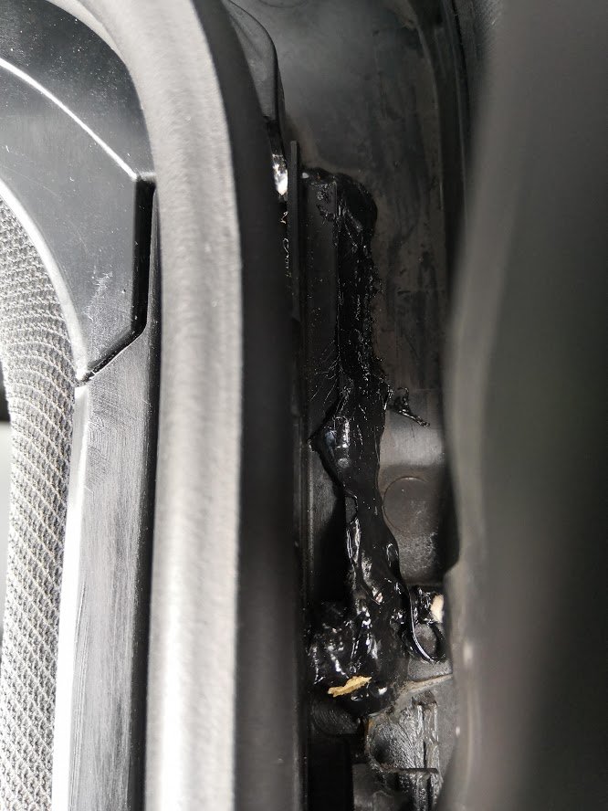

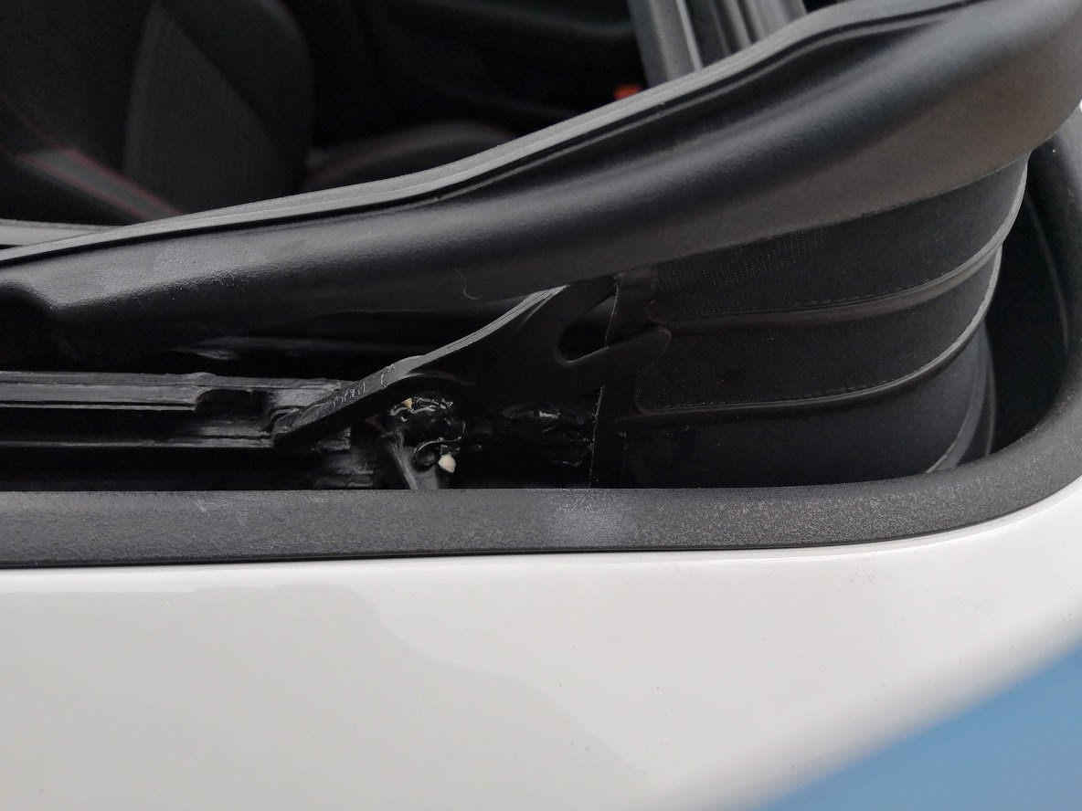

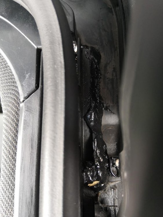

I cant say exactly where they have bonded, however when lubricating the mechanism the other weeks i noticed a couple of spots of tiger seal or similar just ahead of the wind deflector hinges - this 100% wasn't there before the garage did the work, so it seems a good shout for the location of the leak - i have attached a couple of images should it assist anyone.
Hopefully I never have any more issues and don't need to learn anymore about these panoramic roofs - hopefully what i have experienced will be of use to some of you though.

Hello everyone,

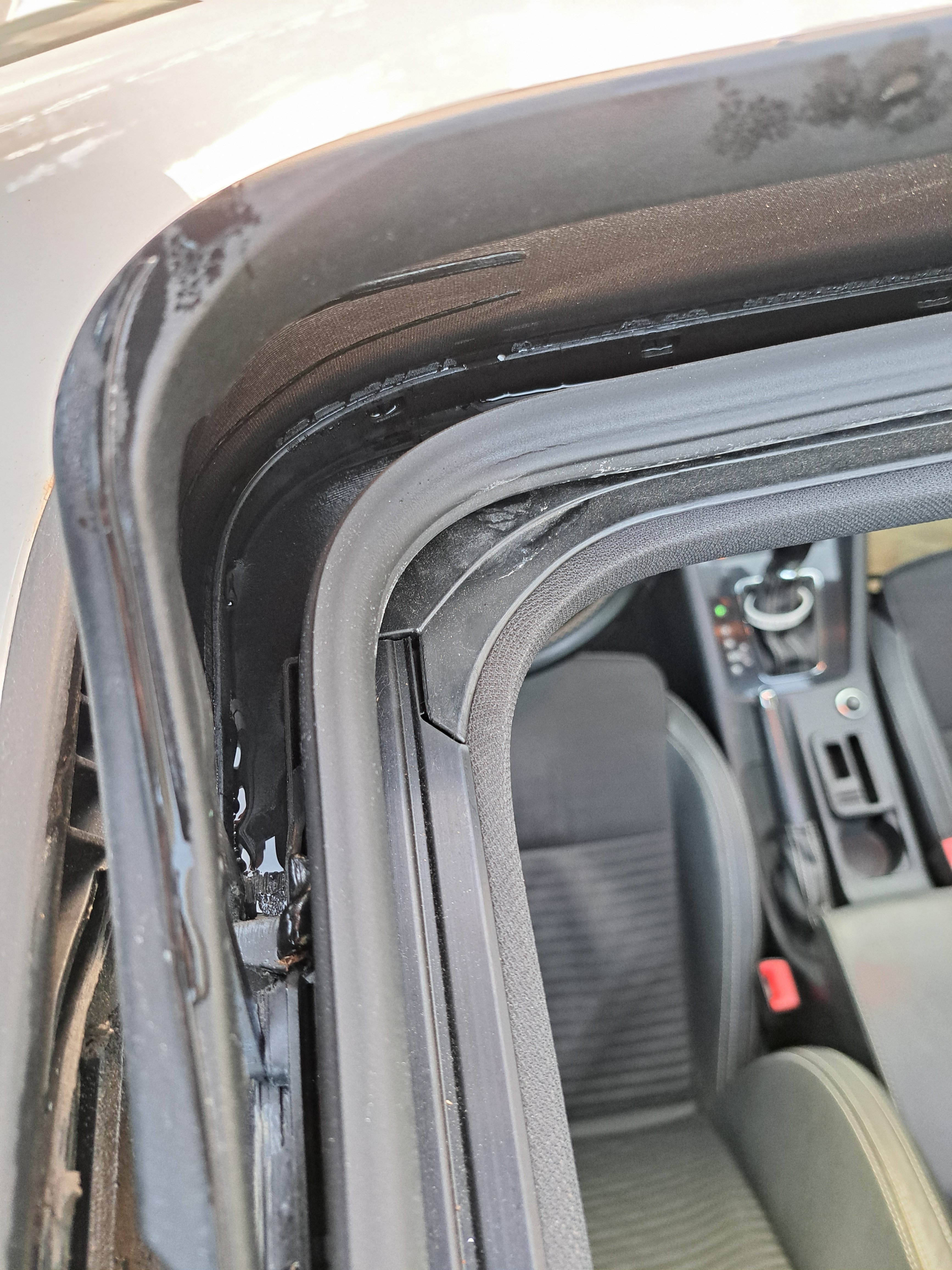

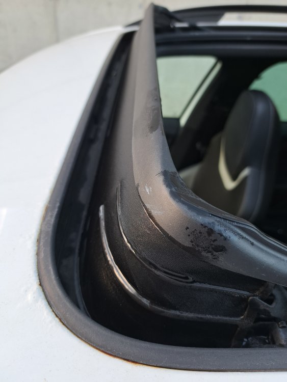

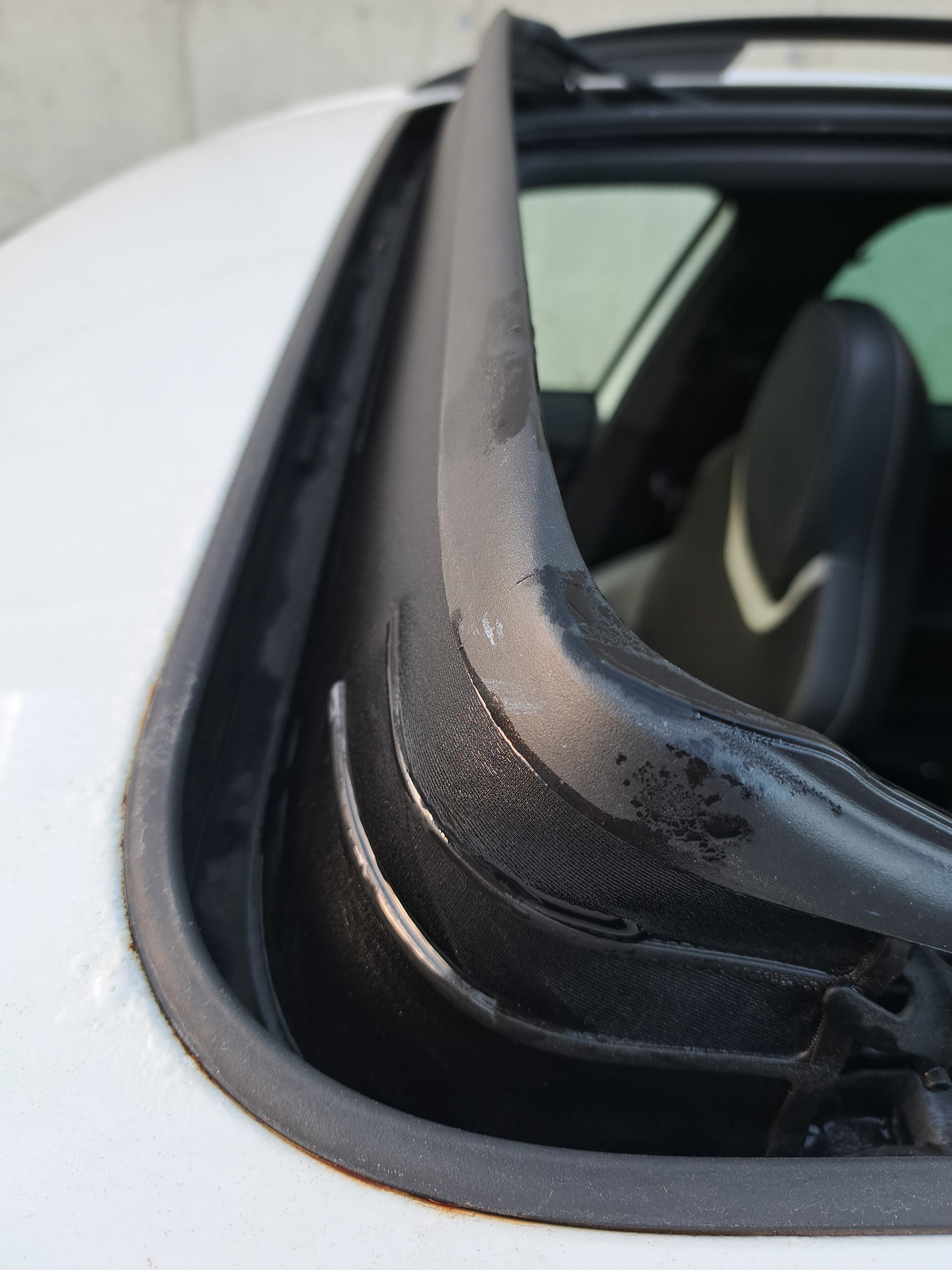

how is it possible for water to get into the lower area of the draft deflector (see attached photos)?
If the water passes between the body/glass seal of the panoramic roof and arrives in the drainage duct where it then exits through the drainage holes, it should not be able to enter where the draft deflector is.
I don't understand what's causing it.
Thanks,
Daniel
