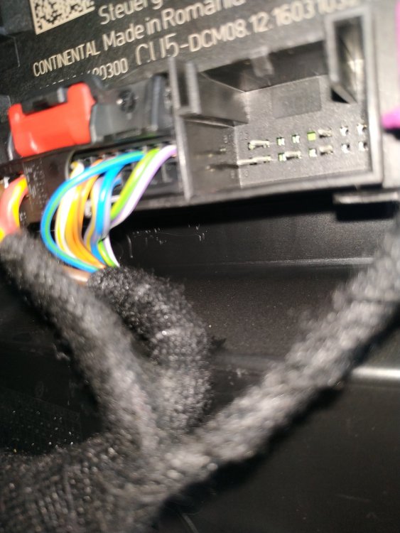

Hi, I have an octavia 2017 and I have a similar question. I want to install puddle lights to wing mirrors, but I dont know which pin I must use. I took a photo of my male pins. Sorry for my english. Thank you.

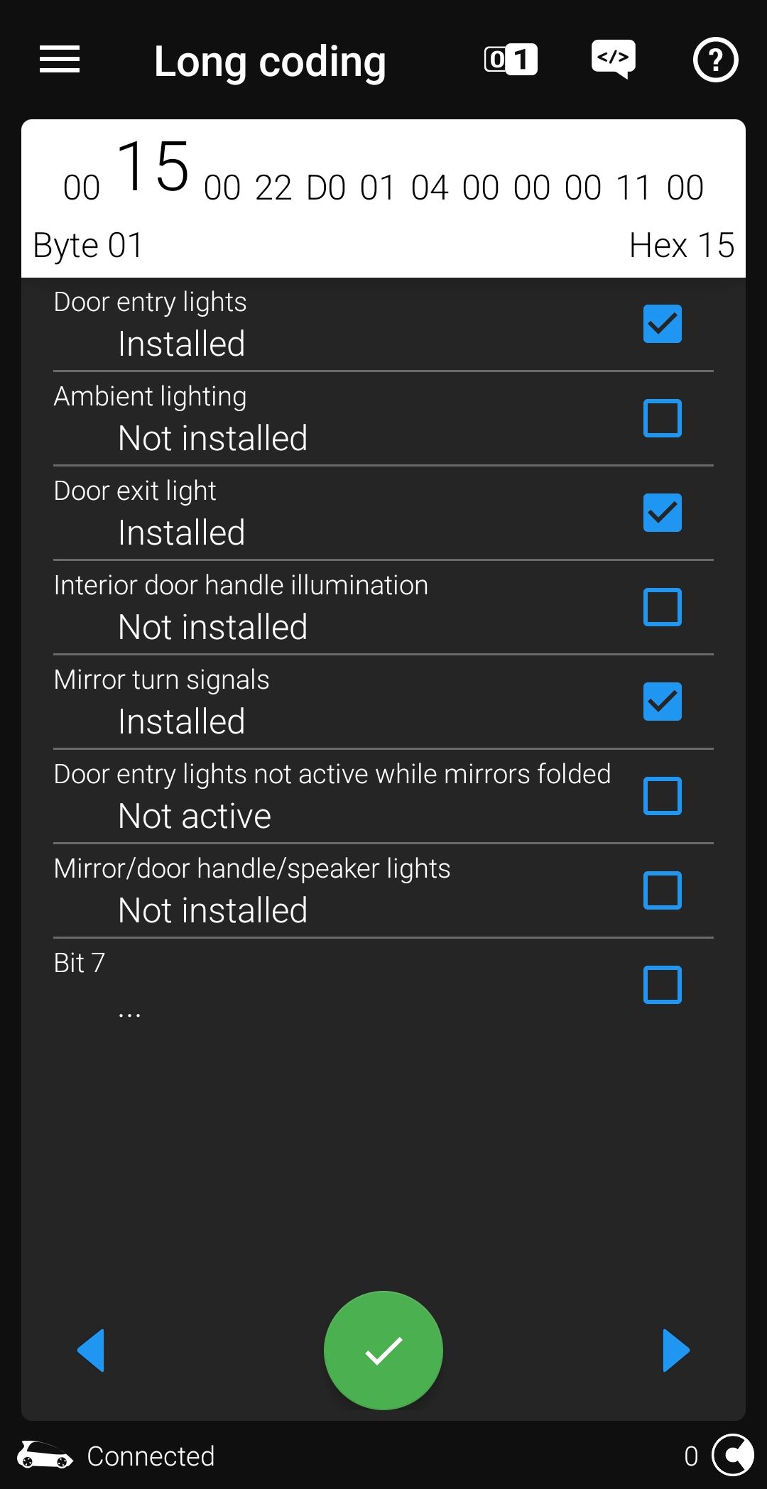

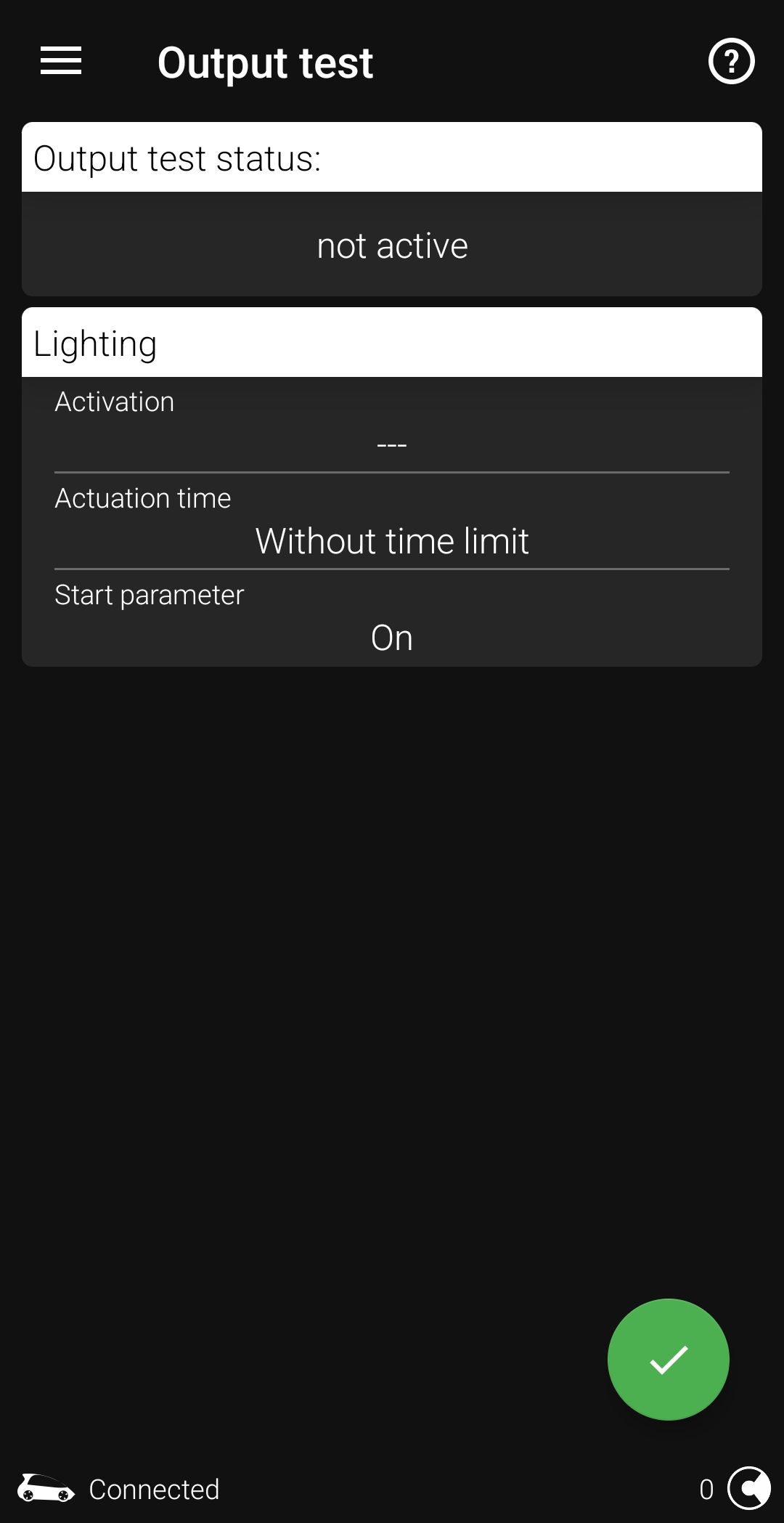

ok i think its  definitely coding as when i do the output test on the OB11 they both work - i have led puddle lights active in settings but on this it shows not active
Did you turn on byte 1 bit 0?
Hi ApertureS,
 i have that sellected - i wonder if the hex value is correct ?
they work when tested under the output test fuction
and its enabled under the retro fit apps
Edited by coopster
ok all sorted - i deactivated it all on Ob11 then reactivated one at a time turning off ob11 at each change.
working a treat now - :)
Don’t use the one click functions, they cause nothing but problems as you don’t know what they do exactly
Yep the one click function definitely didn't help in my circumstances.
