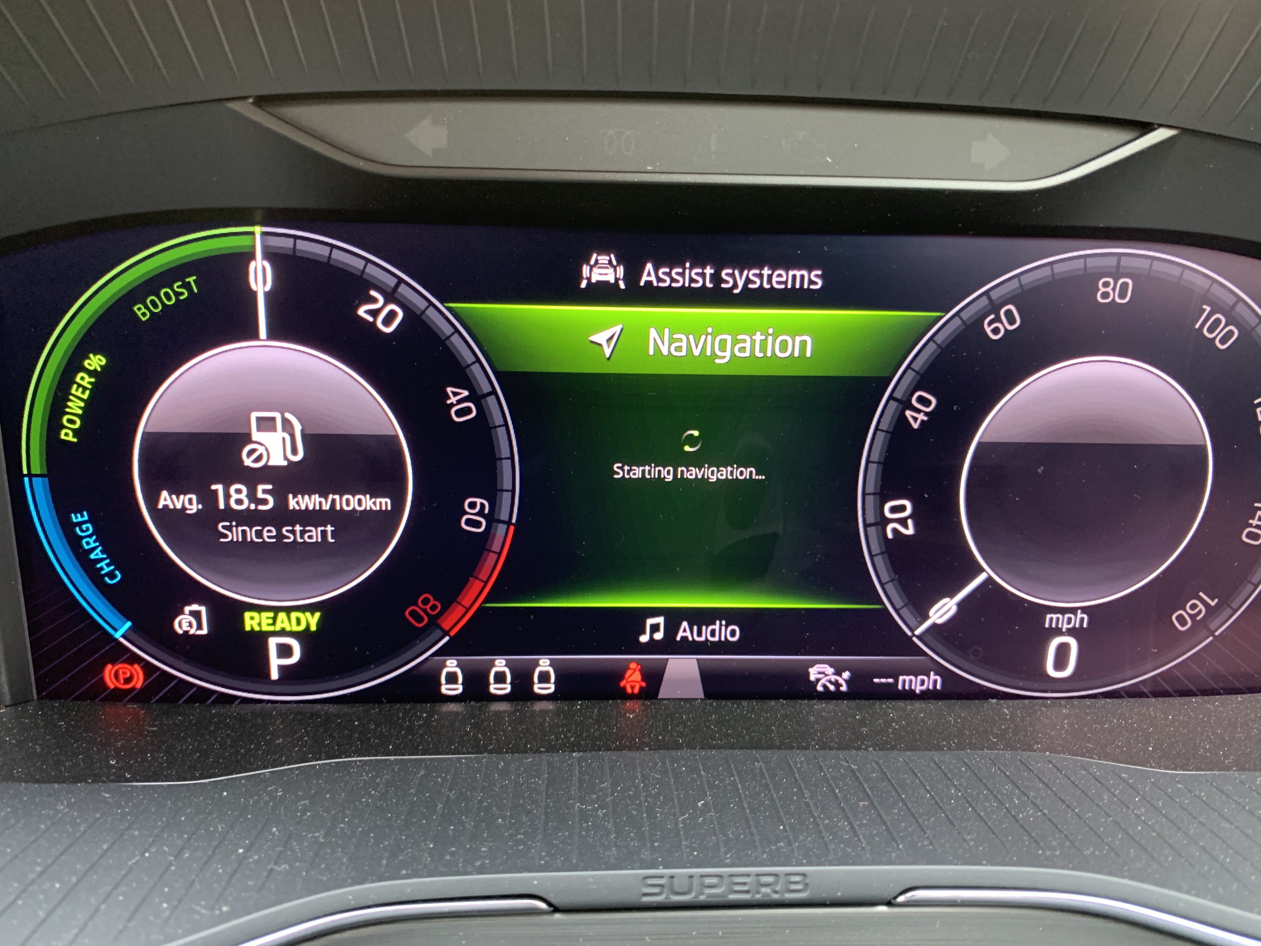

I have a new Superb Estate iV SEL spec with the virtual cockpit option. When I select Navigation Display I just get the compass rose being displayed in the virtual cockpit. How do I get the map to be displayed? Is there an option in the centre console that I need to select?

Thanks for that. I have seen it before but it doesn’t help me. When I select navigation as he does from the scrolling menu I just get the compass rose. No map!

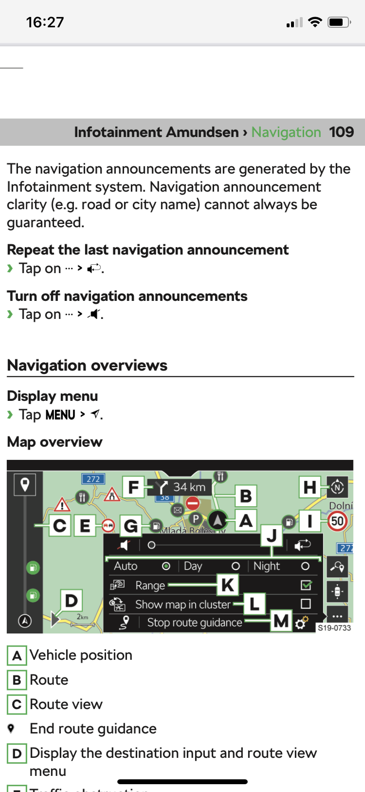

just been reading the manual again and saw that in the Bolero Navigation setting screen there is an option to extend the map display to the Virtual Cockpit. But on the Amundsun system there is no such option.

So it's really rather simple. Press once the button on the steering wheel that shows something like pages and a "Back" button over them:
This should open up the selection of screens ON the center of the VC, and then by scrolling down/up via the rotary knob you arrive to the Navigation screen (it's above Audio)
and there you have it. You can then enter full screen Navi mode but pushing the View button on the steering wheel and scrolling through the various views.
IF there's not a Navigation option when you press the "page-back" button then something is missing or not set up properly.
I just realized you must have tried what I wrote already because I essentially access it as the guy in the full length video above does.
So, when you select Navigation via the "pages" button and then the thumb wheel, how does your VC look like? Please take a pic and post it here as i'm really curious about it.

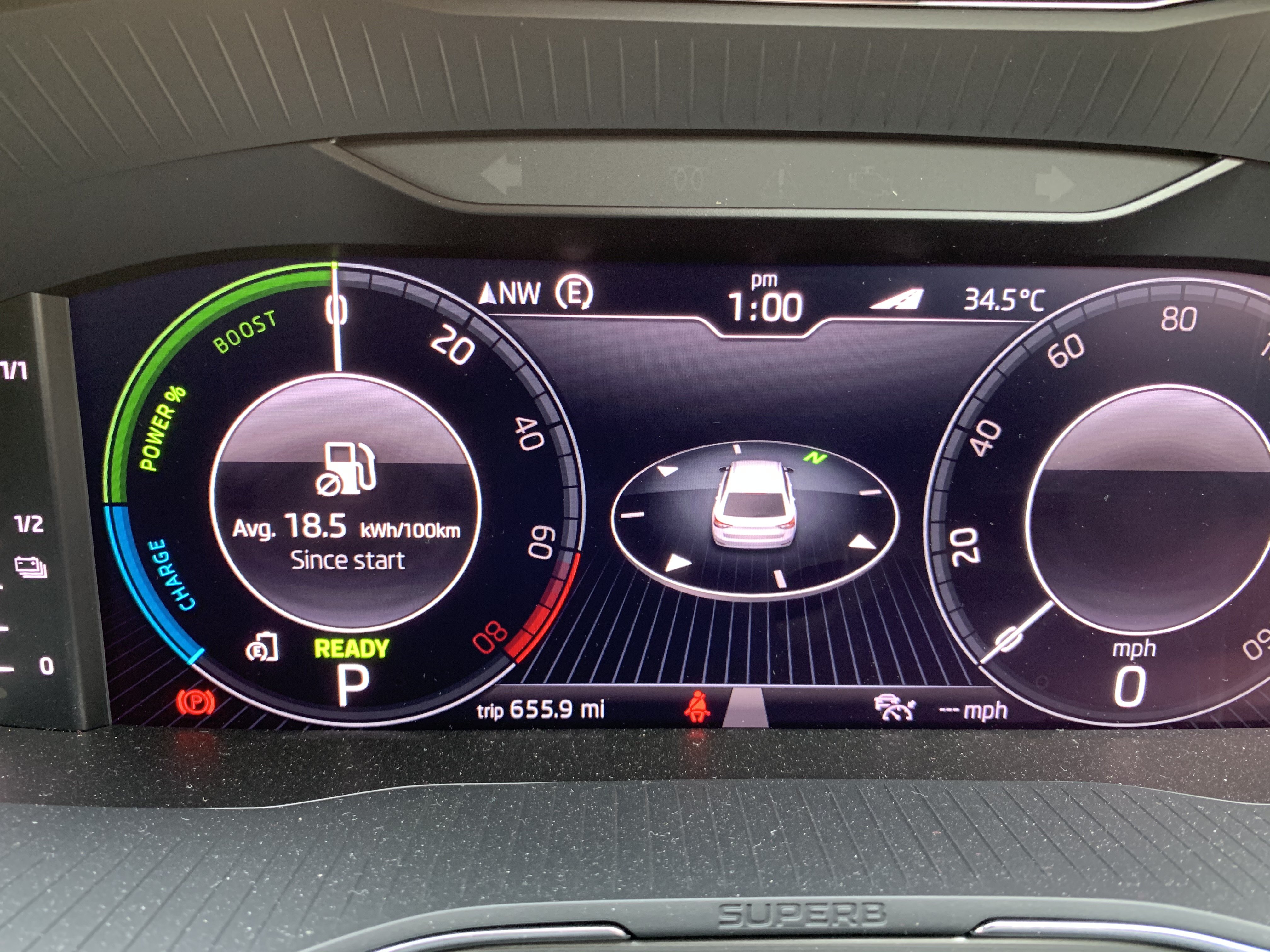

PS. I think I have a bad feeling about this as in: You can only have the map on the VC if you have the Columbus 9.2" system....  That would explain why I can't even get a compass as my "main page" when I select Navigation, (i can only have it as a side dial from customizing the views) but you have just the compass showing up instead of a map when selecting Navigation. Otherwise it's impossible to get it wrong I think.

2 hours ago, Rescue-Diver said:
This is what I see
Yep, I can't have the compass displayed in the centre on mine at all, selecting the Navigation page just brings up the map and I'm not aware of a way to change it.
@JR RS  @Gizmo   are maybe aware of whether the full map on the VC is only possible with the Columbus instead of just the Amundsen?
Hey @newbie69, as far as I know, the VC requires a fibre optic cable in order to show maps/navigation.
This connection is only available on the MIB2.5 units, i.e. the 9.2" Columbus units.
This is based on those who have successfully retrofitted VC units into their Superb.
Thanks JR, that would explain why Amundsen is not enough to display maps on the VC of OP's car, unless something is different to the 2020 cars and Amundsen got a fibre optic (unlikely)
