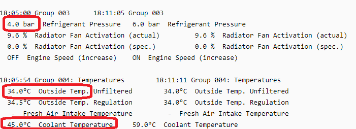

Watching with VCDS there is an immediate jump in pressure when the AC switch is turn on, and that gets up to about 8 bar before dropping off back down to about 6 bar.
As I said, I will try and source and N280 and see how that goes.
That sounds more like a low refrigerant charge, the low & high side (where the sensor is) are equal when the aircon is not running, at current ambient temperatures it should be 100-110psi, if VCDS gives absolute pressure then 6 bar is probably OK  but doing what it does is an indication of low charge, it raises the high side initially but then is starved on the suction side.
I would ask the garage to do a recharge & if it doesn't cool then get them to vacuum back the refrigerant allowing you to replace the valve which does actually sound like its working.
The radiator fans should cut in when the pressure peaks and then it should drop off but I dont think yours is going high enough.

His table above shows 4 bar G65 pressure with engine not running, that does indeed seem low for the ambient temperature recorded of 34°C. Slightly puzzled by why the engine coolant temperature is showing as 11° higher still. Was the front of the car facing South?
@J.R. We should both compare VCDS and high side gauge readings to put to bed this question about whether VCDS talks absolute pressure or gauge; I'm almost sure it's the latter, due to empty systems showing a 0.0 bar pressure, not 1.0 bar.

@Wino Yes, the car had been in the sun all day, so it's no surprise that the coolant temp was above ambient.
For now, the car has had a regas, and we are now at 6.6bar steady state, rising to 10, then dropping to 7.6 bar when the engine is running and AC turned on. When driving you now get small intermittent blasts of cool.

Later on I will compare the engine not running static pressures of both using VCDS.
Both cars would drop the temp additionally between 1 & 2° when the recirculating function was used, not as much as expected with such a high ambient temperature.
I will also check with my guage set to see how high the high side goes before the cooling fans drop the pressure.
I dont know if either of my vehicles has too much or too little charge but maybe the measurements will give an indication.
No cutoff code, that stays at 0. And fans sounded like they were running, but I didn't check under the bonnet to see which ones were active.
I was suspecting the flaps before, but now I've felt some cool from it, I think that is less likely.
Recent experience with the glovebox out shows that having A/C on closes the recirculation flap (no external air flow) on the blower regardless of manual recirc setting.
I imagine that's to cool the interior more effectively and upon reaching a low enough cabin temperature it would then open partially/fully allowing fresh air in.
