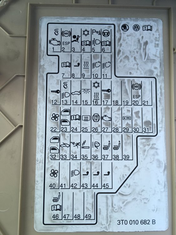

Other posts suggested issues with fuses. I checked the fuses in the box beside the battery and all seem OK. However, I cannot figure out how to check the strip fuses connecting into the fuse box - there is a black plastic strip (see Pic 1) running across the strips and it won't budge / I'm concerned I'll snap something not meant to snap. Is there a way to pry off that black plastic strip to check the strip fuses?

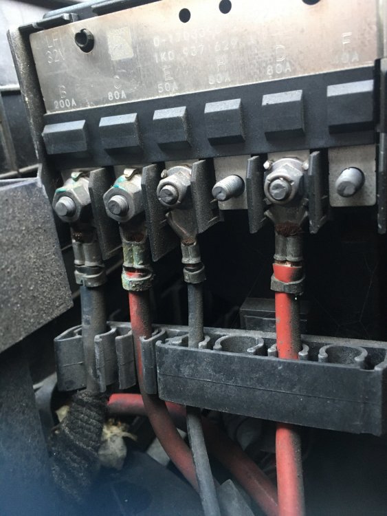

Also, the fuse in position 2 on the right side of the steering wheel (it's and Irish RHD) marked as being ABS/ESP is OK, but there was no fuse in position 20 that is also marked ABS/ESP (see Pic 2). I'm guessing there never was a fuse there - no fuse was in the foot well to indicate a fuse somehow popped out (can that even happen?).

Skoda never printed an insert card for the internal fuse panel for RHD cars, which have a layout that's a mirror image of that in LHD cars, so you have to factor that in when checking fuses.
