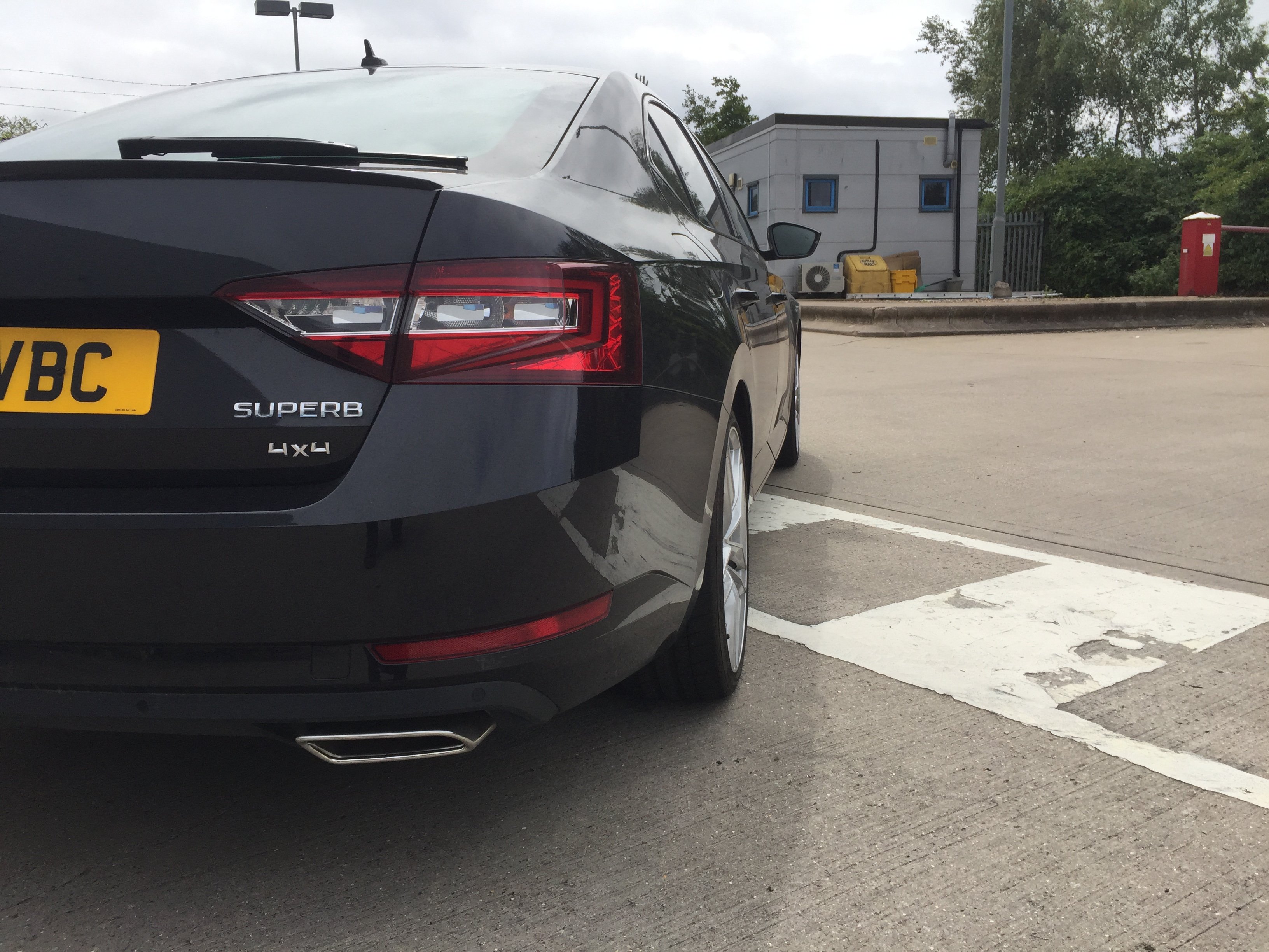

Mine has a 4 x 4 badge on the boot and there is no wheelspin from a swift launch.
Edited by shyVRS245
Photo added

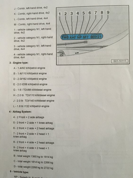

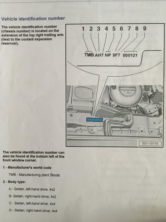

Check the VIN 4th letter from left denotes Body type / drive.
This is quite interesting - thanks for posting.  I can now see that I have a 4x4 Superb with the 2.0ltr TDI 140kW and have 2 front, 2 side, 2 head, and a knee airbag.  Wicked...
