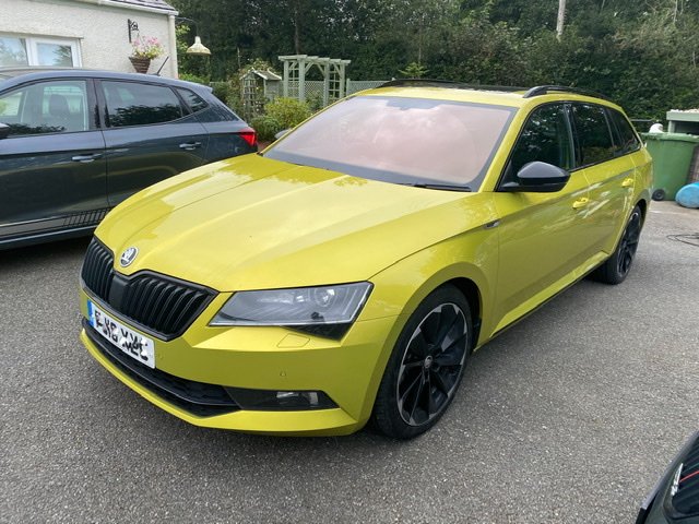

And for some Superb content, check out the car I had in for a camera fitting earlier in the week. What a beauty!

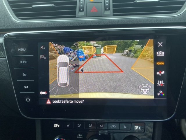

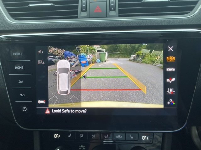

This one was a OEM Highline one with washer and these are £399 fitted.
Hi Sasha. Could you give me hint about the washer part? I did install the highline camera like a month ago, but I couldn't see where the washer pipe should be connected...
