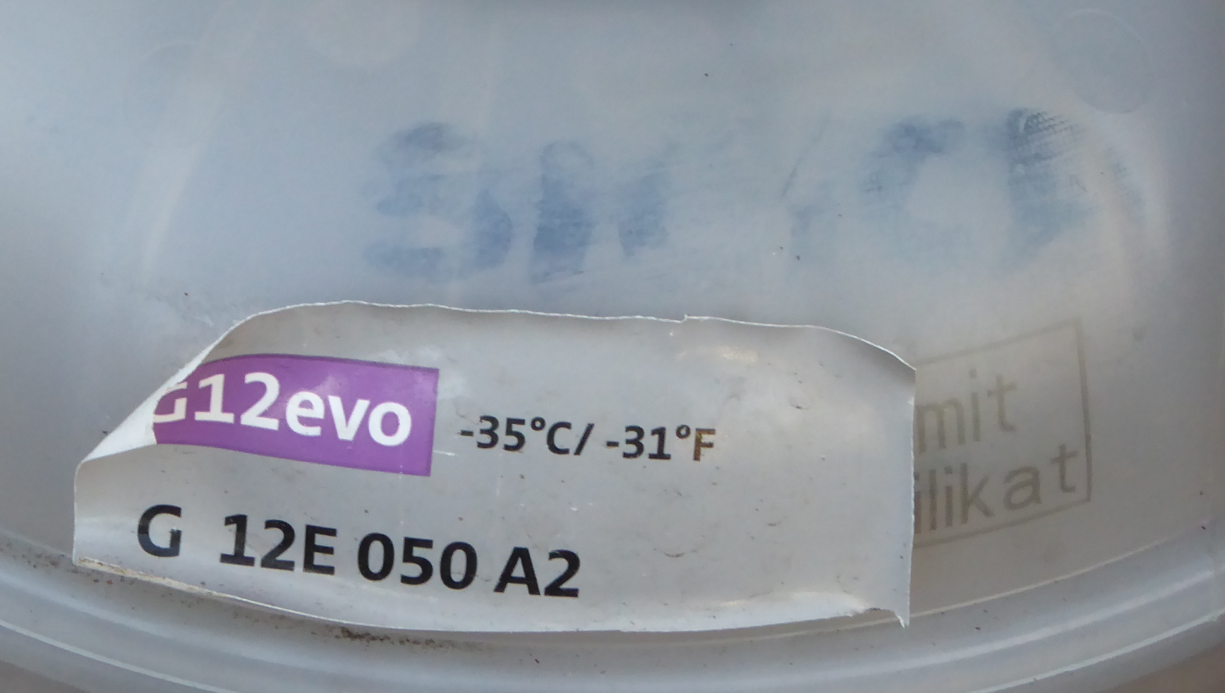

In case anyone searches and arrives here, as I have just found out from my Skoda dealer parts man, the latest spec. coolant is now G12 Evo and from the parts man "does all models".
This is the stuff.
