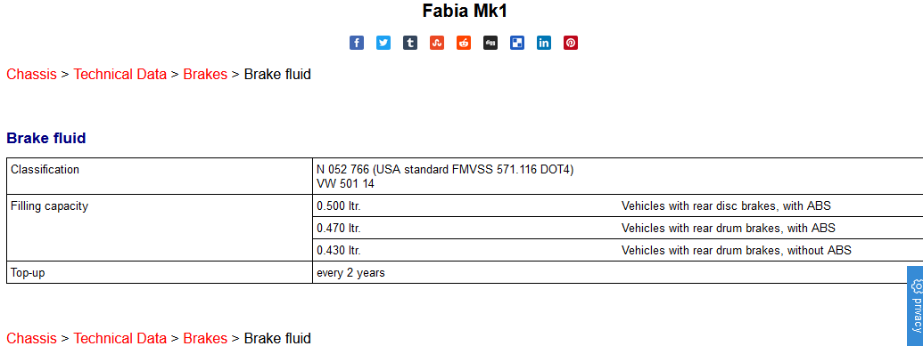

2004 tdi MK1 brake fluid quantity.
Apologies to those who gave me the data some time ago ,but I've lost the volume needed and can't find the answer on a search.
I'd intended doing a much overdue fluid change some time ago, but put it off
I've acquired a leak from a rear wheel cylinder and it's time for a new rear cylinder and a  bleed. Most probably the line to that cylinder has fresh fluid, but since I'm going to have to bleed ( possibly rears, and possibly fronts), it might be worth flushing out the old.
So what quantity of DOT4 do I need to flush out the system, considering that last year I had the other rear wheel cylinder  replaced and system bled.

If it makes any difference, I tend to use a complete 1ltr can of brake fluid when changing brake fluid, maybe if planning to carry out a fluid change, you should consider how much you should "vent" out of each wheel  cylinder/calliper than only think about system capacity.

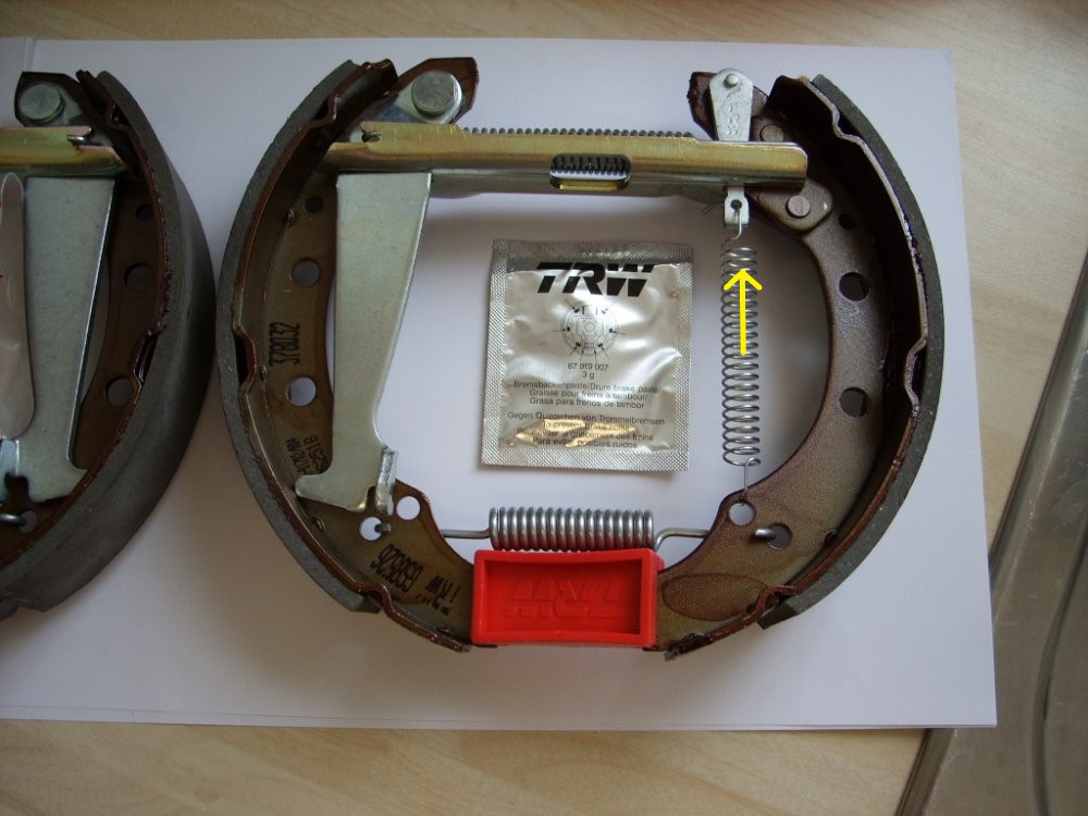

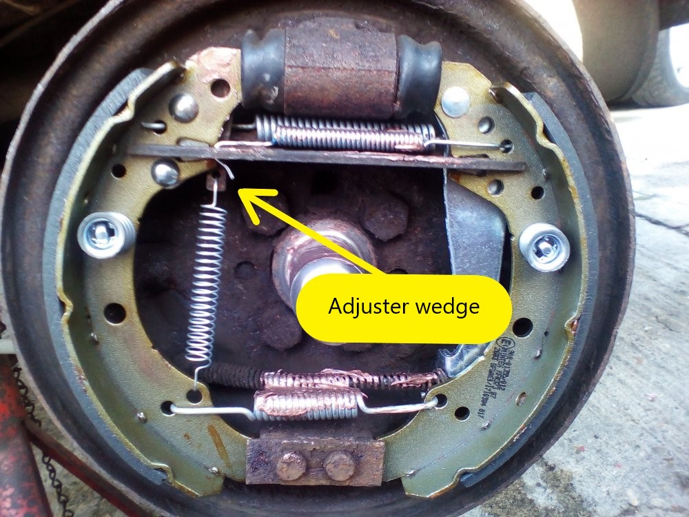

Next request- brakes great, but I forgot to take photos of the spring setup, and I've noticed a shudder in reverse ,plus the odd warming of the rear wheel, add to that I had a bit of a problem with the usual quality of Haynes photos. I'm about to go back in to ease my mind, but in meantime has anyone got an diagram showing the positions of springs .( it's offside rear drum), no discs.
, if it makes any difference). I must be getting senile-as last time I sorted out a seized rivit all went back to gether with ease . I said at time it was the easiest set of drums I'd ever done.
TIA
RUM-I was working the other way- know how much is in system ,then put in that much + a bit more. THB it's first time I've ever had to do a brake fluid change as all the other cars I've had needed parts changing that often I must hacve done many brake fluid changes over the few years I owned them.
Edited by VWD
Got a couple of pics of the other side that might help.
IMG-20180119-134542-thumb-jpg-43e0d0fb8c

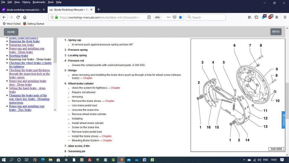

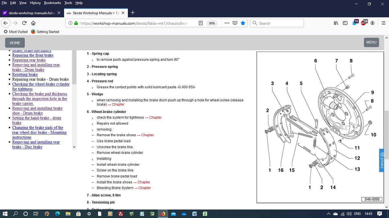

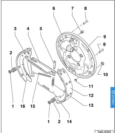

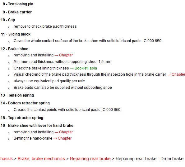

lee - once again you've turned up trumps. That second photo is what I needed. it's the position of the top retractor spring I needed. I did a bit of digging online and found this site
https://workshop-manuals.com/skoda/fabia-mk1/chassis/brake_brake_mechanics/repairing_rear_brake/repairing_rear_brake_drum_brake/
and a breakdown of the parts with a diagram, but it does not show the system assembled. I'll post it here in case it's of interest

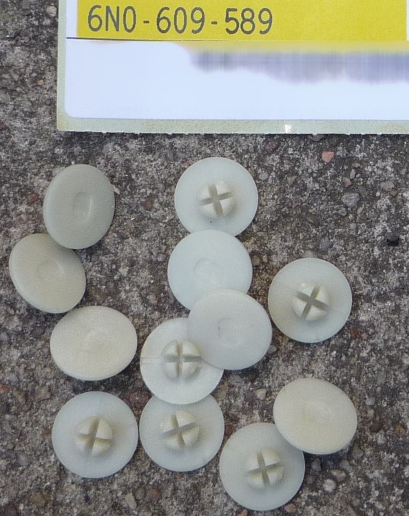

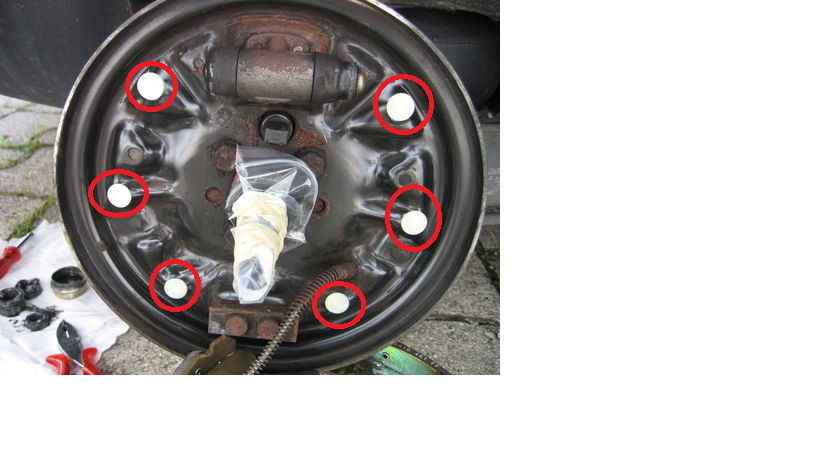

Did you check the nylon glide pads on the backplates when you had the shoes off?
Trommelbremse-Gleitstuecke-JPG-2da6f3776
Edited by TMB
I did. They're passable, but something to get for next shoe renewal.
