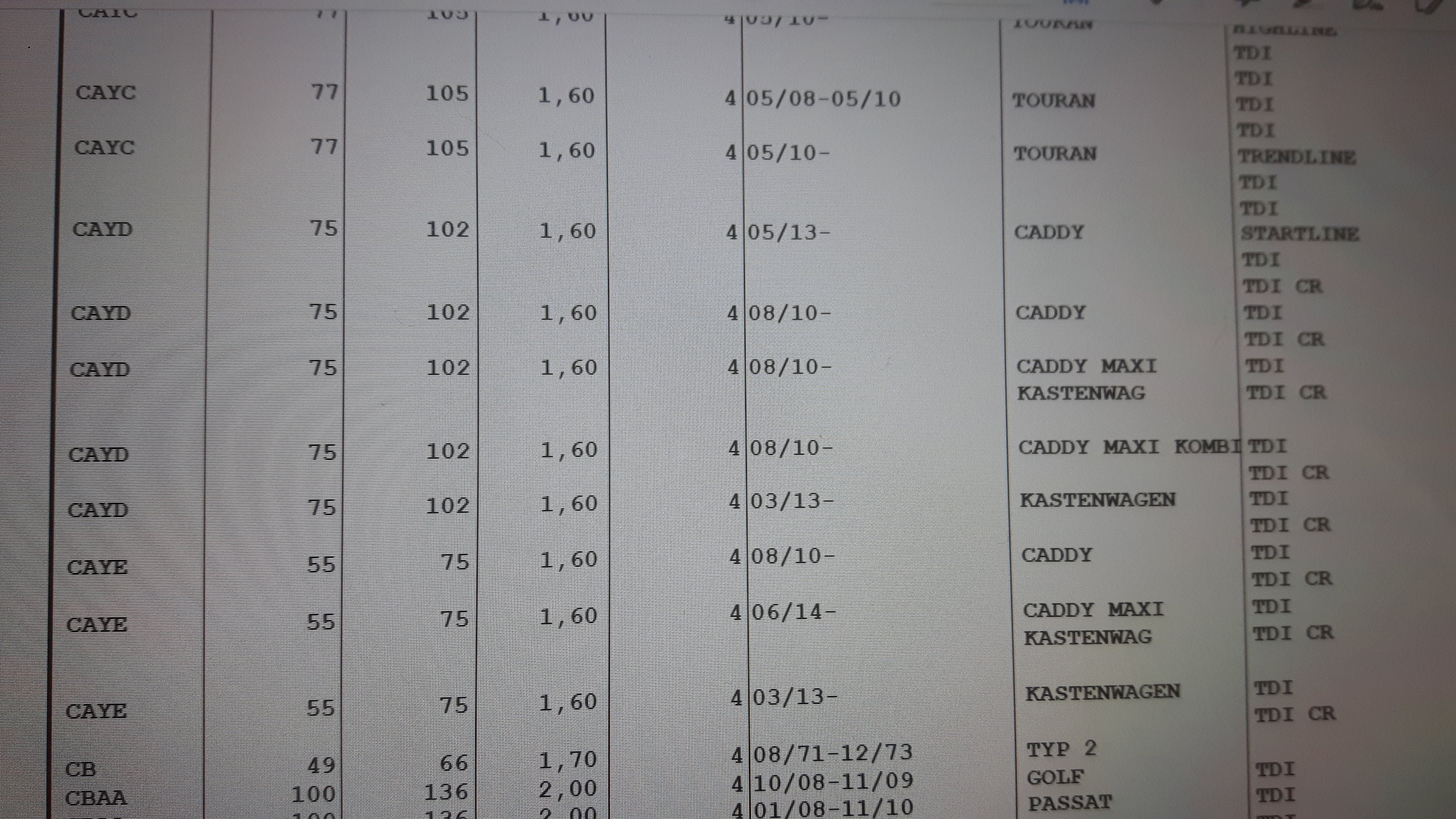

The listings I have show no usage in Skoda, Seat or Audi for CAYD.
In  VW Caddy, CAYD and CAYE are both found (first 2 columns are kW and bhp):
In  VW Caddy, CAYD and CAYE are both found:
