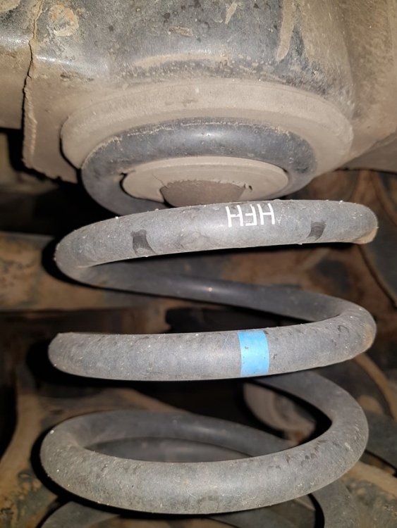

So I dont end up buy the wrong springs does anyone the OEM part number for these?
Atached a photo of what is fitted if that helps at all
Thanks Paul
Oh and spring looks fine
If the spring is fine why are you replacing both?
I'd check for a worn bush.
Remove both springs and compare lengths, inspect closely for cracks.
If they are identical refit swapping sides and reassess.

Hi thanks for that will do and I also think you probaly right about checking the bushes as well.
