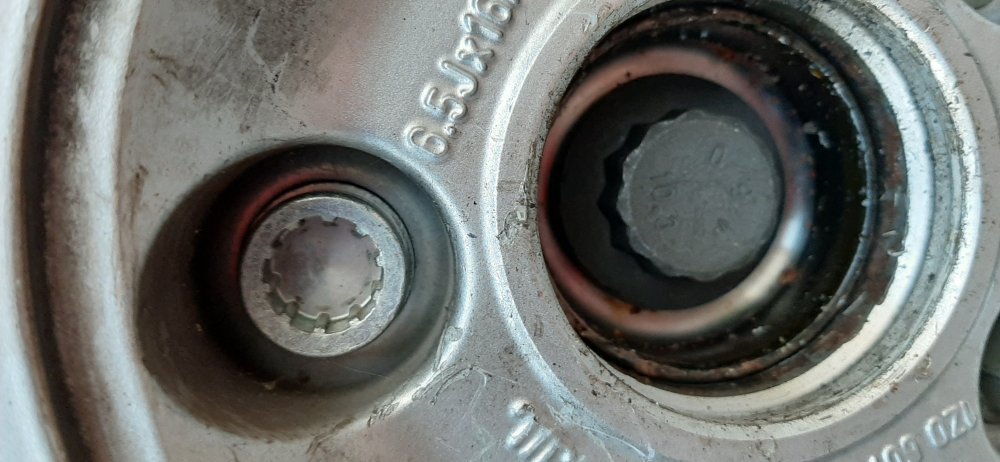

It seems as thought my  locking nut keys have got lost to one of the garages my car went to last year, and so I need a replacement. I took off one of the plastic central wheel hub covers to see the nuts and this is what was there, looks like a basic shape, 10 teeth, but can't find them online with this square tooth design. Can anyone signpost me to somewhere for a replacement for the locking nut key for these nuts?

you are a superstar thank you! Will order now! Does the other item in the pic need a key? can't figure out what its there for when there are five nuts on the wheel!
It looks like the hub centre bolt but I'll have to dig further to confirm that.
What model year is your car, and does it have original wheels or aftermarket ones?
It is 58 plate, mk 2, original 16 inch alloys. Just needed to know incase I need a key for that too!
The other one in the centre is the drive shaft bolt. This is a 12 sided socket if memory serves me well.

presumably the hub nut is not needed on the rears as those wheel aren't driven? I haven't had the centre caps off those yet to look. And is WHT002795 a 36mm? trying just to buy the one socket if I can!
"WHT 002 795 dodecagonal head bolt M16X1,5X70"
As far as I can see this is the same for all gearboxes - manual/auto/5 speed/6 speed - for a MY08 Octy.
If the hub nut follows the metric standards then for an M16 bolt you need a 24mm 12-sided socket - one of which is included in that kit I linked to.

WHT 000 229A M16x1.5x70 shouldered bolt.
jesus so a locking key and 12 sided socket for the rear, and then something else for the rears!
Erm, you dont need to remove the hub nut to remove a wheel unless you want it to fall off when you replace it!!!!!
forgive my ignorance! I am only a mild-car enthusiast! I know suck-squeeze bang blow haha but don't really do much on my own car!! So On either wheel i am only removing the wheel nuts and not the centre hub nut if I am changing wheels, and if there is any need to undo the hub nut then the garage will have the necessary 12 sided socket or star screw head for the rear?
In my defense I can't remember a 12 sided nut on the hubs for any previous wheels I have changed, prob just split pins or something so it threw me!!!
