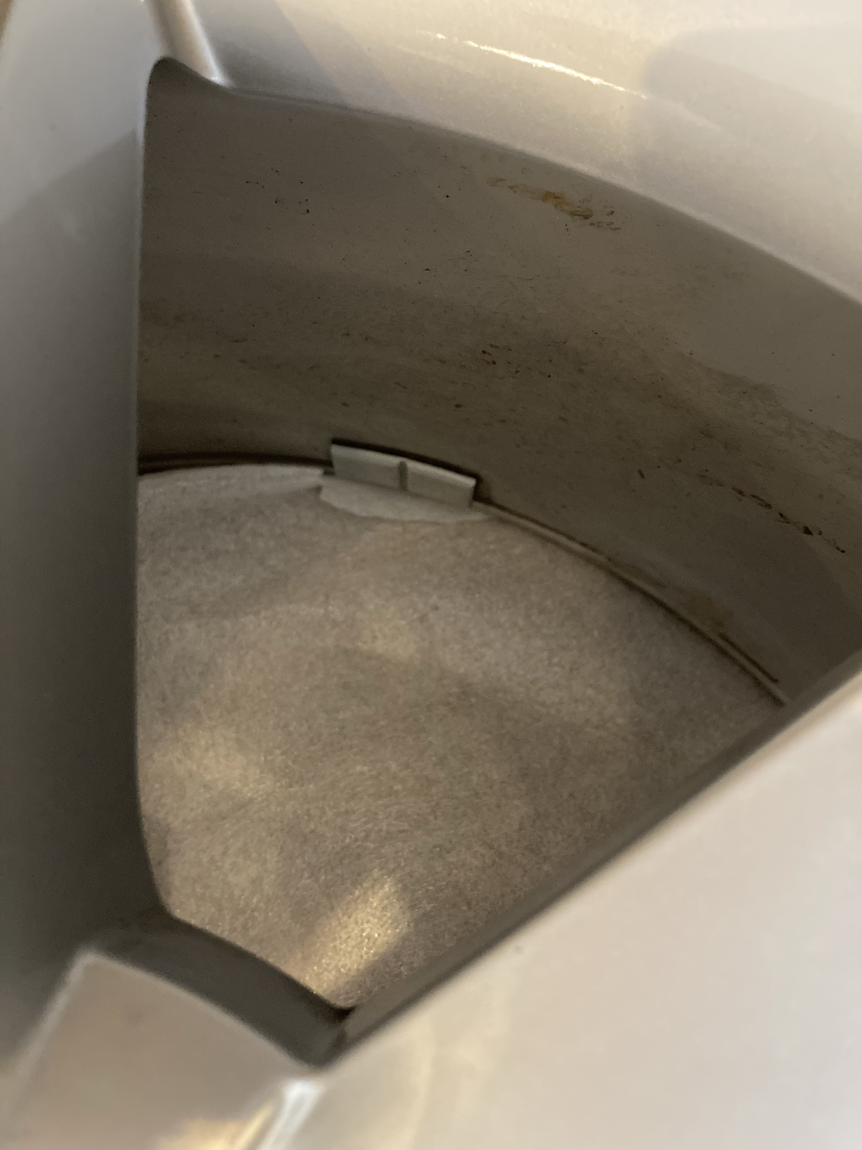

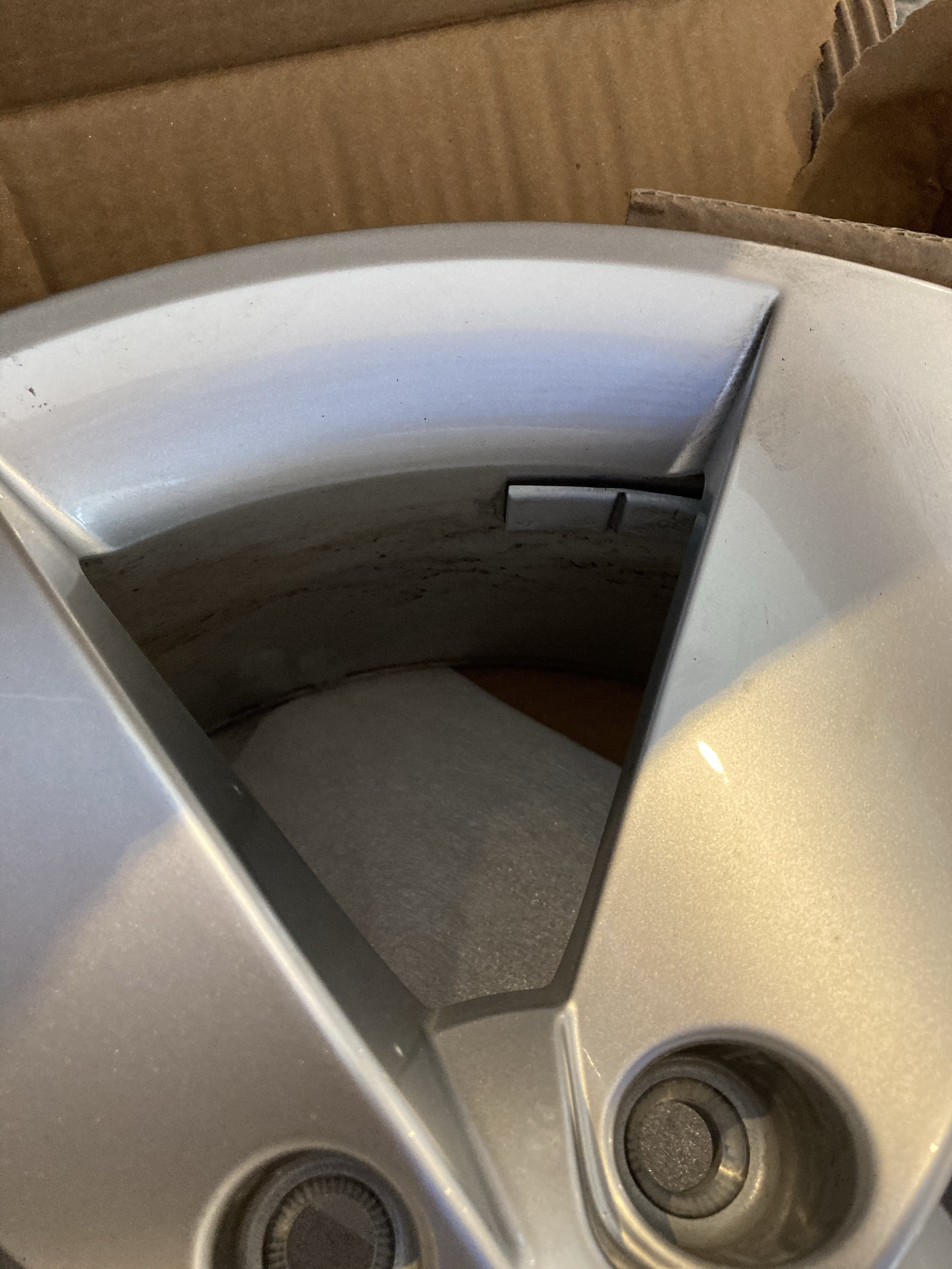

Was struggling to find a description, here’s what I merrily call internal.  These are the same rim, at about 90deg to each other.
This is the only position the alloys will accept these days, as the outside of the rim will not accept them and anyway would look awful if used there like they did with clip on weights to steel rims.
They just stick on and anyone with a balancing machine will use these now.
Any existing weights are removed when tyres are replaced before balancing anew.
