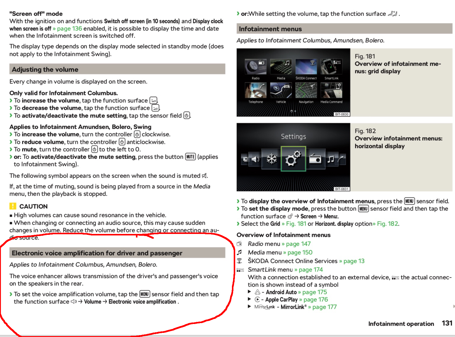

The menu to switch the voice enhancement on or off in mine has vanished . I am sure it was under sound, volume, sound enhancement. I turned it off a while back but wanted to use it and vanished any ideas
