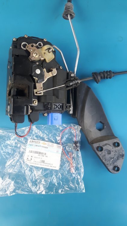

For today's attempt, I was expecting at least the door open microswitch would need replacing, but wasn't really sure that that alone could explain both symptoms. Not done enough testing at all to be sure that what I found does cover both, but optimistic for now. Here's the lock, fully removed as per @Tech1e's guide for window regulator replacement; plus a bag containing a genuine replacement microswitch.
I didn't fancy grafting that switch into the existing wiring, following a bad experience of having to revisit this work on my Polo after trying this shortcut. Two inline crimps are supplied with these microswitches to make such a technique easy. Soldering the wires directly to the pins of the connector on the topside of the circuit board was successful back then, on that one, at the second visit. Can't really remember why I didn't completely remove the old wiring from the board, possibly reluctance to do that final bit of disassembly to get at the reverse of the board, 'twas a few years ago, I forget.

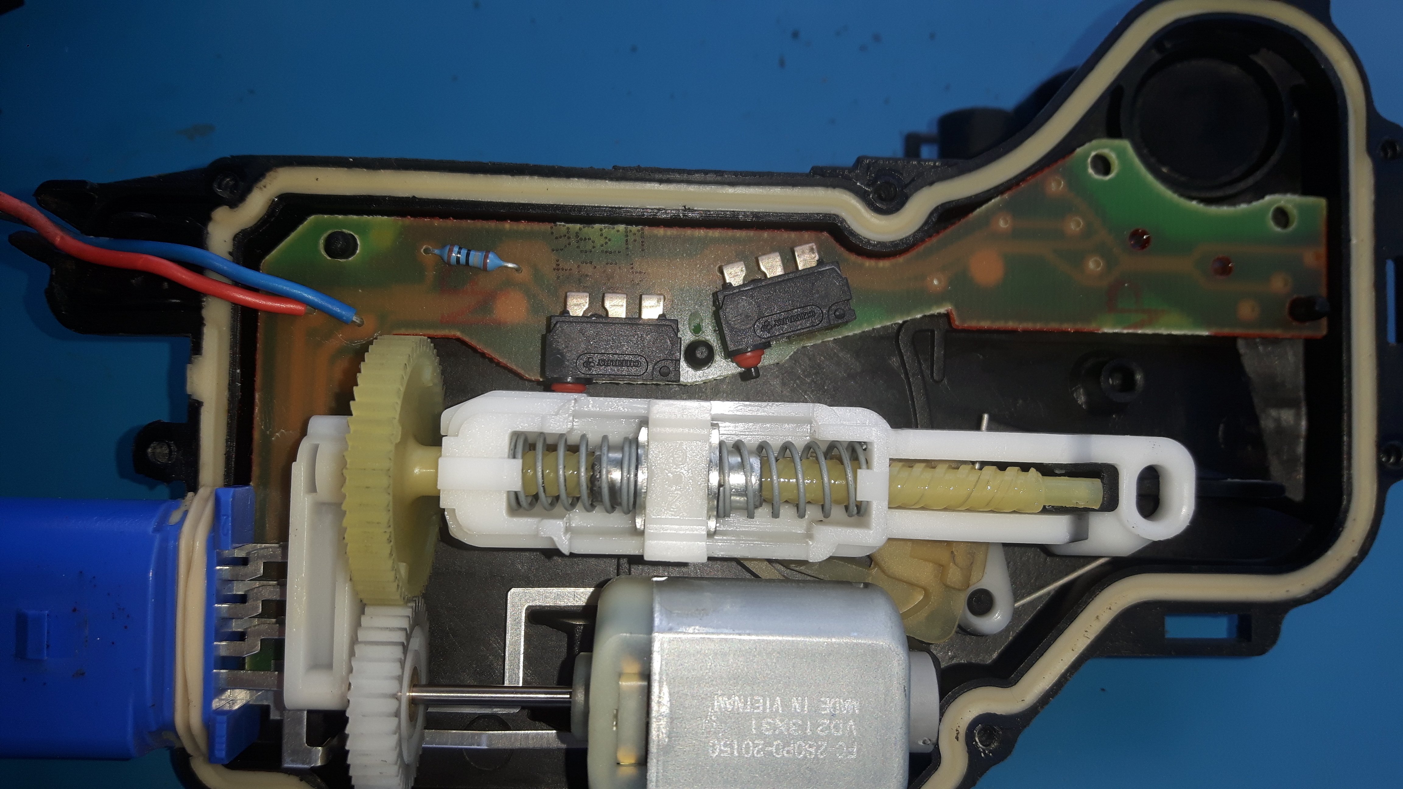

This is what the board looks like before complete removal.

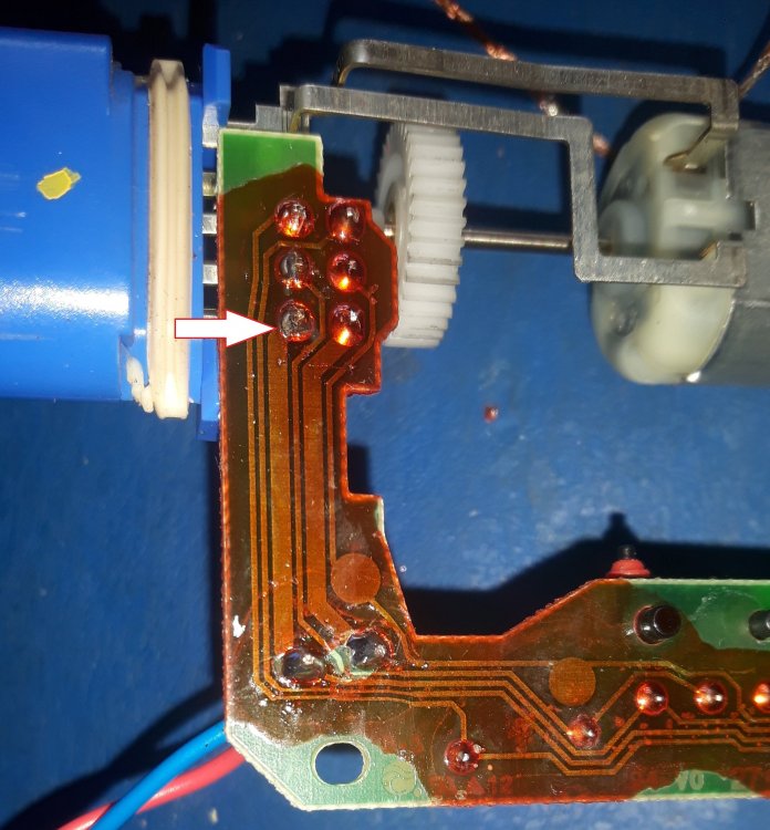

And this is the underside after removal, showing the connector connections and microswitch solder joints, all coated in a thick layer of brake-cleaner-resistant conformal coating of some type.
I couldn't really see much of the joints through this dark brown coating, but did think I was observing a little more movement than expected - when waggled gently - of the connector relative to the board.  Cleaned away by scalpel a few bits of the brown coating to get a better look, and one joint was particularly grim. It's the earth connection, which goes to the door open microswitch and some other places...
Here's a very brief video of it being waggled:
I swapped the new microswitch in as well, as it made no sense not to.

Interesting stuff. Looks like the repeated shock from the door slamming over the years might cause those solder joints to fail.
