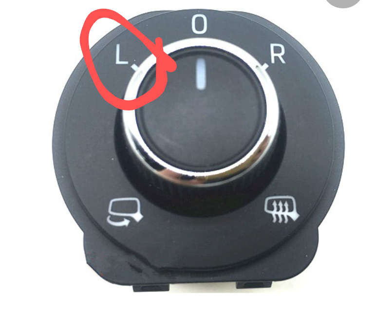

How do you get the settings to also save reversing position for wing mirrors?
All auto, you need to leave the switch on the adjust left mirror position. ;)
Switch on adjust left mirror? :sadsmile:
What is that please?
