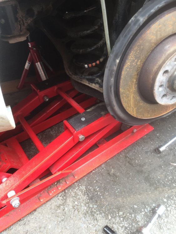

The easiest way to remove the springs is to undo the pinch bolt that attaches the wishbone to the hub carrier and drop the wishbone down: the spring falls out easily. Use a trolley jack to support the wishbone while you knock out the pinch bolt, it will give you control as it drops down (I used my motorbike jack, it stays level and gave good control to realign the bolt). Be careful doing the passenger side if you have xenon headlights as it's easy to pop the ride height sensor linkage apart. Pop off the sensor drop link before you let the wishbone down.
20190731_095314805_iOS.thumb.jpg.1cd1b4deda48af2fdf9f0a2635f8a6fa.jpg.e90f3dce41c631bbf8d5ad07ca0910cd.jpg

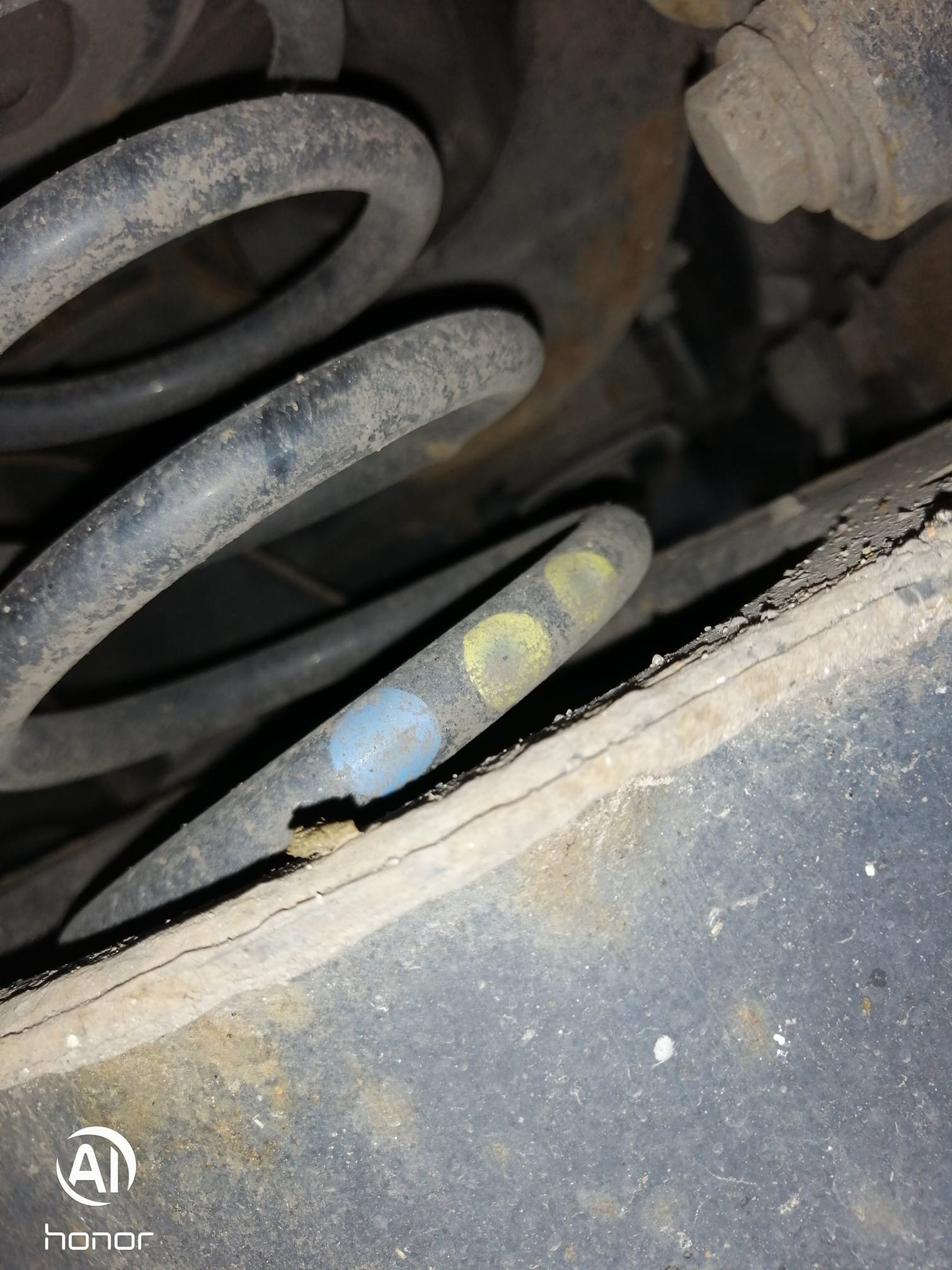

My coils have 3 dots.... 2 yellow 1 blue... Any ideas?

It is covered here:

I meant just using the table to look up the right part, it would seem that for your motor car it would be:
(1) 1K0511115BS coil spring
1 paint mark
2 paint marks
rear
blue
yellow
Model data: PR-0YC
Isn't that pretty helpful? I had not tried inputting a VIN; I thought the above was useful enough in itself.

Thats what parts haus told me, i might end up popping one out to measure its static height, mine have those dots so arent lowered springs

1K0511115BS is a lowered rear spring as it fitted to such cars as the Skoda Octavia MK2 Estate RS and the VW Golf MK6 Estate with sports suspension. You can find that information on the gknautomotive.com online catalogue:

That is interesting, so it would appear that the OP's 2015 Skoda Superb 1.6td estate already has lowered sports suspension. Can that be right? If it is then the OP's idea of pulling a spring out to measure its uncompressed height is a pretty good one to ensure he gets the right replacement part.

See below, Carlston implies you do have lowered springs, which would seem odd on your motor car. It might be worth taking a spring out (only take 20 minutes) to check as I'm guessing you want to have the standard ride height?

The green line uses sports suspension.
Really? That would solve the mystery. Good information.
