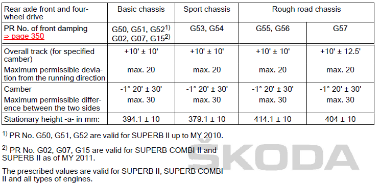

34 minutes ago, chimaera said:
I've posted the ride height table several times across these threads if you have a poke around. If you're more than 10 mm off it's time for new parts.
... many thanks, I'll have a look for the table and check my car against it.
Alan
Addendum: I assume this is the table:
rear_suspension_settings.png.6d16ac31df7838fc5d7a1a8ac40d174b.png.2bbe1e09d95584ac1b131c7f901b2fdd.png
I think the first column would apply to my motor car (2013 Superb Elegance estate diesel), so the ride height should be 394.1 +/- 10 mm. I am guessing this is from the centre of the wheel hub to the top of the wheel arch when the car is unladen?
I have just measured my car and get 392mm both sides, which if I have measured the correct dimension seems fine. I used an ordinary steel tape, which I reckon I could read to +/- 2mm (I'm a surveyor by profession, so that is realistic). Is that measurement of the correct dimension, and is it precise enough (I suppose I could set up a laser level on a tripod if there was a requirement)?
