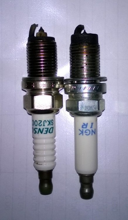

On the topic of spark plugs have always asked for them to be numbered when taking out at service and to see them in my hands.
Wow.
11 hours ago, sepulchrave said:
Wow.
Like many I had oil problem (in past), this what happens to spark plug, luckily engine not turned into toast. Always seemed to be cylinder 3...so after that started to number them, These VRS MK2 some are 10 years old now, for anyone new to owning 2nd / 3rd hand, it's still worth getting them checked at least every service, even if low miles
