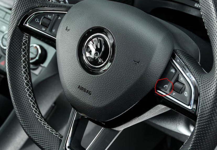

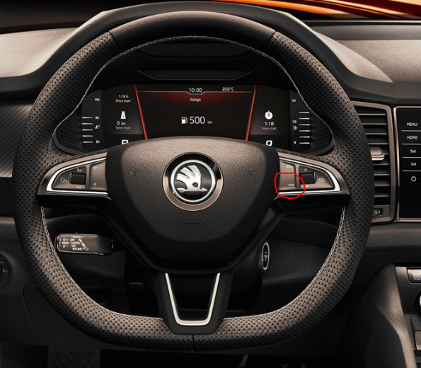

The telephone button has simply been replaced with the 'VIEW' button?
Press VIEW and use the scroll wheel to select Telephone.
From this...
...to this...
Thanks everyone for the responses. I’ll hit the “View” and see if it works.
The VIEW button changes the look of the VC, not the actual information displayed. @morganic needs to press the 'back' button that's next to the right scroll wheel on the steering wheel, then use the scroll wheel to select Telephone.
