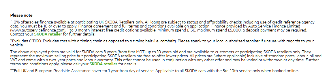

Okay to clarify as @e-Roottootis confused: taken from the Skoda Servicing website https://www.skoda.co.uk/owners/servicing-maintenance-fixed-price:
The above displayed prices are valid for ŠKODA cars 3 years (from first MOT) up to 10 years old and are available to customers at participating ŠKODA retailers only. They represent the maximum selling price but participating ŠKODA retailers are free to offer lower prices. All prices are (where applicable) inclusive of standard parts, labour, oil and VAT and come with a two-year parts and labour warranty. This offer cannot be used in conjunction with any other offer and may be varied or withdrawn at any time. Further terms and conditions apply, please ask your SKODA retailer for details.
Therefore if your car is under 3 years old, you will be charged the unsubsidised rate (usually double the price) for work.

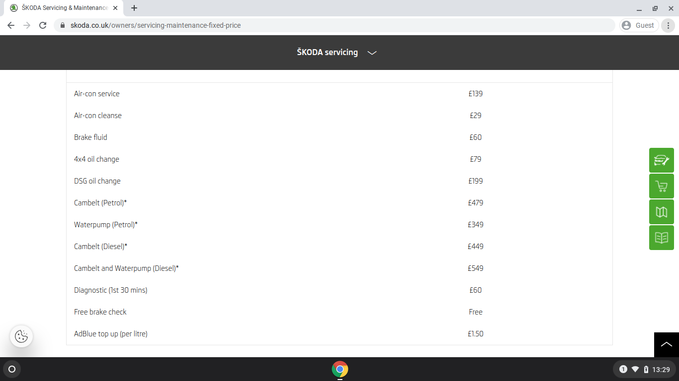

@varaderoguy
So what is the 'un-subsidised' price to do a DSG oil change on a 40,000 mile DSG under 3 years old?
The Fixed Price Service & Maintenance Menu no longer says anything about cars 3-10 years old.
@e-Roottootit certainly does - try scrolling to the bottom of the page showing the Fixed Priced Serving costs.
@varaderoguy Thanks, i see the T&C's now are still there.
