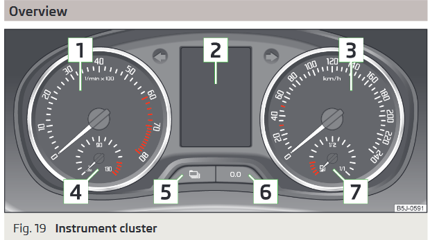

Probably the lack of that gauge is true only on some lower end Fabia 2 cars.

My mate's Mk2 Fabia without the gauge is a 1.6 Sport.
According to the handbook some do have a gauge (item 4) but I don't know which versions.
Edited by TMB
My 1.2 htp elegance has a temp gauge and no blue warning light.
My 2009  1.4 Greenline has the blue light, which goes off once warm, red if overheated or red with three beeps, if low on coolant. This is normal on many modern, non-performance vehicles, where too many lights/dials give the driver sensory overload. This model would not be considered low spec but was the supposedly eco-version of the MK2 variant.
