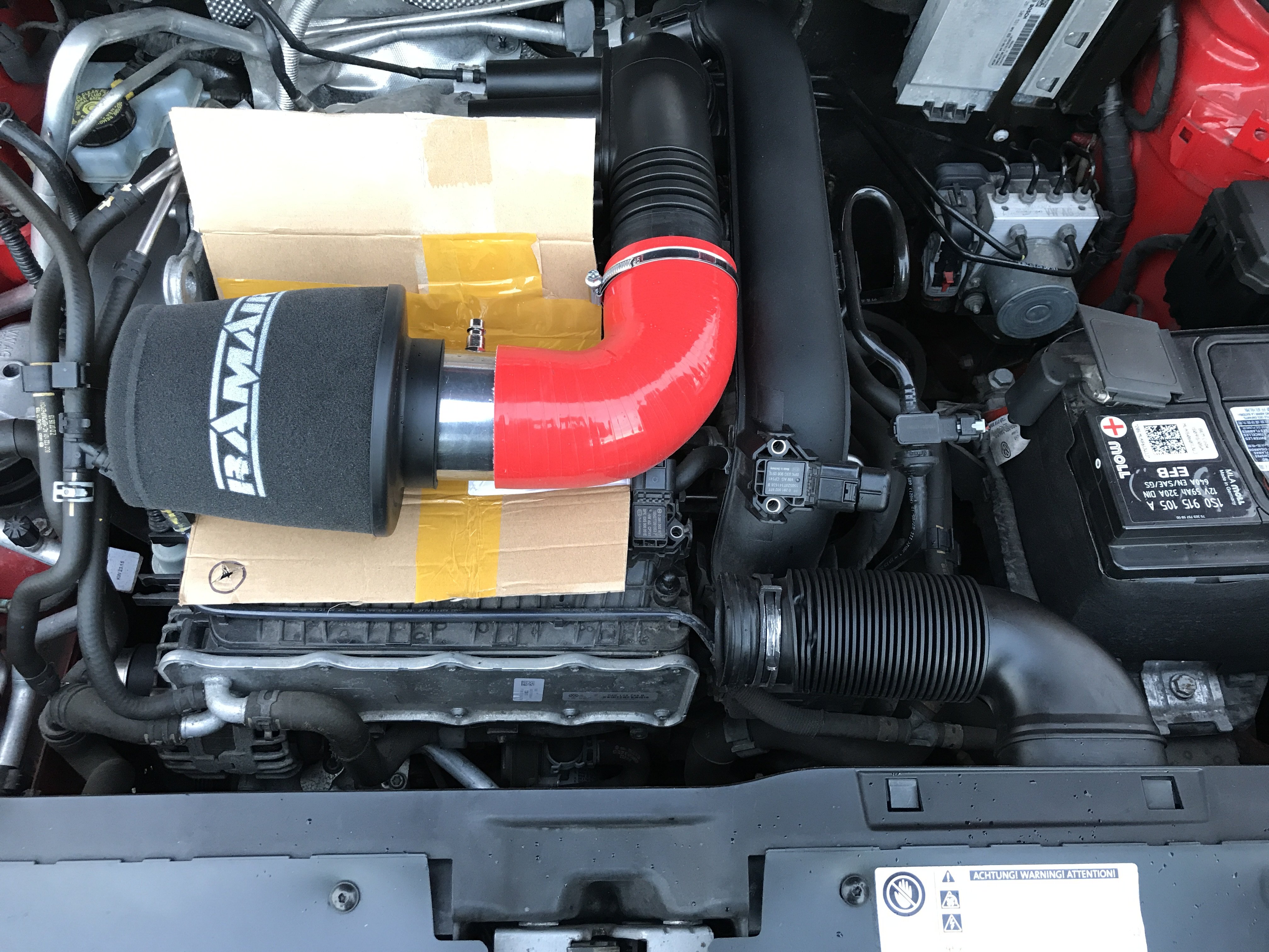

I want one now too ahaha, currently in the process of making the heat shield for the cone filter. Maybe a 90° welded to a flange would work.
You got a forge one?
Nah its a RamAir one, it sits like the MST one so its taking it a lot of heat from the engine.
3 hours ago, Aviii said:
Nice to see some CAD (Cardboard aided design) in use.  I'd recommend having the custom heat shield mount onto all three airbox mounting points to stop it from wobbling about, the mst intake has an arm that reaches out to the mounting point on the right. of the intake manifold.
ahaha, yea I'm going to rob the rubber thingys from the old airbox, so it sits nice.
