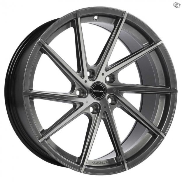

I have my sight set in these Ocean OC-01 in size 8.5x20 5x112 ET45 72,6
Or if possible in: 9.0x21 5x112 ET45 72,6
