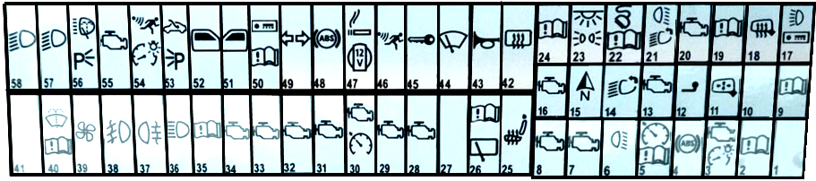

The main fuse I had checked yesterday was number 23 as per the image below for the interior lights.  I checked a few of others (bottom row 1-8), and I switched the wind screen wiper one (15) with 23 and the windscreen wipers worked fine, so it was not the light switch fuse.  And yes, when I had removed it the wind screen wipers stopped, so it was the correct fuse as a test. I have not checked the rest of them , which I will do today and update, hopefully its one of these.  I was kicking myself for using a screw driver yesterday, the LED's did look good when it does work.  But now all of them don't work :(

I just realised, yesterday I was taking out all the fuses to test them.  Although I have a multi-meter, and can use the below to check the fuses without having to take all of them out.  So hopefully that should save some time.

5ab16afc7fff3_fusebox2.png.b2c3076400f373243e3ffc606c1b9d2f.png5ab16b0891055_FusePanelCorrectionRHD.png.f81d78dfcb6babf8d632ecb74426f444.png
You can print the above for MK2 and laminate one of them I corrected it to RHD, as the one inside is printed for LHD, you made same mistake as me only mine was the the one in boot and a trip to Halfords in the dark for replacement fuses....
Fantastic idea, Thanks.  It is a bit of a fiddle trying to look this up on a mobile, this really helps.  I ordered some spare fuses as well to keep in the car, as you never know when you need them.
