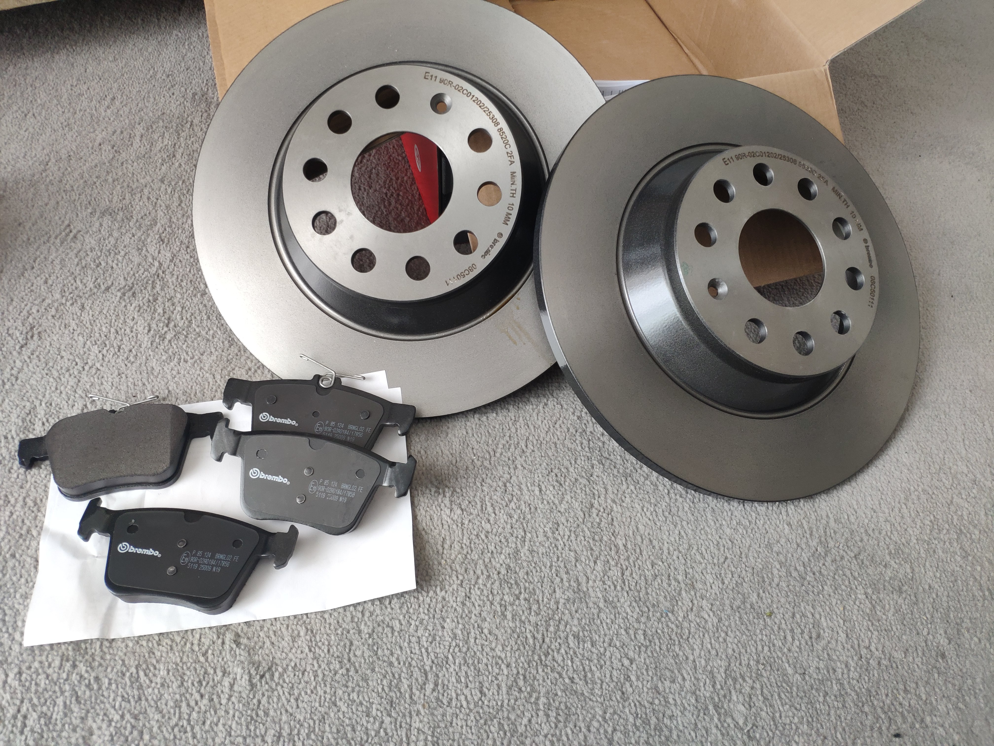

ive been quoted £200 for rears, and £240 for fronts, if I compare with cheap products then I can do it for less, but if I compare with decent products (brembo, Ferodo, mintex) then it might not be worth me tooling up and getting hands dirty 🤔🤔🤔🤔🤔🤯
I changed the brake pads and discs myself.  I bought in promotion at eurocarparts.  I chose the brembo kit.  It took me maybe an hour.  I'm talking about the brake discs on the rear of the car.

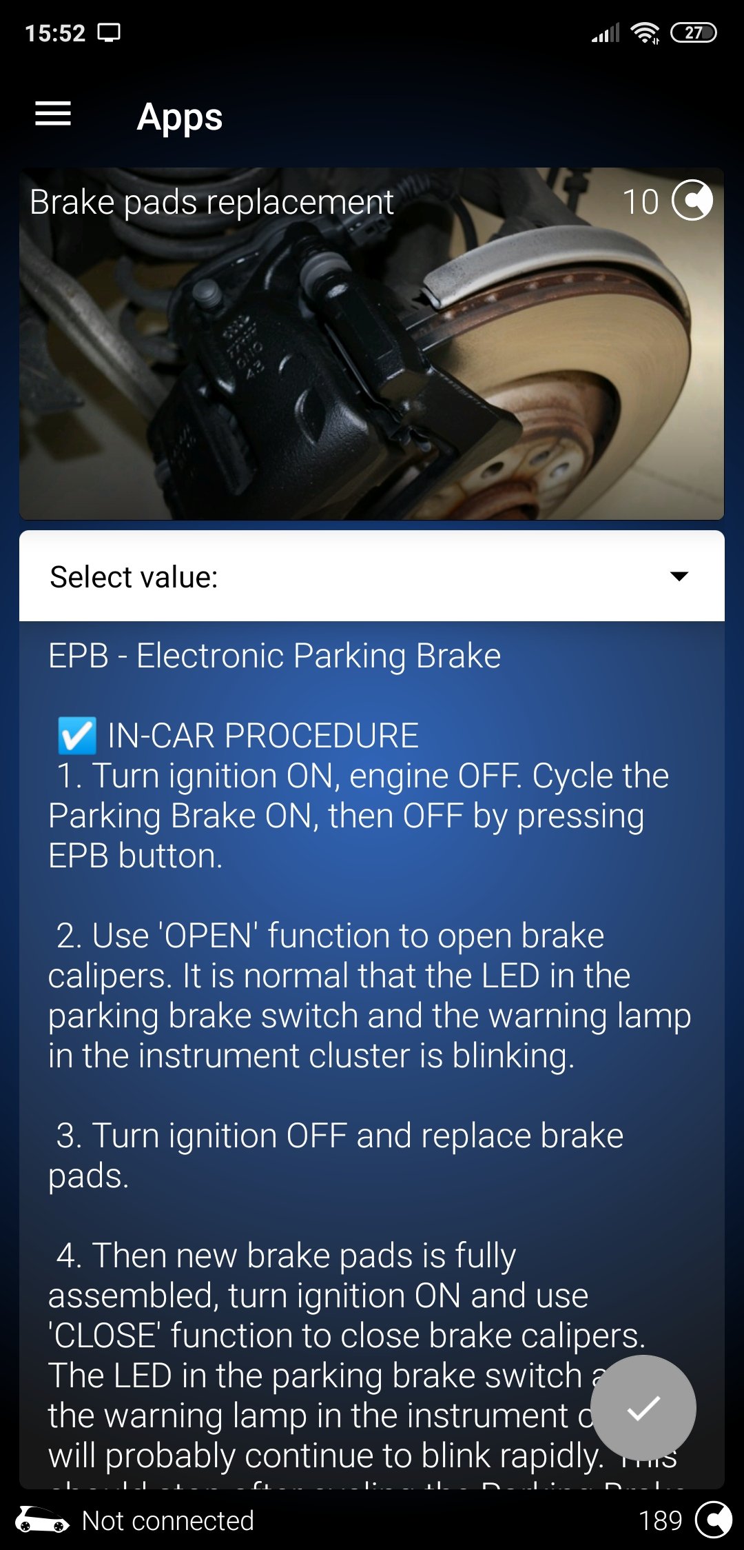

what did you use to deal with the Electronic Parking Brake and how much did you get the brembo kit for (if you don’t mind me asking so I have something to aim for) ?
I used OBD eleven and the phone for the electronic brake.  I paid about £ 100 for the brake discs and pads, it was 50% off.
