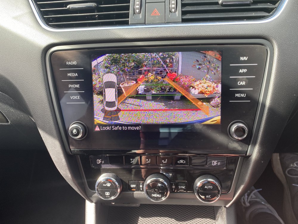

You might want to take a look at the thread in the Octavia section as both styles are shown:
Thanks for that. Aren't those just static lines? What about where the guide lines change with the steering wheel?
Which one?
The one Weyland fitted is certainly described as "dynamic trajectory" and aliexpess link states "It will read the command from CANBUS system of Car Computer and control the camera on/off and parking line moving". I expect their steering wheel was straight when they took the picture, if you ask I'm sure they can add some more pictures showing the fully functionally ;)

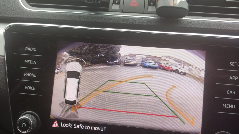

The OEM one I fitted definitely shows dynamic/moving guide lines, it can do all four modes mentioned in the owners manual:
- traverse parking
- parallel parking
- driving up to a trailer / distance monitoring
- monitor the area behind the vehicle (wide view)
Quick picture showing the lines having moved:

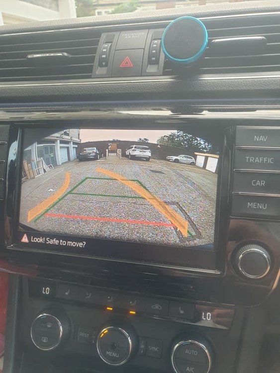

The AliExpress ones linked do have dynamic lines. One I fitted to a Octy here and I’ve done 2x Superb’s.

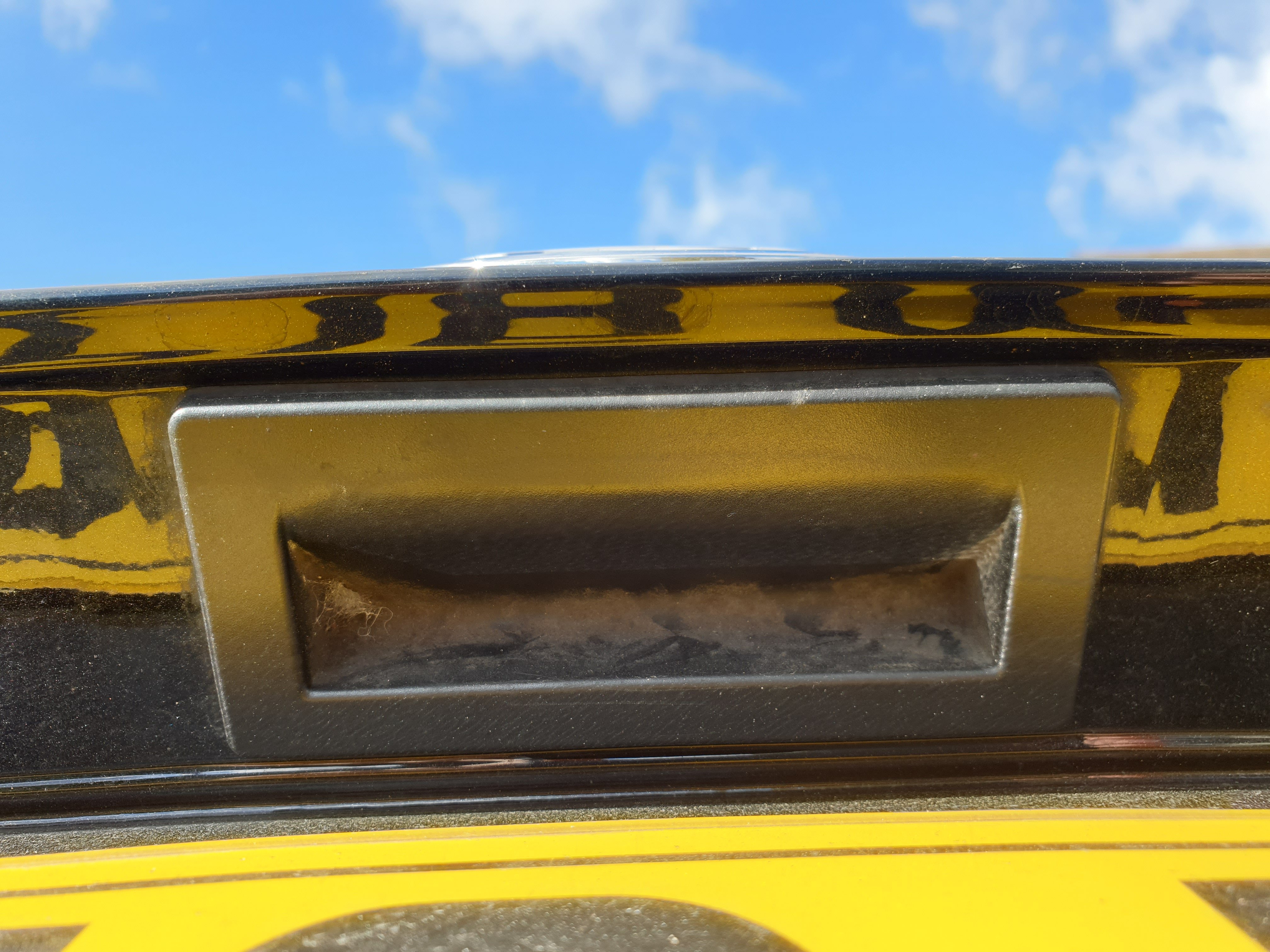

Check your boot handle size before you order, if it’s got a rounded edge like this car had thats handle B, if not and it’s a rectangle, handle A.

Just checked and it looks like the image attached, so I guess I,lol have to get the A type. Just the Chinese descriptions are a little misleading, it says superb 17-19.

No. Only OEM has those views. You need MQB handle A.

Thanks for confirmation works on my model. Ordered, took 10days to ship and now fitted and working. Thanks to all contributors to this thread and forum as a whole👍
