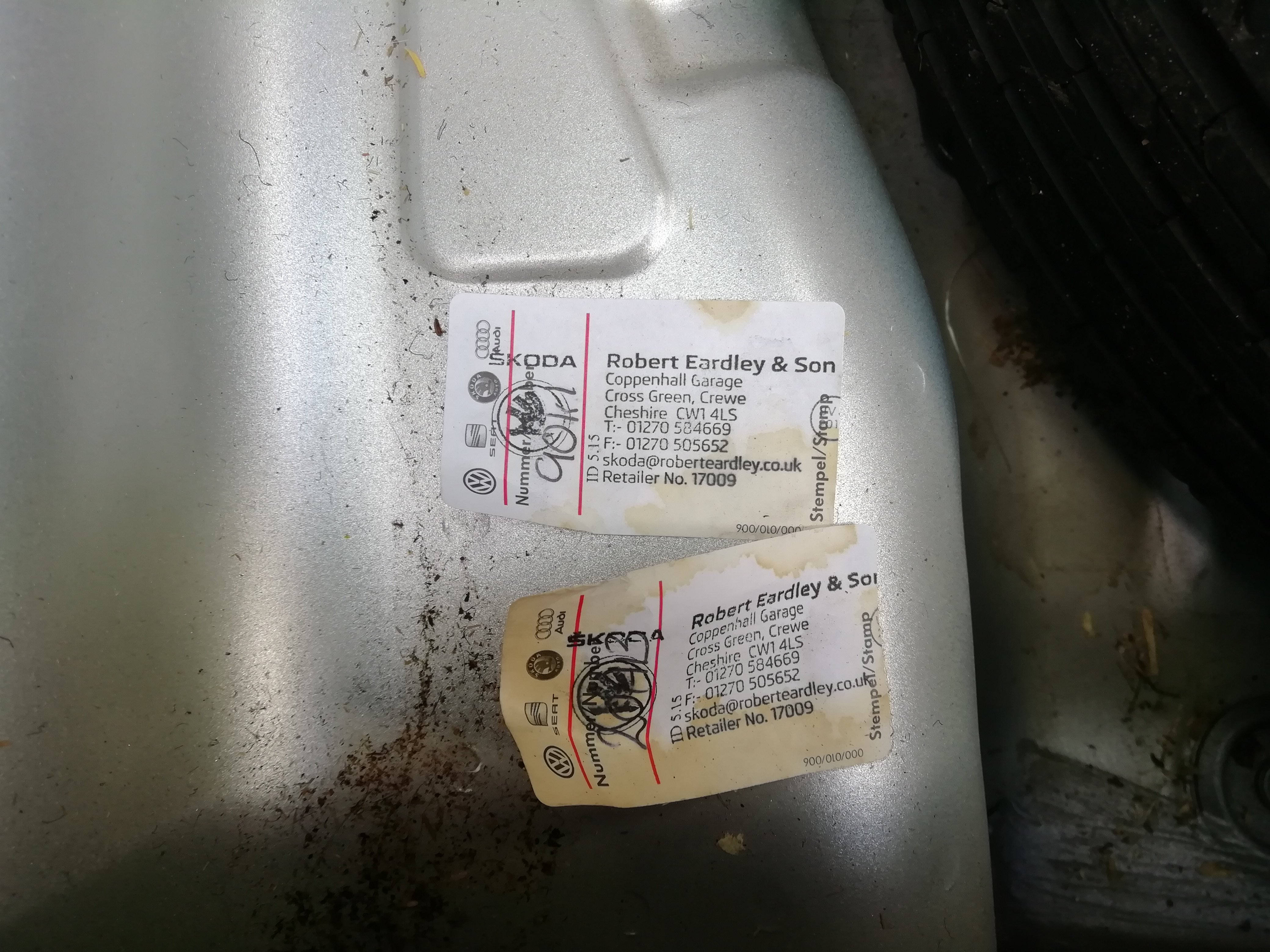

Check it has NOT had the emissions fix. If there an extra sticker near the wheel well in the boot then it likely has.
Something like these?
