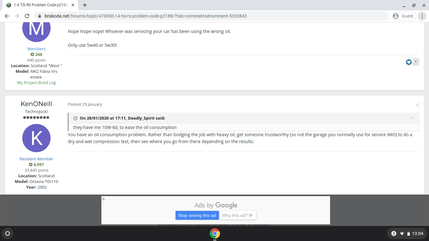

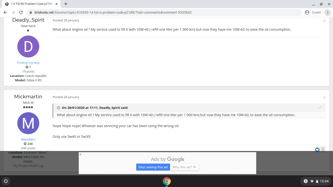

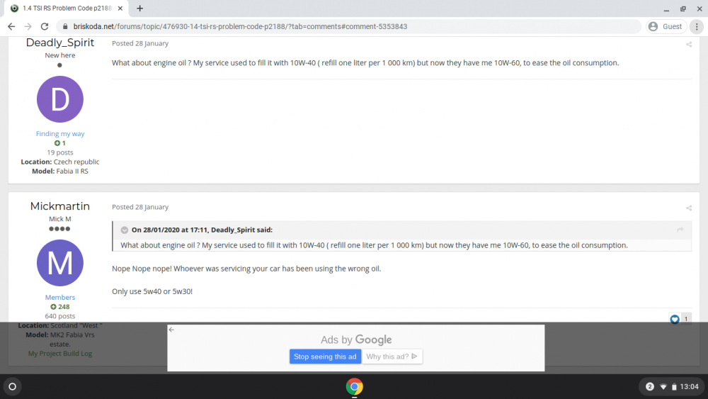

in one service they changed it to 10w-60 for some reason and cold starts are bad with this oil.

Is that a Typo, or Were they trying to hide oil use?
http://briskoda.net/forums/topic/476930-14-tsi-rs-problem-code-p2188

Yep, tried to hide oil consumption
Well that is an issue that needs addressing then.
You dealt with proper cowboys.

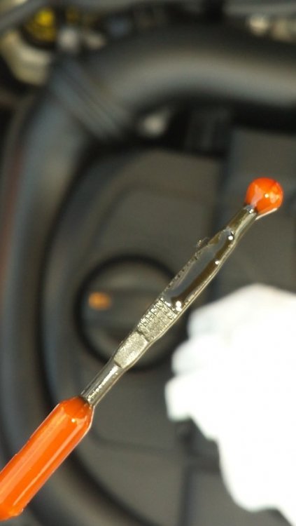

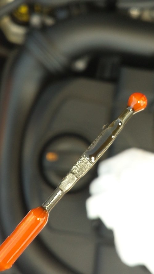

I changed the oil yesterday to Castrol Magnatec 5W-30 A3B4 and the car is less noisy ( cold starts do not sound like baby TDI) and i can say it is better. one thing i do not undestand, is the oil capacity is 3,6 L and i was able to put whole 4L canister and the oil meter sais there is half of the meter :D
One more thing about the oil consumption, is there any tutorial how to do it with the jets sealant etc ? I get my car fixed and looked after with my good friend who knows about cars so we could do it one day.

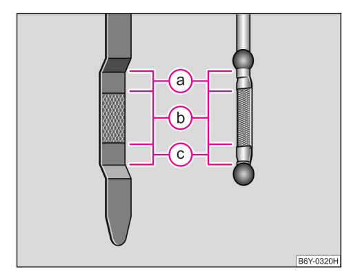

Technicians and mechanics that were filling CAVE / CTHE engines to the correct level on the dipstick when the engines are at Normal Operating Temperature filled and do fill with 3.9 or 4 litres of oil.
That gives the correct reading. Area A of the cross hatch which includes the flat bit above.
& that is on the flat above the cross hatch and below the orange blob when checked cold.

Unless the red oil light was on or virtually empty / drained from sump, then you could have overfilled
@Kobayashi
Next time you change your oil and if the reading is showing in Area A on your dipstick just measure how much oil you remove.
Suck it and then drain with the sump plug out or just drain.
If it is 3.9 or 4 litres oil in is not overfilled.  The 4.2 that some Dealerships techs put in certainly is.
