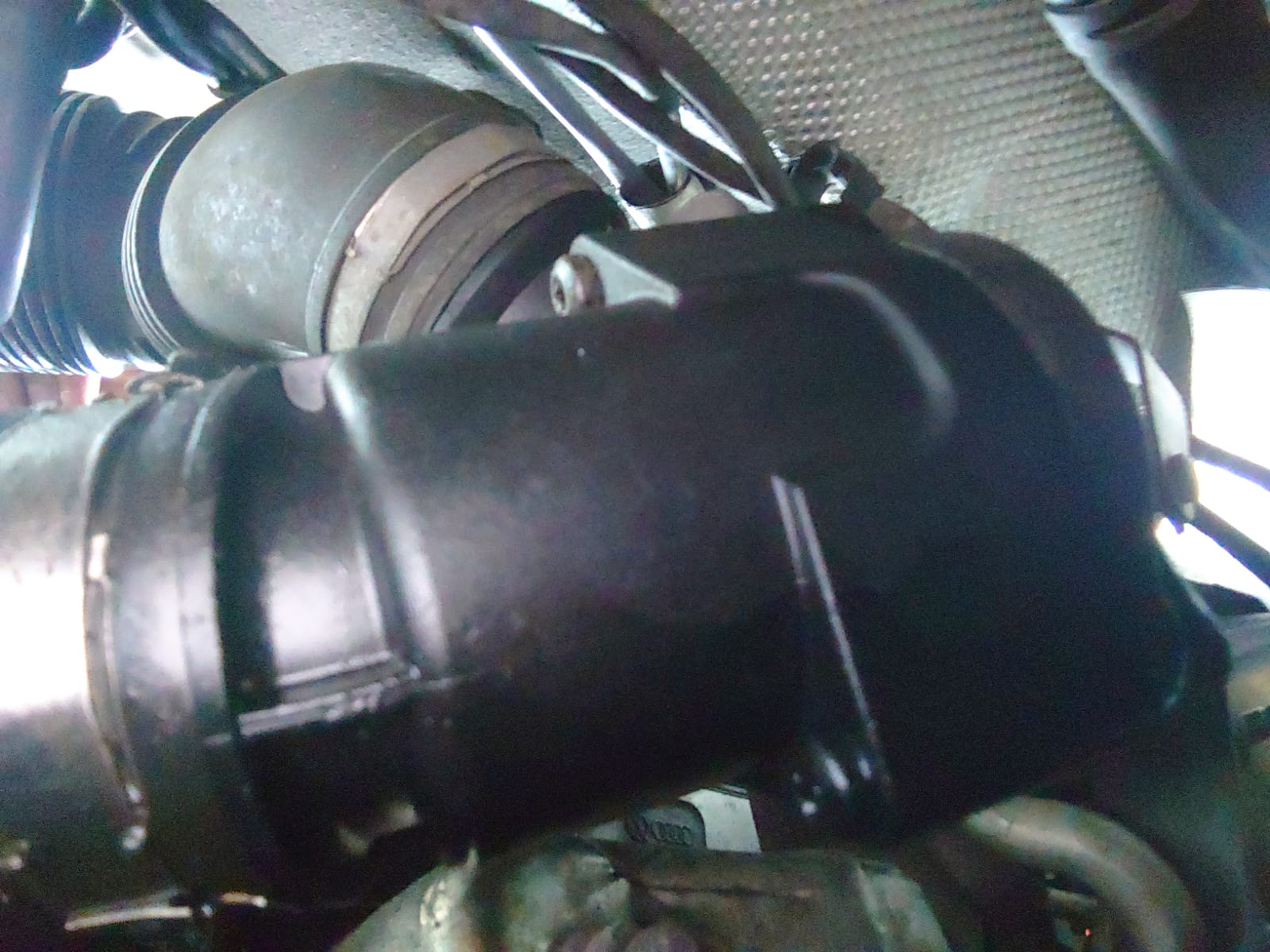

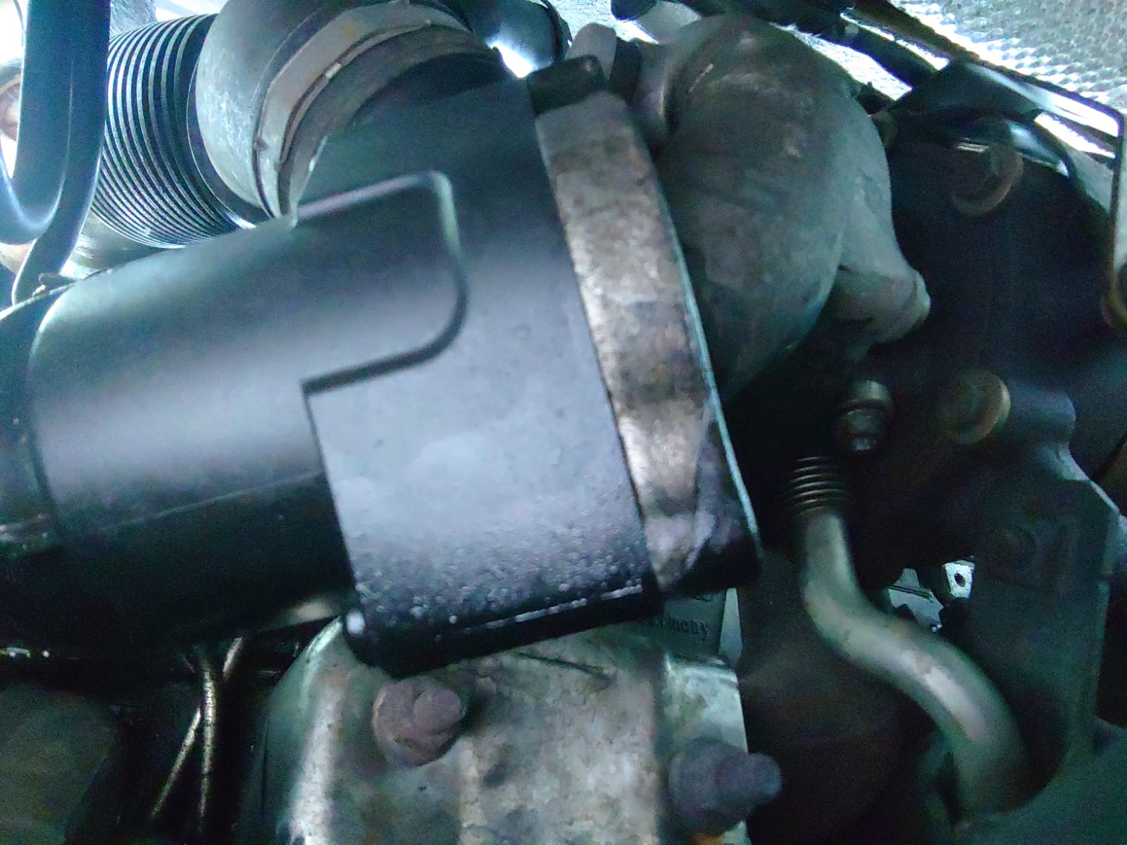

Hi I have the same issue with my Octy VRS LE. I have a suspected boost leak in my intercooler pipe and breather/pcv. I also had some oil from both turbo pipe connections but no cracks so just tightnend them with new o rings.
Also only happens when accelerating not when idle  Ive attached pics of where the oil was coming from but defo need a new intercooler and pipes

Hi matey just an update I think I may have cured the whining problem albeit a temporary fix. It was the o rings on both turbo pipes had gone as in the photo above and were spewing out lots of oil. Had to give them a good clean and re-tightened the bolts and pipework including jubilee clips. Went for a drive and funny enough the sound had disappeared altogether throughout the rev range.
Also before I did this the noise was happening during idle which it didn't do before so gonna replace the o rings and maybe get silicone pipes.
