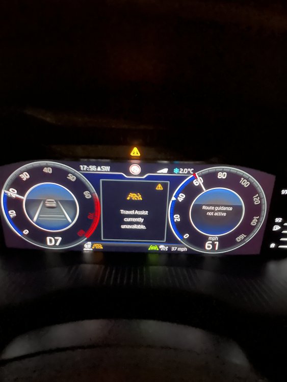

So since accepting the car back, the travel assist fault has appeared a couple of times.
I have had the travel assist unavailable alert with the amber triangle and amber travel assist symbol.
It has always cleared itself after a short time and has not stayed in for a while journey so far.

That's exactly what mine does - I would say I get that fault twice a week... My replacement steering wheel is in and due to be replaced end of Jan. I doubt the steering wheel is the issue, anyway I'll get it replaced and see what happens...
Does your fault stay on or disappear during the journey.
The annoying thing is the fact it is so intermittent.
No disappears after a few minutes. What is more frustrating is the systems’ incorrect reading of signs (sometimes in metric) and I’ve had a few times the car anchor on at 80 mph (on the motorway) when it thinks the limit has dropped to 40. I think it believes I’m driving on a parallel road.
All that said it makes motorway driving so much easier - I love it (and so does my son!). I did a 500 mile round trip to Kent yesterday (funeral) and it’s so much less tiring...
