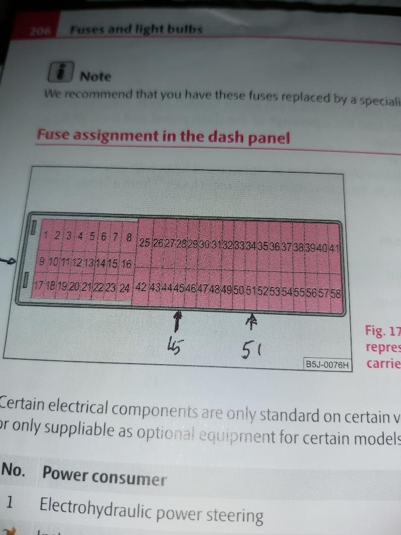

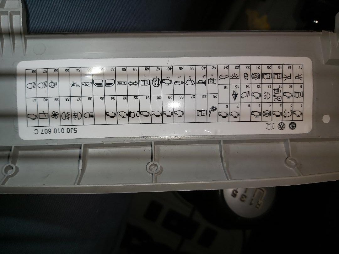

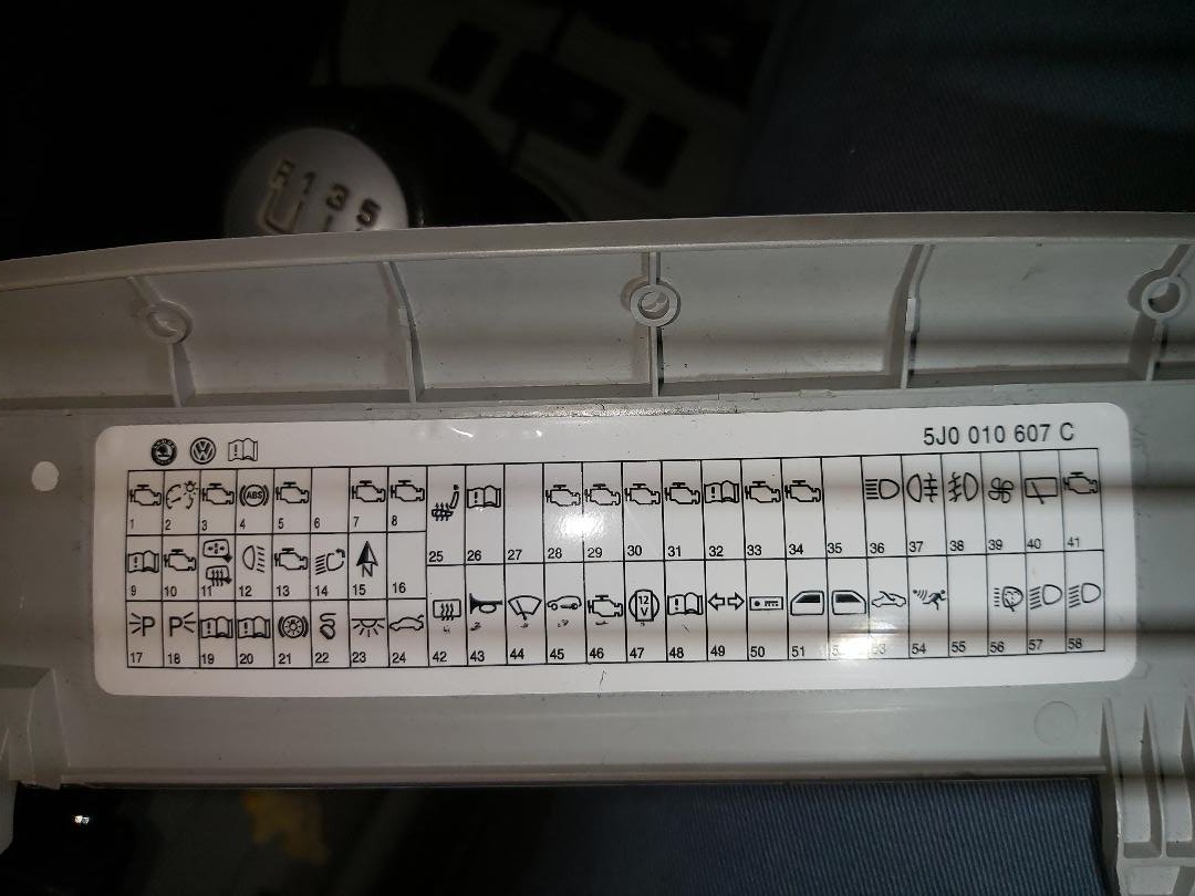

Hi Pete,
There's a strange anomaly with my car, the fuse box, the owners manual and the fuse box cover. It's no wonder I couldn't make sense of the fuses. The actual fuse locations are as per the diagram on the fusebox cover turned through 180degrees ,inverted. Mini fuses are actually on the right hand side, not as shown in the owners manual and on the fusebox cover. It was only by using a strong light and magnifying glass that I could read the numbers of the fuses.  Fuse removed from 26, continuity checked even though it looked intact and replaced. It had a 20A fuse in that location and has been replaced with a 15A. Everything is working as it should now. Thanks Pete, it seems as though if any other owner has a similar problem, the 1st check should be this fuse. It powers the selector switches on the stalk. VCDS was a useful tool to diagnose the BCM and test the wiper motor. Wiring diagrams printed out = 5 and various scenarios to determine what does what. But something as stupid as presenting the fuse locations the wrong way round, upside down and poorly numbered is inexcusable from the manufacturer.

It's a LHD/RHD thing, manuals, stickers etc lazily not tailored to the specific market the car was built for.
As above - exactly the same for VW Polos!
I spent 44 years as an aircraft engineer and fully used to diagnostic procedures. Wiring diagrams provided should be able to be read, work and help in the diagnostic process. are essential. That a fuse location chart diagram is misleading is inexcusable esp when you have to check a particular fuse to start the process of finding out where the fault lies. I did a con check on the fuses in situ and didn't find any faults. Similarly  VCSD scan showing everything in order. Because the horn fuse was tested and not 26, a fault didn't show up. That was going by the fuse location charts on the cover and the OM. It was only by chance that I decided to check I had the right fuse, using a strong light and magnifying glass did the error show up. A lot of time had been wasted. Still the good news is it's fixed, Lesson learnt about the fuse locations being wrong  and best of all the price of a fuse being the only cost! Thanks for pushing me back to recheck fuse 26.
