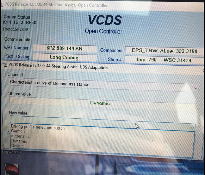

I tried making the change in module 44 but when putting it to the 'dynamic' option, clicked update > dash steering blinked a few times > this results in an error not allowing me to make the change:

Higher tyre pressure will lighten the steering feel,  so drop tyre pressures to "comfort" settings - either in the manual or on the door plate.
Mind you, I reckon they got the steering weighting bang-on for a city car, so maybe something has gone wrong with the setup on your car?
