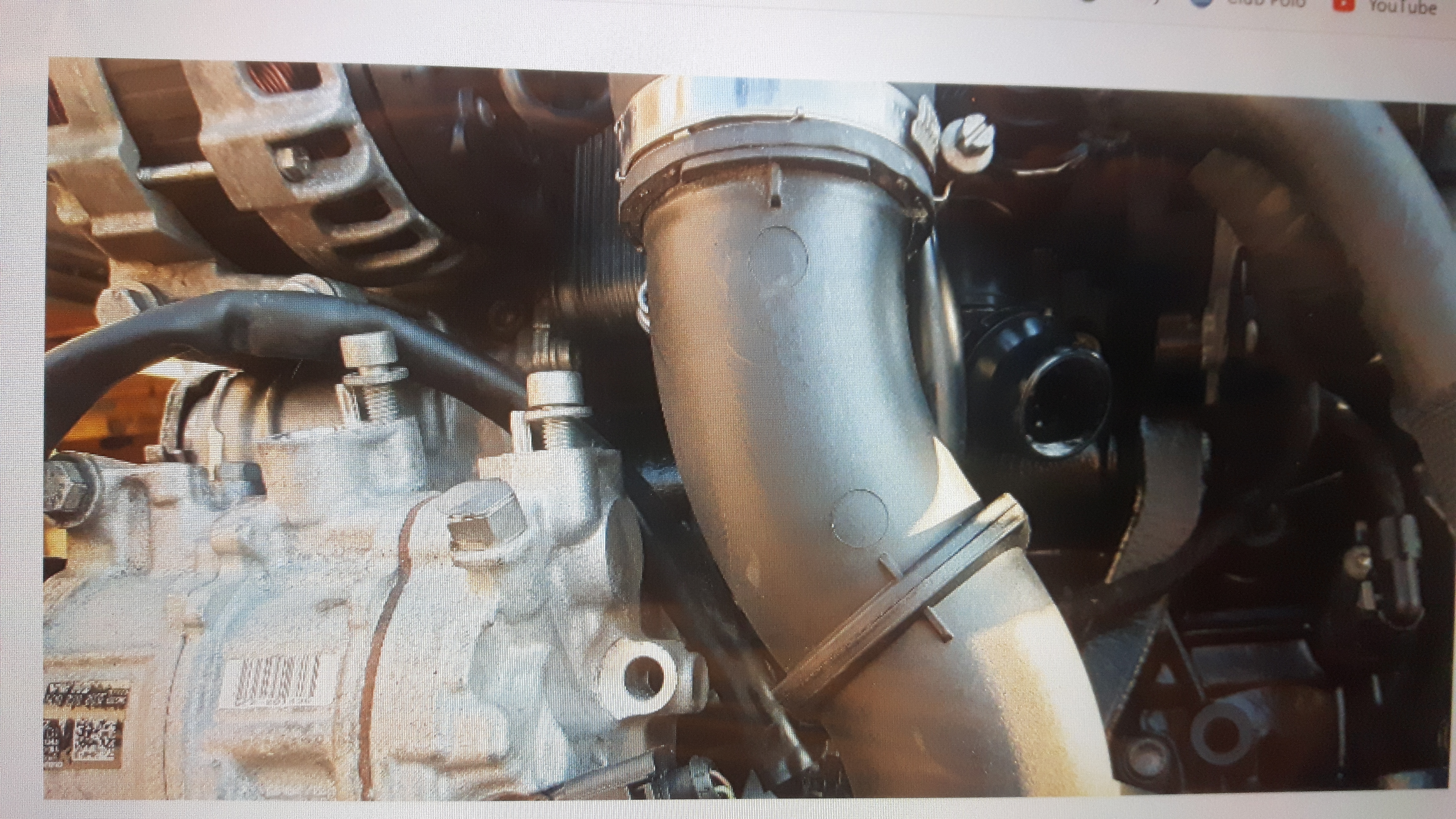

Try looking at this photo, from an ebay ad. Top left is the alternator. Just to the right of that I can see the oil cooler, item 19 from the diagram linked in my first post, so the thermostat housing is just a bit further to the right of that.  Access looks likely to be difficult, but possibly easier from below.
Thank you again Wino,you have put a lot of time into helping me.
Suprised but I will instead have a look from underneath, plus using your photo as reference ,hopefully tomorrow when I give her an oil change.
