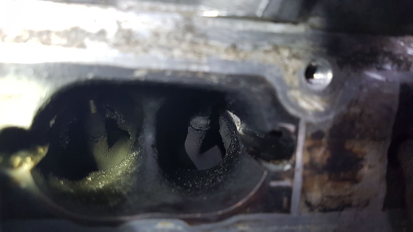

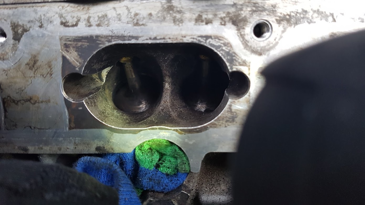

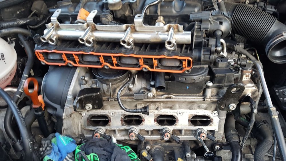

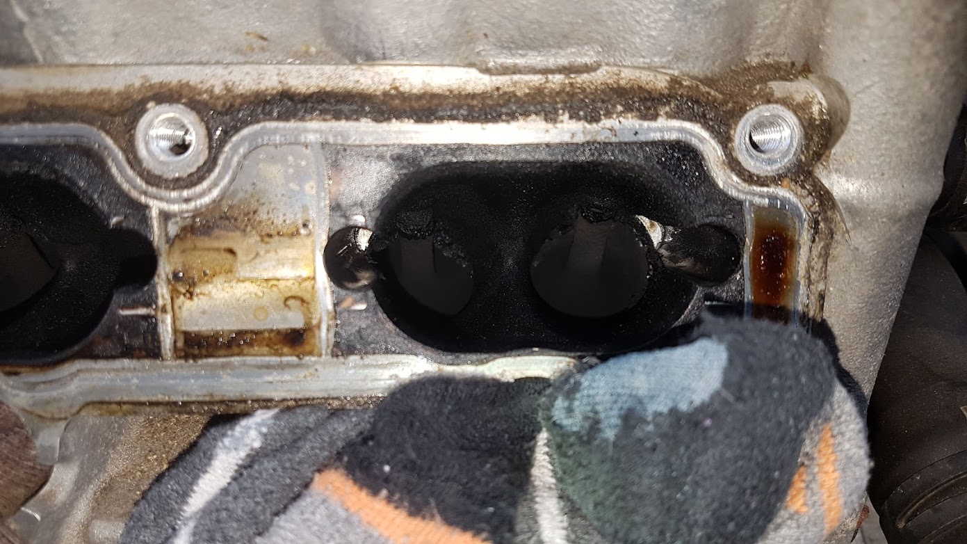

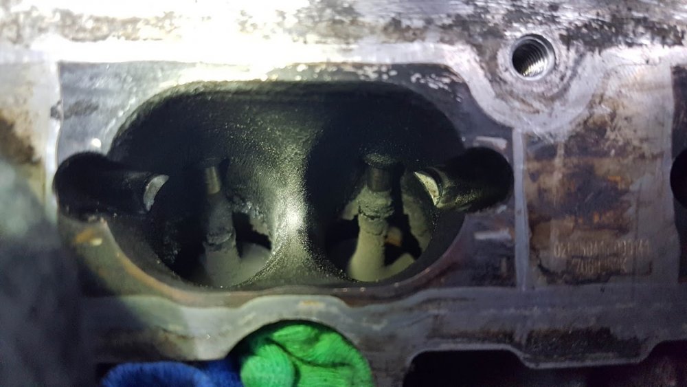

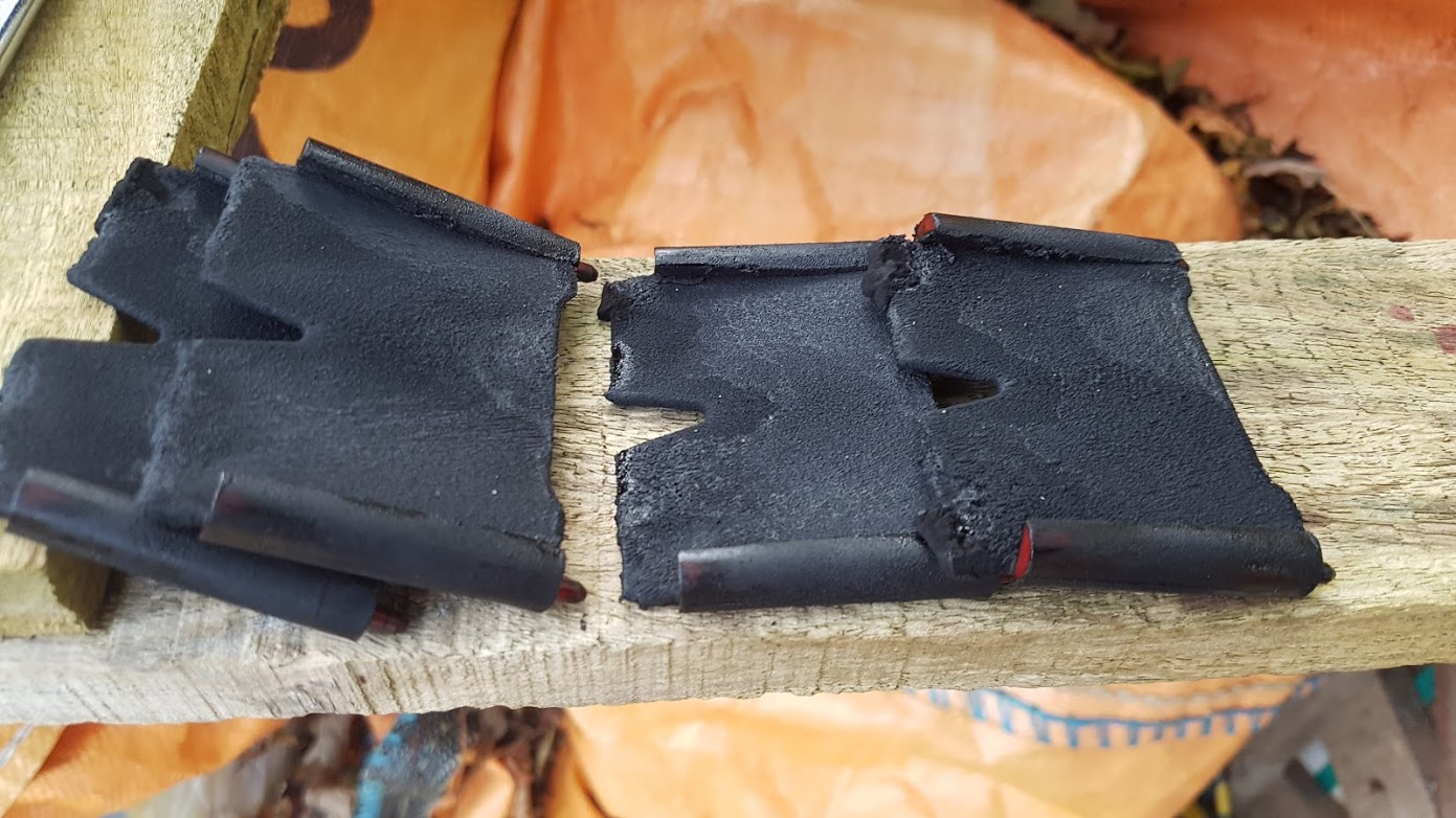

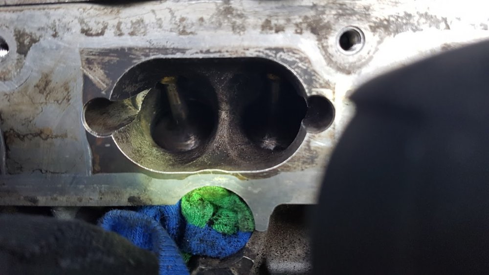

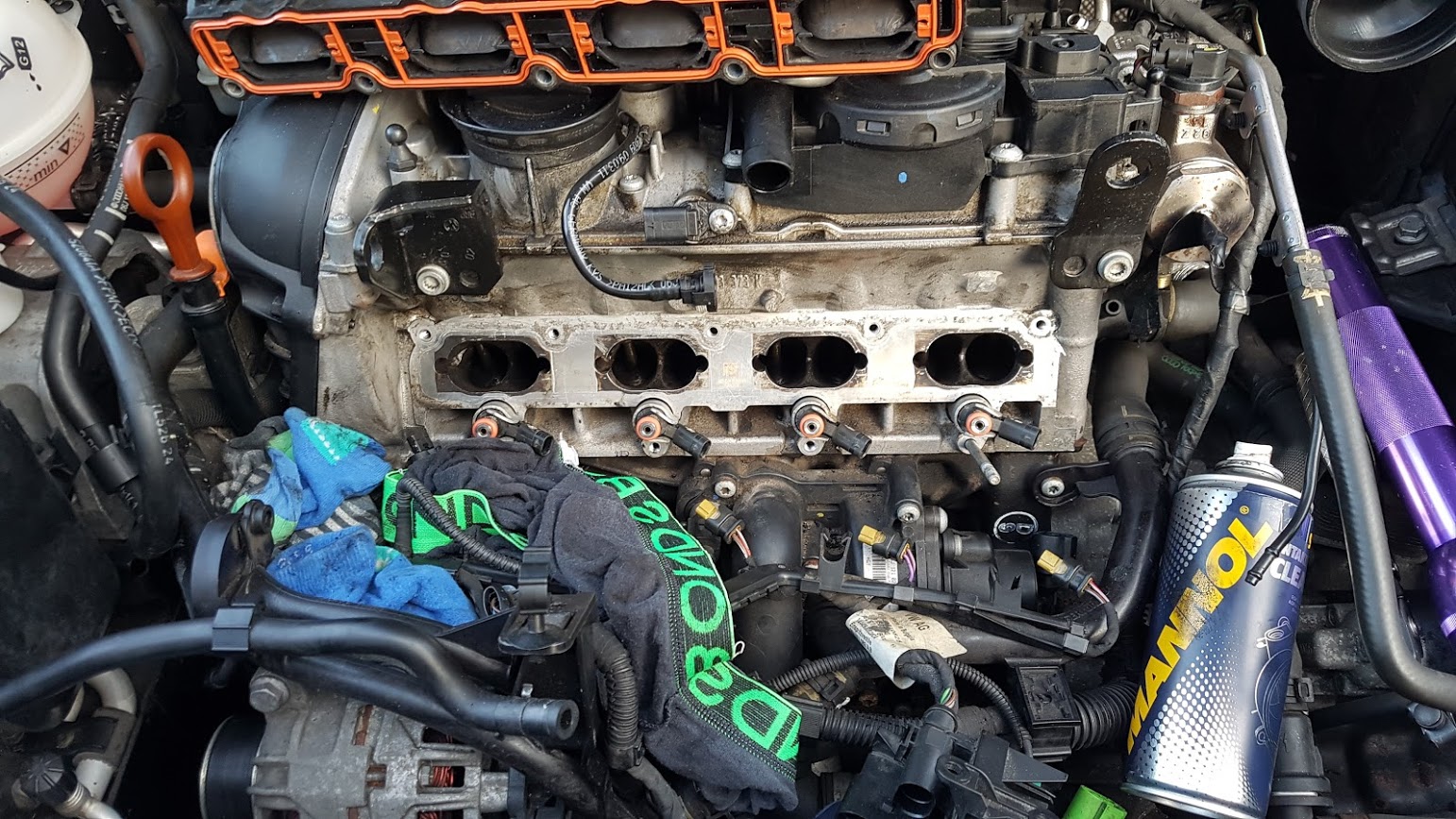

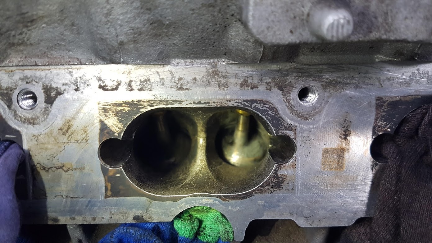

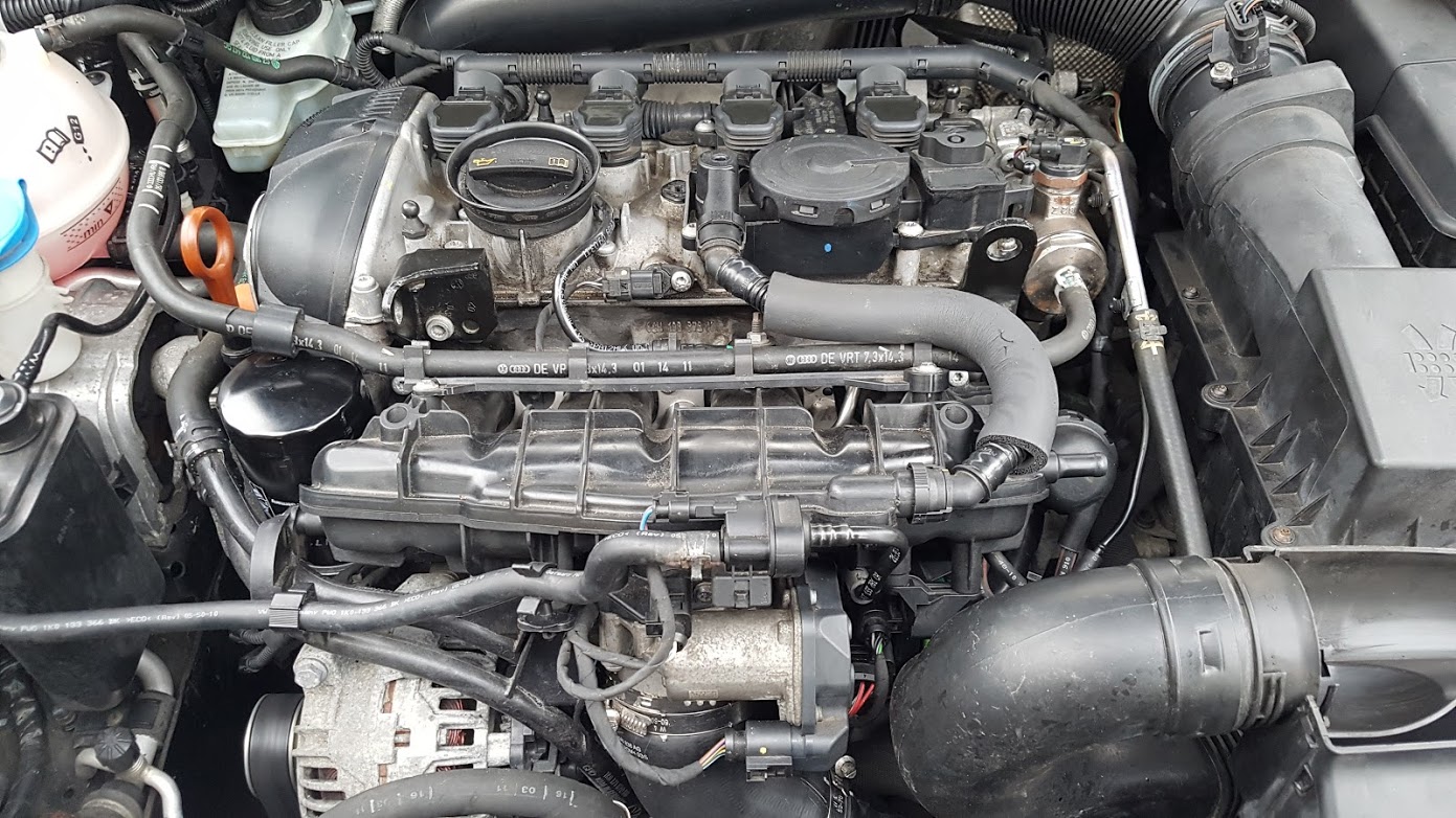

It wasn't as bad as I thought it might be. I went very slow and watched a few videos before hand.   The worst bit by far is the inlet manifold nose bracket the M10 Spline is a nightmare to reach.  Not looking forward to that on re-assembly.....

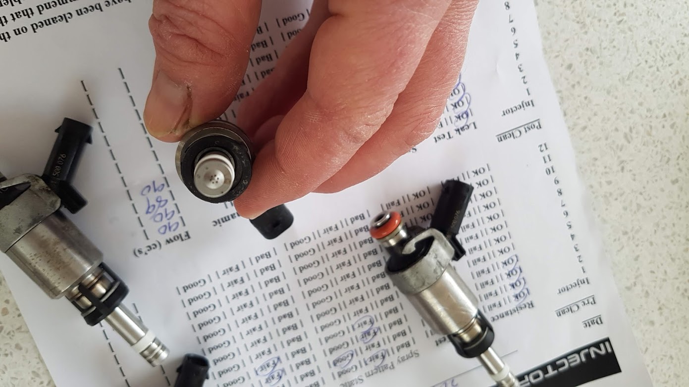

Update 1:
The injectors didn't arrive until midday Sat, so pushed things back a little.
Injectors all cleaned and passed all tests (leak down, resistance, spray pattern before 2 good 2 Fair, after 4 good).
Re-assembled. Only broke 3 plastic bits in the job! 1 - a small release tab on one of the electrical connectors but it still click locks ok. 2 one of the nipples on the port dividers that fit into the holes on the inlet mani gasket. 3 - on leg on one of the plastic stand off stands for the injectors.
After a fair bit of cranking and some key cycles / door opening closing it eventually fired up.
Did an oil and filter change.
All seems good now.   Throttle control response under light throttle definitely improved.  A road / motor way progress I did not notice a lot of difference tbh.
I am hoping the cold start light throttle miss and rough idle will be gone. Will report back after a few mornings.
Also hoping that the fuel economy might get back to levels of a year or two back. But to early to report at this stage.

£108.95 incl. return special delivery.  Did by mail order. They seem to have done a decent job, they use ASNU gear.
Yes, they changed the Orings and the combustion chamber seal, which you are supposed to need a special tool for.  The repair kits with seals and some other bits and pieces like the plastic 3 legged stand off that I broke are £12 a pack from VW (and you need 4no.)!

I used a stainless dental pick set I bought of Ebay and it was really very good.  I got 95% of contamination off with the picks and scrapers. The thing that also really helped was a workshop vac.  I used it dry, and instead I just used it to vacuum out all the debris periodically, as I cleaned valves / ports.
To finalise each port clean, I gave one or two goes with Mannol 9873 Intake valve / EGR cleaner. Used sparingly.  And wiped out the intake ports and valve stems to clean off some of the remaining contamination.  That stuff is potent though.  I used less than a can for the whole job. I have two left as I bought 3!
You may want to wear a respiratory mask. Or at least limit exposure as I tried to.  It evaporates off in pretty quick time but I mopped up with shop rags to get all the remaining sludge out.
Need to remember not to work on intake ports that have valves open, rotated engine on 24mm crank bolt to alternate.  I stuffed shop rags in everything I left open, like the other ports not being cleaned, injector holes,  intake pipework.  As I tend to drop  screws and bolts and tools and one mistake makes a lot of dismantle time or worse, if you don't notice!!

Well, I used the spline on a socket with an articulated universal joint connection.  This worked perfectly except for dimensions were so tight to the coolant lines (I had loosened the fastening brackets) as you undid the Spline bolt the socket universal joint would start to foul the coolant lines but I perservered.
I did not even remove the bolt or the bracket as a part of the job, I left it hanging.  Then on re-assembly those coolant lines were in the way again but  I perservered.
A shorter universal socket connection or Spline bit or removing those hard coolant lines would certainly help. Not enjoyable.

My injectors weren't terrible. They didn't look terrible when I pulled them. The tests pre-clean reported 2 x good 2 x fair.  After 4 x good and the flow was a lot better matched after cleaning.
The core problem was definitely the intake ports and intake valves gunked up. Mine is so much better when cold temp driving and idling now.  No more shuddering, missing and vibrating when idling!  I didn't really notice it getting worse over time, apart from slightly higher fuel consumption but then the rough cold driving just occurred and never went away a month or two before I undertook the cleaning.
