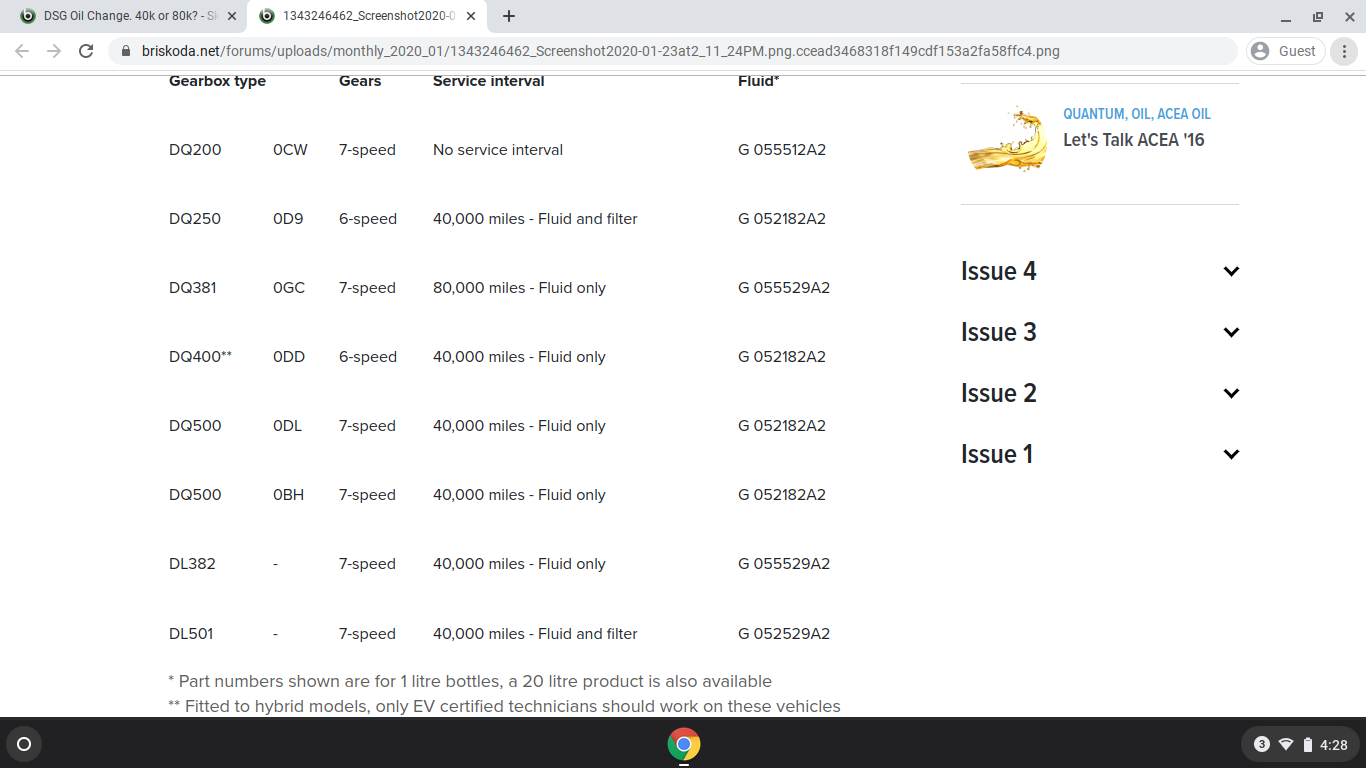

The DQ200 DSG / 7 speed twin dry clutch has 2 oils in. In the box and in the MCU.
No service schedule or interval for changing on them.  Not 40,000 or any other amount of miles.
That does not mean they can not have the Oil Changed as some do and as some Dealerships wrongly tell you is due.
The wet clutch DSG's are showing as the Schedule Change at 40,000 miles with Skoda, VW & SEAT,
Audi say 38,000 mile.
Edited by e-Roottoot
The 6 speed has a specified interval of 40k Miles.
The 7 speed has no set interval.
The 7 speed actually has 2 oils in it. One for the gears and a separate one for the mechatronics.

& it is the DQ200 DSG that VW did a world wide recall on excluding Europe and changed the oil from Synthetic to Mineral.
There are drain plugs and fill plugs.

Couldn’t edit my first post but the car is a 2020 2.0TDi 4x4 DSG, 7 speed variety.   How can I find out which DQ### it is?

That's the newer 7 speed DSG that does have wet clutches and a change interval.
It’s 40k for its service whether it takes you 2 years or 6 years, not a time related item like the cambelt
