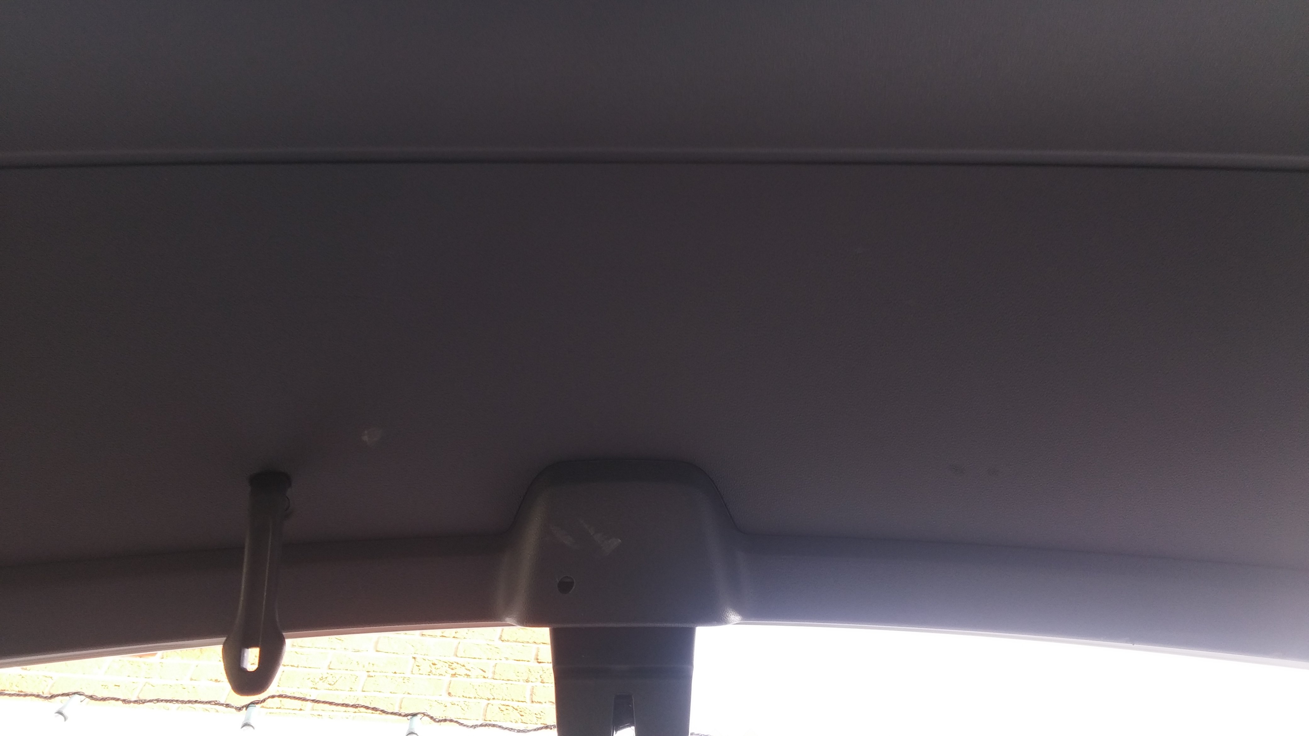

2015(65)  Octavia 1.4 TSI SE L with noisy rear wiper motor.
I want to change the wiper motor but I am not sure of the best way to go about removing the tailgate lid trim.
It looks like a large panel within the main trim, but I don't want to damage it by trying to remove it, and refit it.
I can only see one screw by the boot closer handle so I don't think that is going to help much.
Also which wiper motor brand, as I have read that the eBay ones are poor quality imports, although quite cheap.
I was thinking of going direct to Skoda but will I just be buying a brand name product ?
Any tips about the best way to tackle it please.

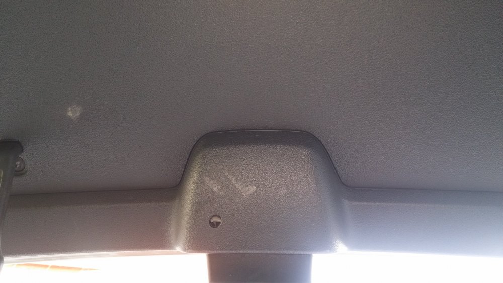

Thanks for the reply, but I have the estate and do not have any visible fasteners to remove. I looked around the edge and apart from the screw by the lock and one by the boot closer handle I am at a loss.
Undo the screw by the handle, then pull/use a trim tool to pull out the plastic panel.
it pulls away from the metal/glass and is held in with spring clips. Make sure you don’t lose any.

In my experience it was easiest to start by pulling the edges up to get the clips lose, then once you've released the clips from the sides work along doing the same at the bottom.

Thanks, I will give it a go.

You only need to take the larger piece off to get to the wiper motor.
The crash /reinforcing bar make it a little harder to get out and you will need  suitably large wiper arm puller tool.
