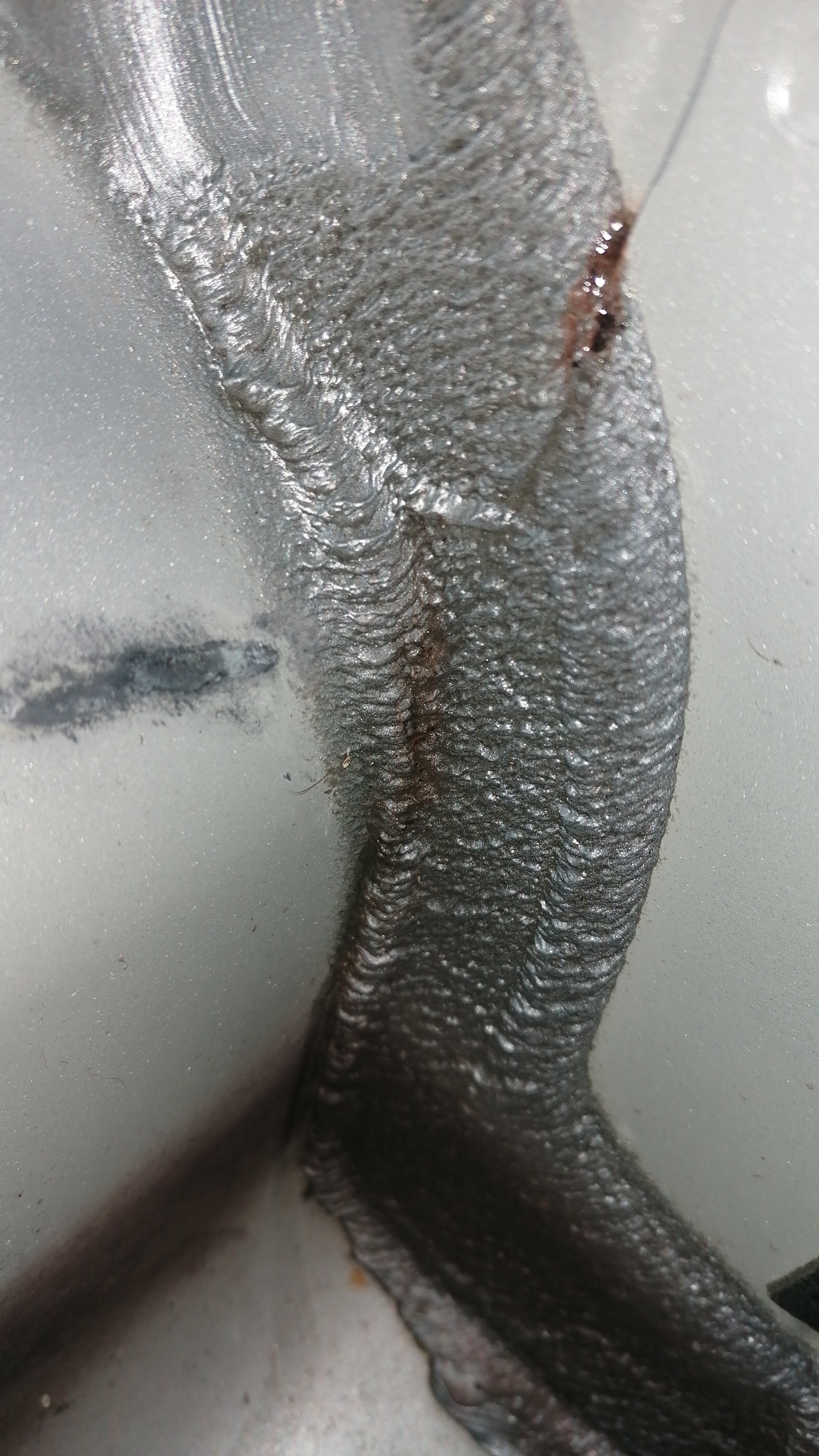

Bought my 2016 Superb two months ago.
Noticed the wheel well was full of water, sponged it all out.
In the "close up" picture, the water seems to be coming from the centre of the picture in the corner of the weilding stuff.
Not sure what the light brown stuff is, wether it's some sort of wielding or something.
The garage I bought the car off, had a tow bar fitted, at my request, you can just see the wiring in the top right hand corner of the second picture.
A bit concerned as in my laymans knowledge, the light brown weilding stuff looks like it's been added and maybe the car has been in an accident?
I've contacted the garage I bought it from, they said to bring it in for them to have a look, which I will do, but as I need the car for work I can't take it in until the week after Christmas.
Any ideas appreciated, thanks in advance.
It seems I got a bit carried away in my first post.
Yes, I have a water leak where I said, however all the weilding stuff I thought might have been done afterwards, after looking at pics of other wheel wells, is the factory weilding.
I'm still after ideas on how the water is getting in though.

Did you ever get to the bottom of this Tim? My estate does exactly the same thing. Water appears into the boot through the welding seam offside rear in the wheel well. I also have an aftermarket towbar like yourself.
