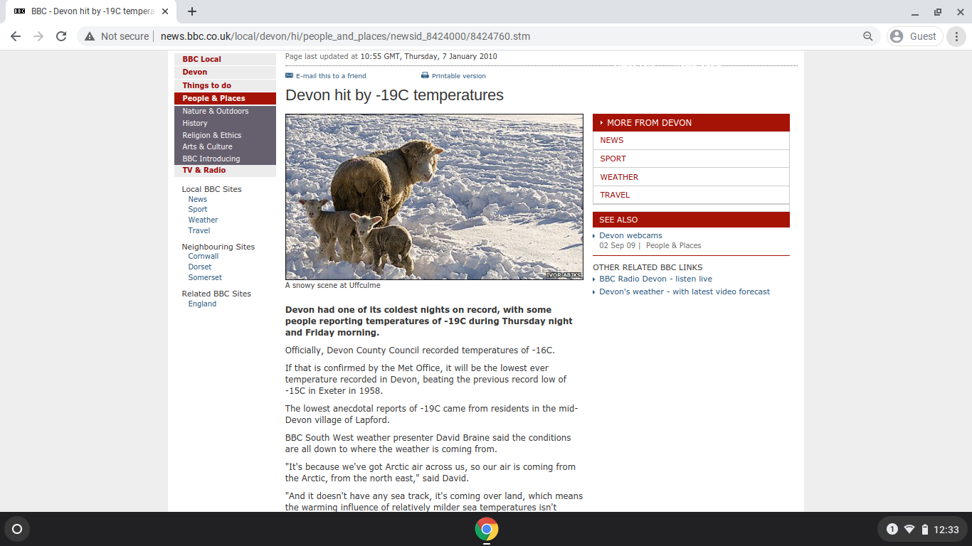

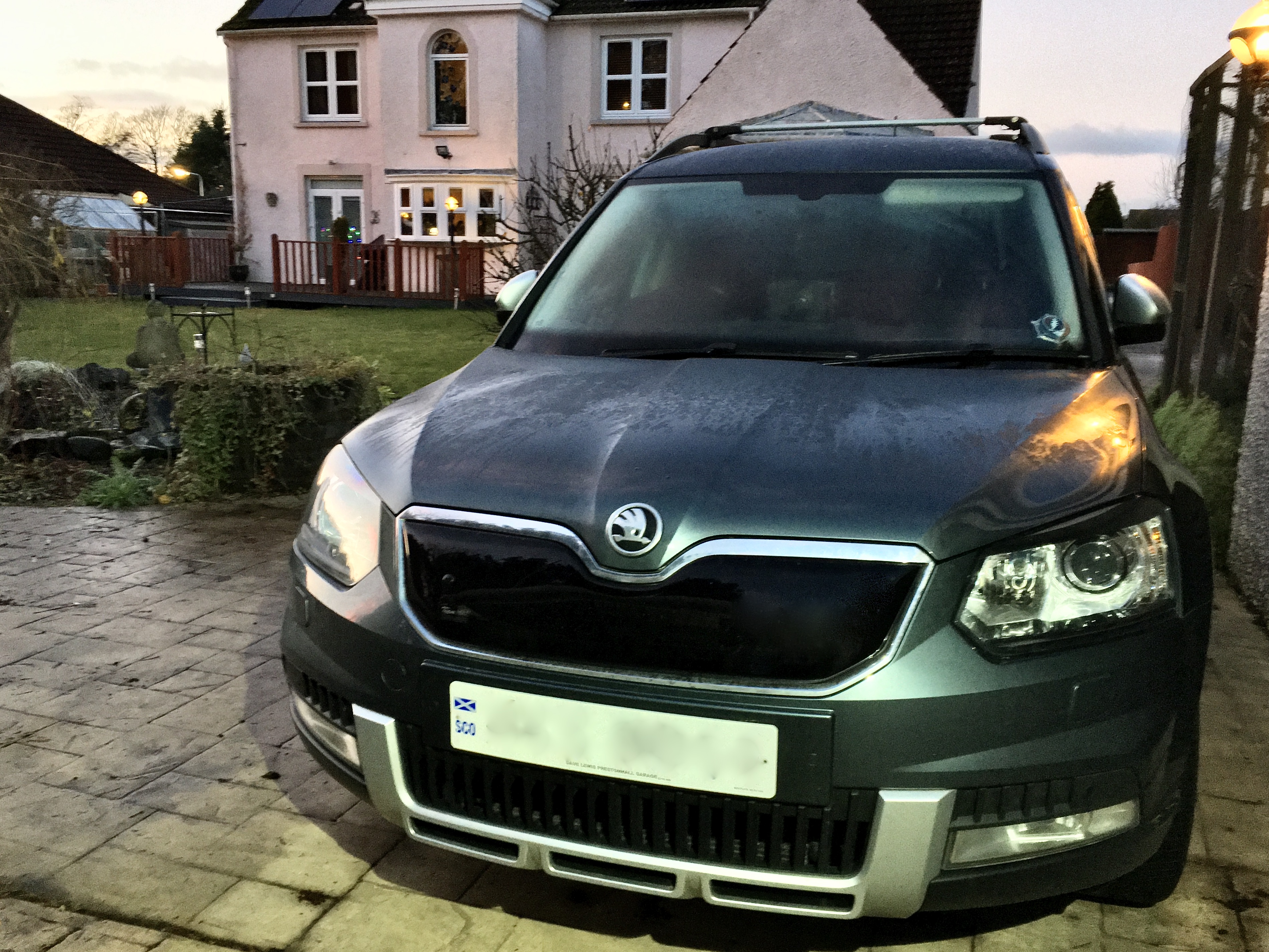

I just fitted one to my Yeti last week.  Without doing any back to back tests in similar conditions, I think the oil temperature is coming up a bit more quickly.  I bought it on eBay from these folks in Latvia.  It arrived 5 days after purchase.   https://www.ebay.co.uk/sch/viesturs_autoparts/m.html?item=113730511503&ssPageName=STRK%3AMEBIDX%3AIT&rt=nc&_trksid=p2047675.l2562    However, I see that Superskoda are doing one for the lower grill so that might be next.
