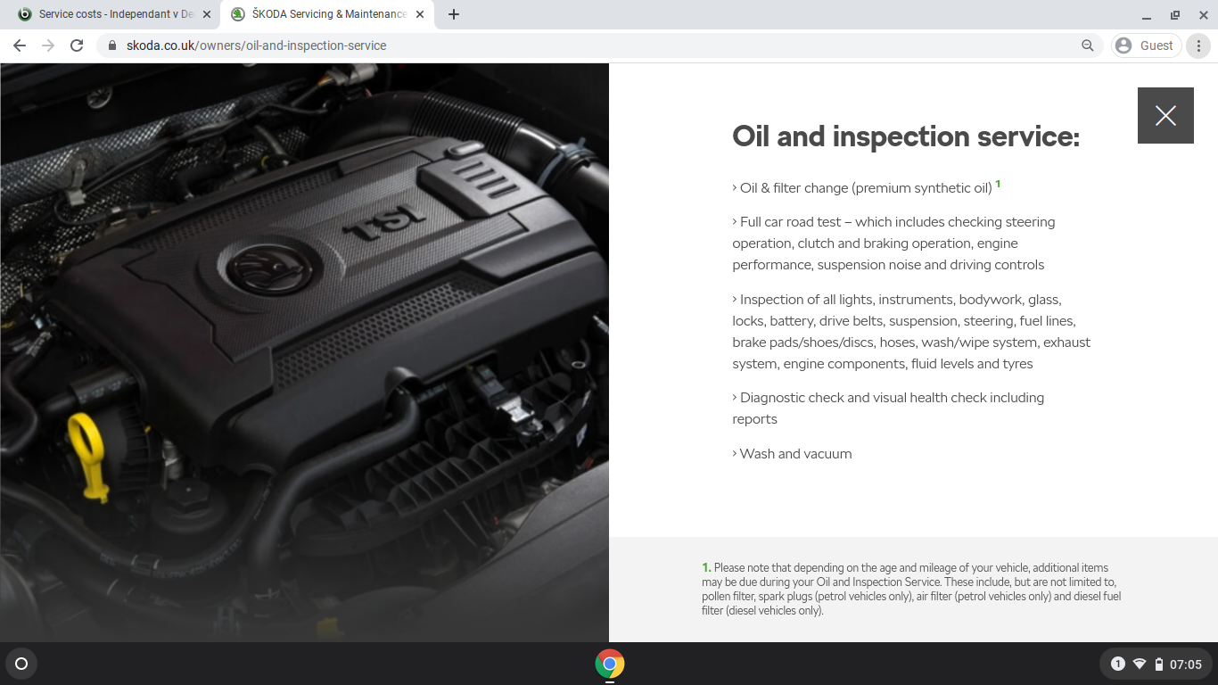

How much are people paying for servicing, cambelt change and dsg oil at independant v dealers.

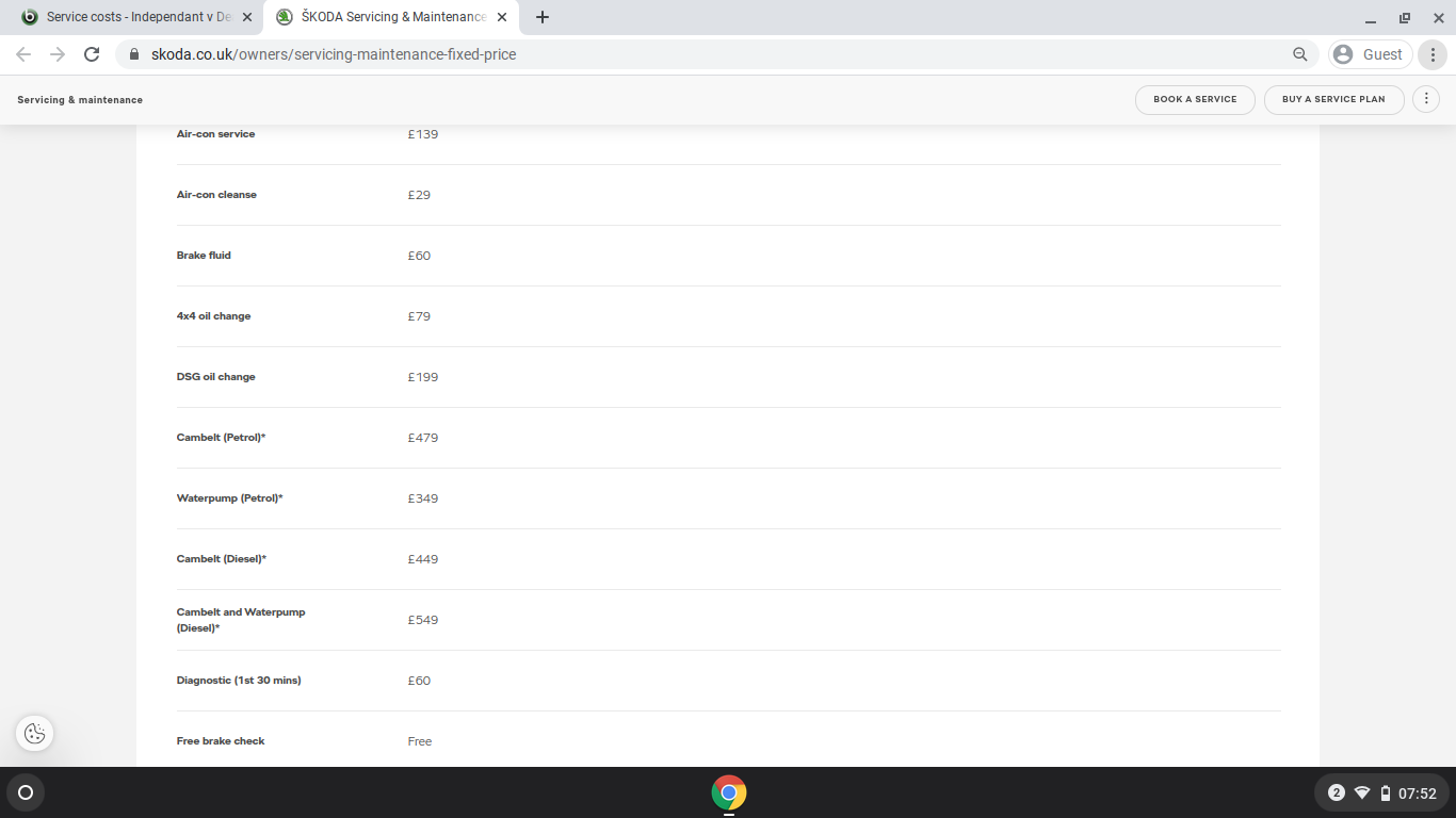

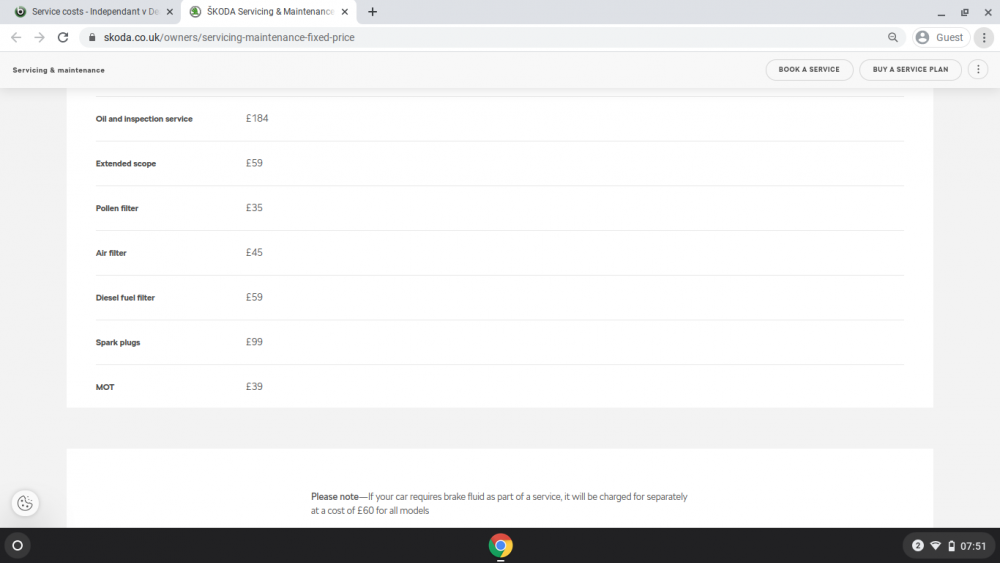

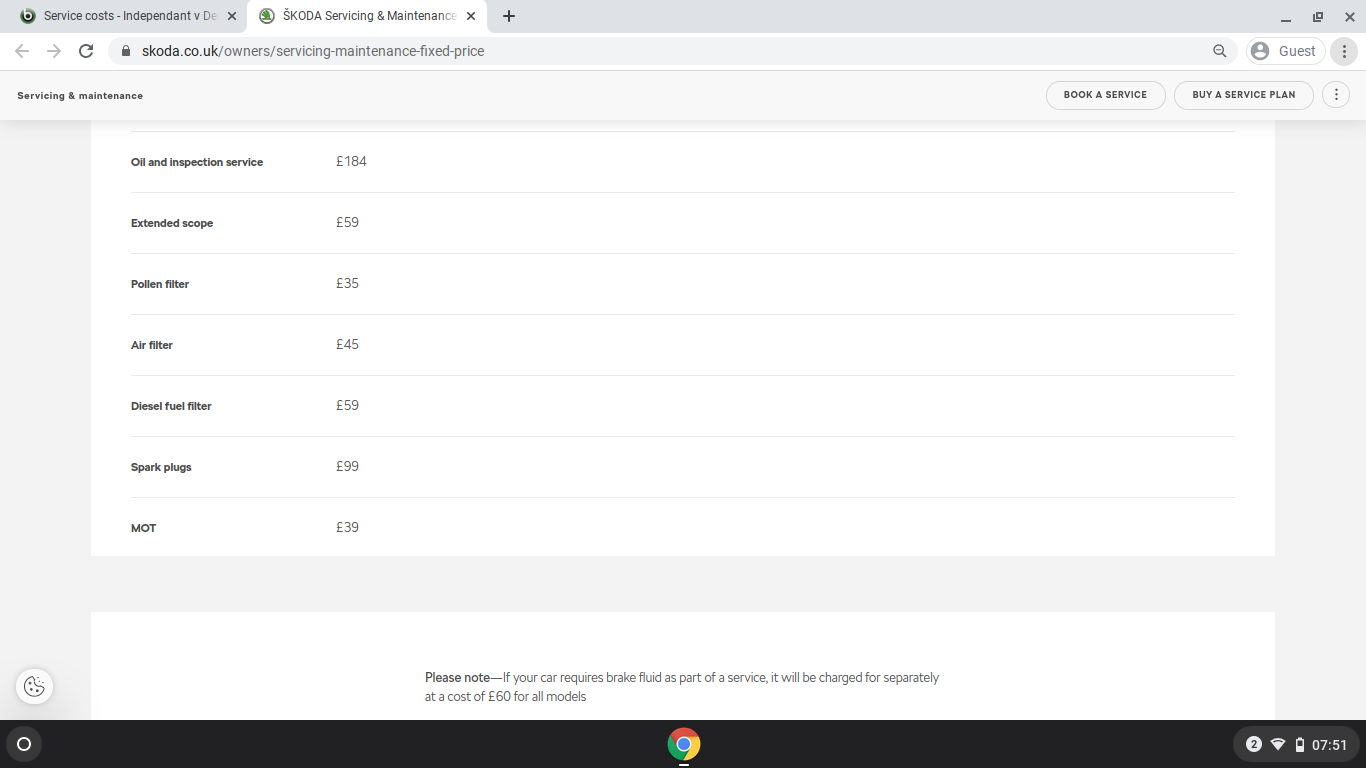

Dealers publish the prices on the skoda site, £184 for basic oil change, 59 (for additonal scope), £199 for DSG, £594 for Cambelt.
I've just booked in my 2018/ 3 year old/ 21000 miles 1.4 TSi for "Oil Service and Inspection" at DM Keith Leeds at a cost of £279.  Or should I say that's what I thought they said but your figures are now making me wonder if I misheard.
The Skoda UK Fixed Price Service & Maintenance prices published are on cars.
3-10 years old, & at Participating Dealers, and Dealers can charge less, and can charge more.
Now Oil & Inspection Service and extended Scope each 3 years.
But
some still quote on Minor / Interim Services and Major Services.    https://www.skoda.co.uk/owners/servicing-maintenance-fixed-price

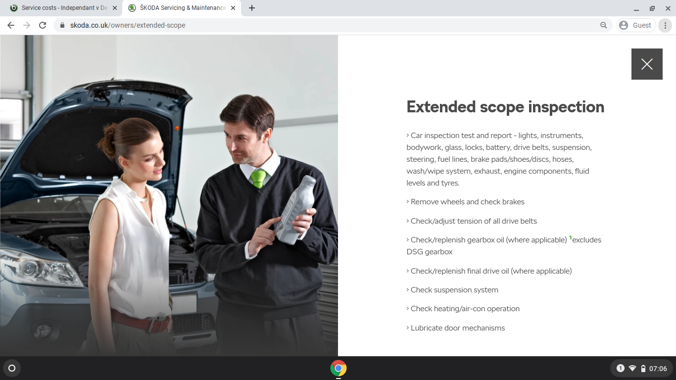

Best ask what is actually getting done, and what parts will be replaced and that you will be paying for.
Are wheels really coming off?
Only visible belts are being inspected.
Is the Haldex actually having the screen cleaned?
Is that Body Inspection all that Skoda UK require for the Corrosion Warranty?    (The warranty T&C.s do not say Body Inspections required in the 10 years.)

So looking at Skoda fixed servicing it seems to be £184 every year, and "extended scope" every other year -is this just more inspection/labour?
Then add on DSG/Pollen/Brakes/air filter/brake fluid as extras.

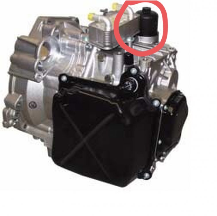

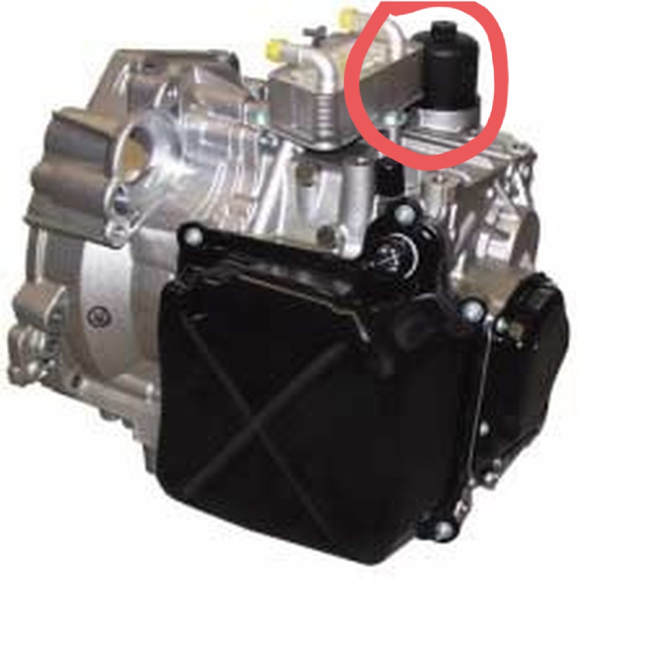

Not that I am near Rochdale but no filter change for the DSG service ? I always thought they have a filter that needs changing while at it.
Do you do it at additional cost?
The independent I did mine at charges the same price as Skoda fixed price for DSG service but includes a filter change. Mine is a dq200 6 speed.

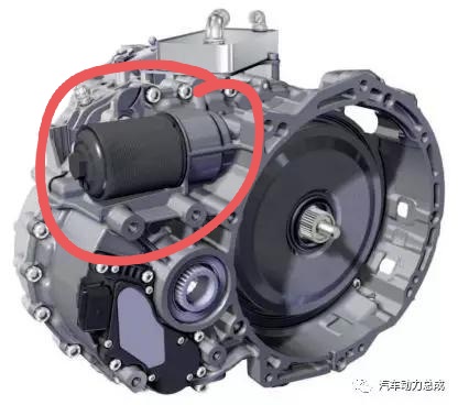

The 6 speed filter is always changed with the oil during the service.
On the 7 speed the filter is not as easily accessible and requires additional time to replace. It could be done during the service but for an extra cost.
