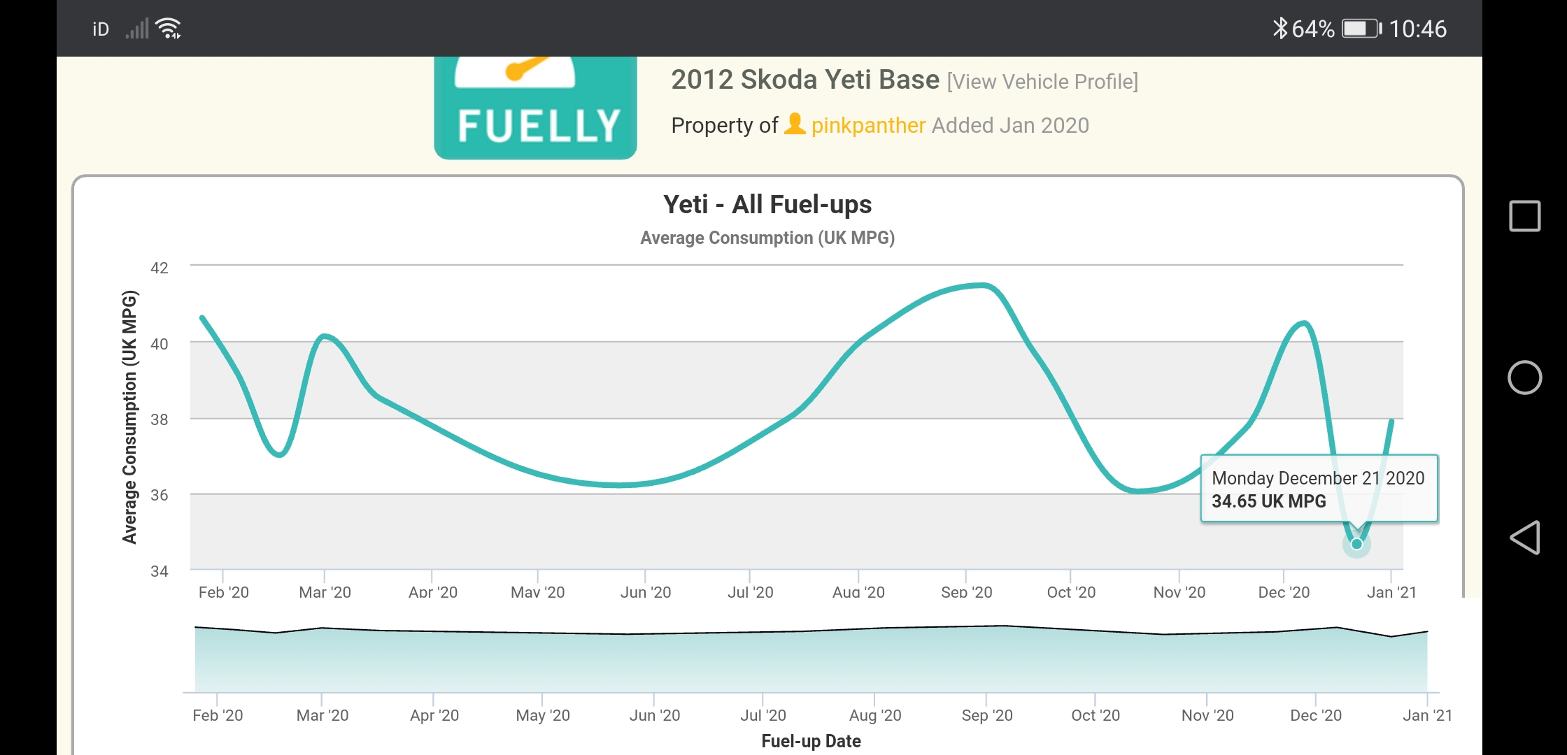

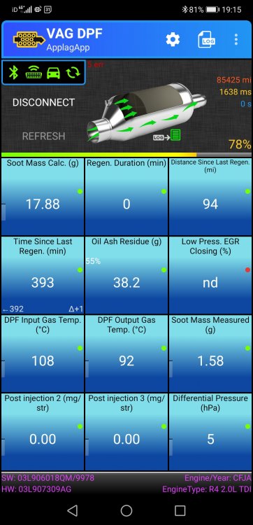

The lockdown / enforced reduction in mileage and recent cold weather have not been kind to my Yeti:crying:
It's now typically regenerating the DPF every 100 miles and I've had issues with the oil level rising, presumably due to it becoming diluted with diesel (from uncompleted regenerations).
MPG has also nosedived to mid 30's - see below:
I generally do 20k miles / year, so haven't previously had any issues running a diesel car long-term.
Still a truly excellent, capable and dependable car, but with its relative lack of value I suspect I'll keep it for a rainy day;)IMG_20201229_085207.thumb.jpg.4e648c9a19203cb8189636cbd9b2b1f5.jpg
