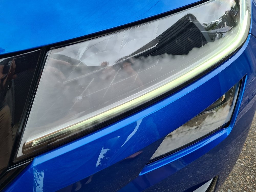

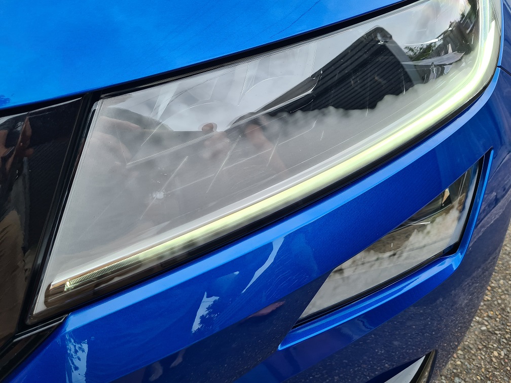

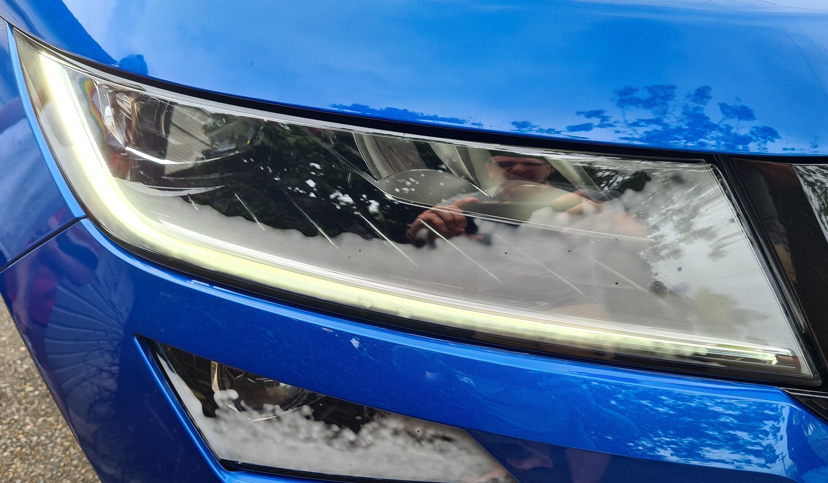

Third, I've read a few posts on the 'fogging of the front lights'...Below are pics we are getting. The car has only done about 30 kays since new, this is on day 2 of pickup. Car was in garage prior to this, then I drove to my brothers place about 10 kays away to show him. He pointed out the lights.... I'm presuming not even worth mentioning to the Skoda dealer?

Re: lights fogging - make sure the caps on the back of the lighting modules are properly in place and they are not missing or incorrectly fitted.  A dealer check will verify this for you.

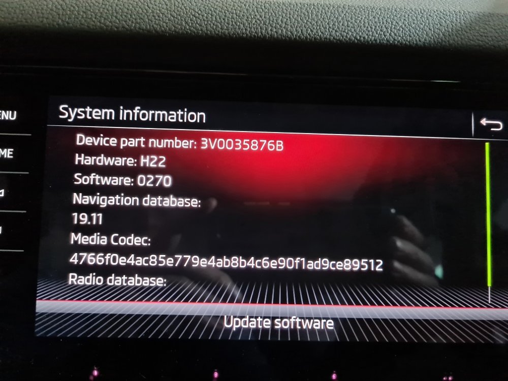

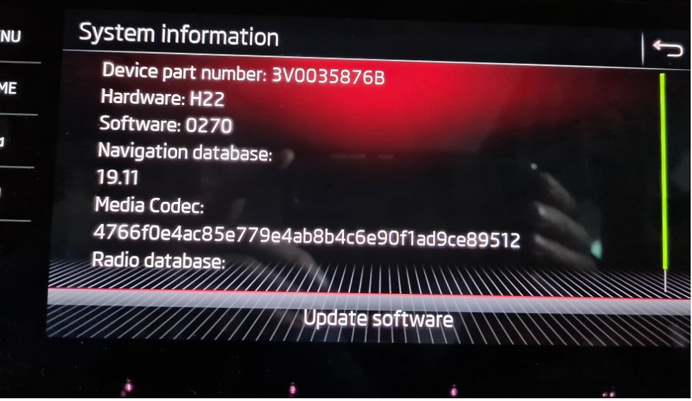

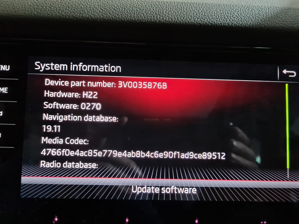

No firmware updates either, seems I have the latest.. This is what is on the system..
Okay - That looks like a Columbus system to me and an MIB2.5 system. That's a curious combo for an MY21 car. Do you have a DVD drive in the glovebox for that system?

I've been told it's a MIB3... I find it a bit strange that the MY20 same car (rs) had DAB+ and personalistaion, and this one does not.
I've got an older vagcom/vcds (the version that is not locked to a particular vin) so I can plug in and do a bit of digging.... Any ideas where/what I should be looking for?
