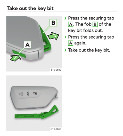

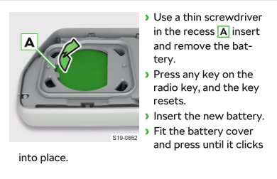

Hi all,
Only had the car (Ovtavia SE Technology 150) about a month and its now telling me the battery in the key needs changing?
Anyone else had this? And does anyone know how to do it? Maybe I'm missing something but can't open the key to get to battery, and don't want to pick at the key..
Cheers
image.png.9d93c98300ec5e5718b264fbbf02beae.pngimage.png.8231dc665f1e662fe5439a7785be3b64.pngimage.png.f34a5e53428ea01b70016393119c9c30.png
Cheers - seems ridiculous to have to replace battery after 1 month, but I guess easier to just do it than complain..
