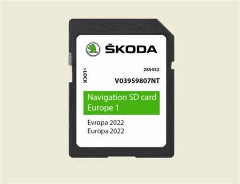

Can anyone advise what to do if you have formatted the OG Skoda SD Card? All partitions on the SD drive has now been cleared. Could someone advise how the SD card is partitioned please? I'm hoping to repartition the SD drive correctly then cur and paste the folder MAPS into the correct partition section...

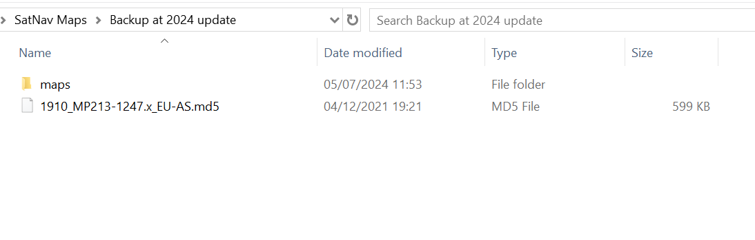

No partitions, just a *,md5 file in the root area of the card, and a "maps" directory containing the maps.
MAKE SURE THE SD CARD IS FORMATTED TO "FAT32" (not "FAT" or "NTFS").

Yes. I am using the original Skoda SD Card. I think when I formatted the card it has deleted the position with the root commands on it and that's why it is not recognised by the car... May have to buy a replacement SD card...

It doesn't work that way, the information that makes the SD card into a Skoda one cannot be deleted by a Format.
