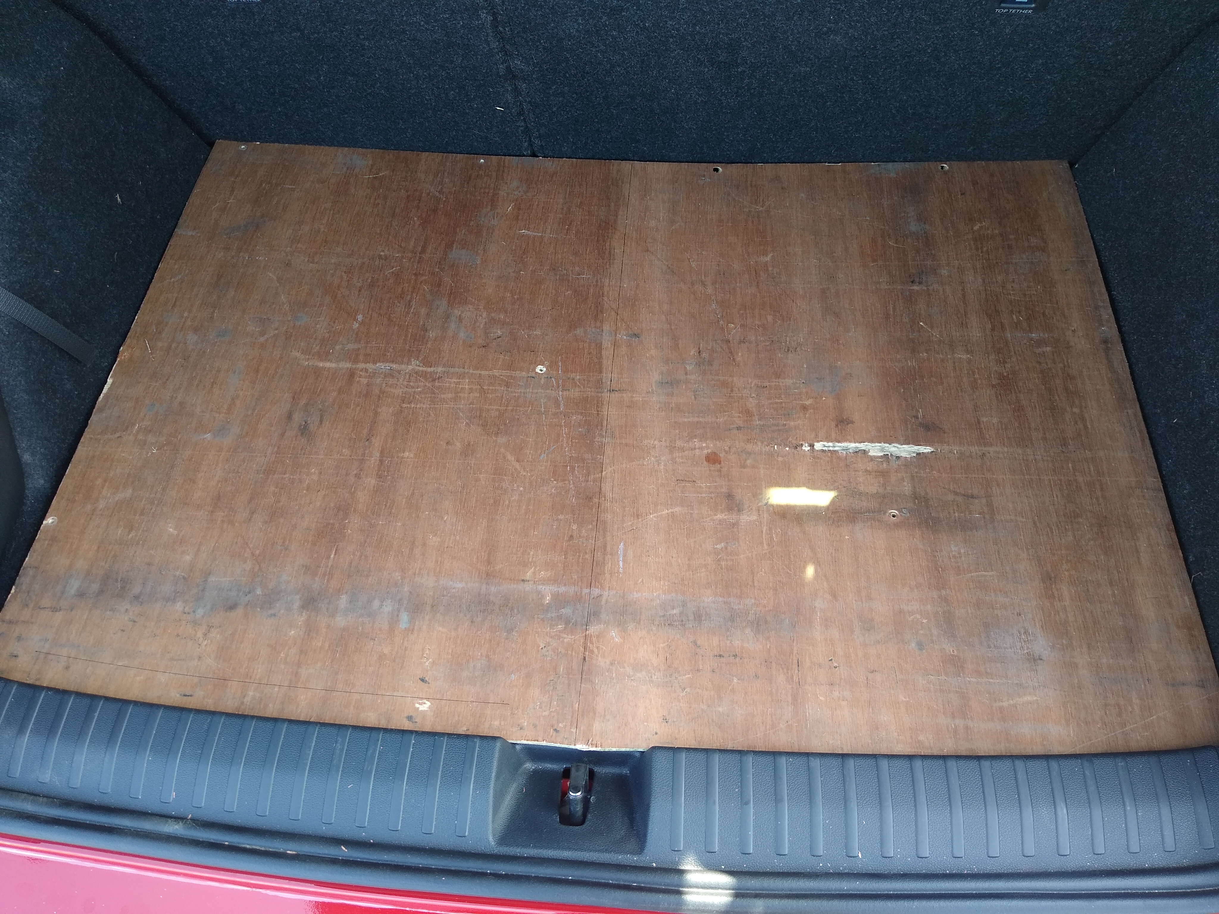

A tenner for one from a MK1 or MK2 Octavia from a breakers, all the MQB vehicles have the same width between the wheel arches, it takes just a small amount of woodworking to make it fit, cutting to length if required (for the Yeti you simply remove one section) changing the rear profile if you are really OCD and modifying the height of the side rails.
I have done the above twice on a MK2 Octavia and a Yeti, a very simple DIY job that looks 100% OE when done.
Just cut out  template for the boot floor. Used an old piece of thin ply. Cut to approx size of measurements given by Seasider, then scribed the curve on boot lip. A bit of adjusting needed before using a thicker plywood.
Thanks Seasider for your help. I update you all with the next stage.
