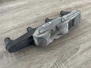

23 hours ago, Pester said:
coil packs cylinders 3&4
This is impossible since the 1.4 mpi 8 valve has a single coil pack unit for all four cylinders. If yours has 4 coil packs it can't be a 1.4 mpi 8 valve.

Pretty sure mine is 16 valve single coil packs injection model.
