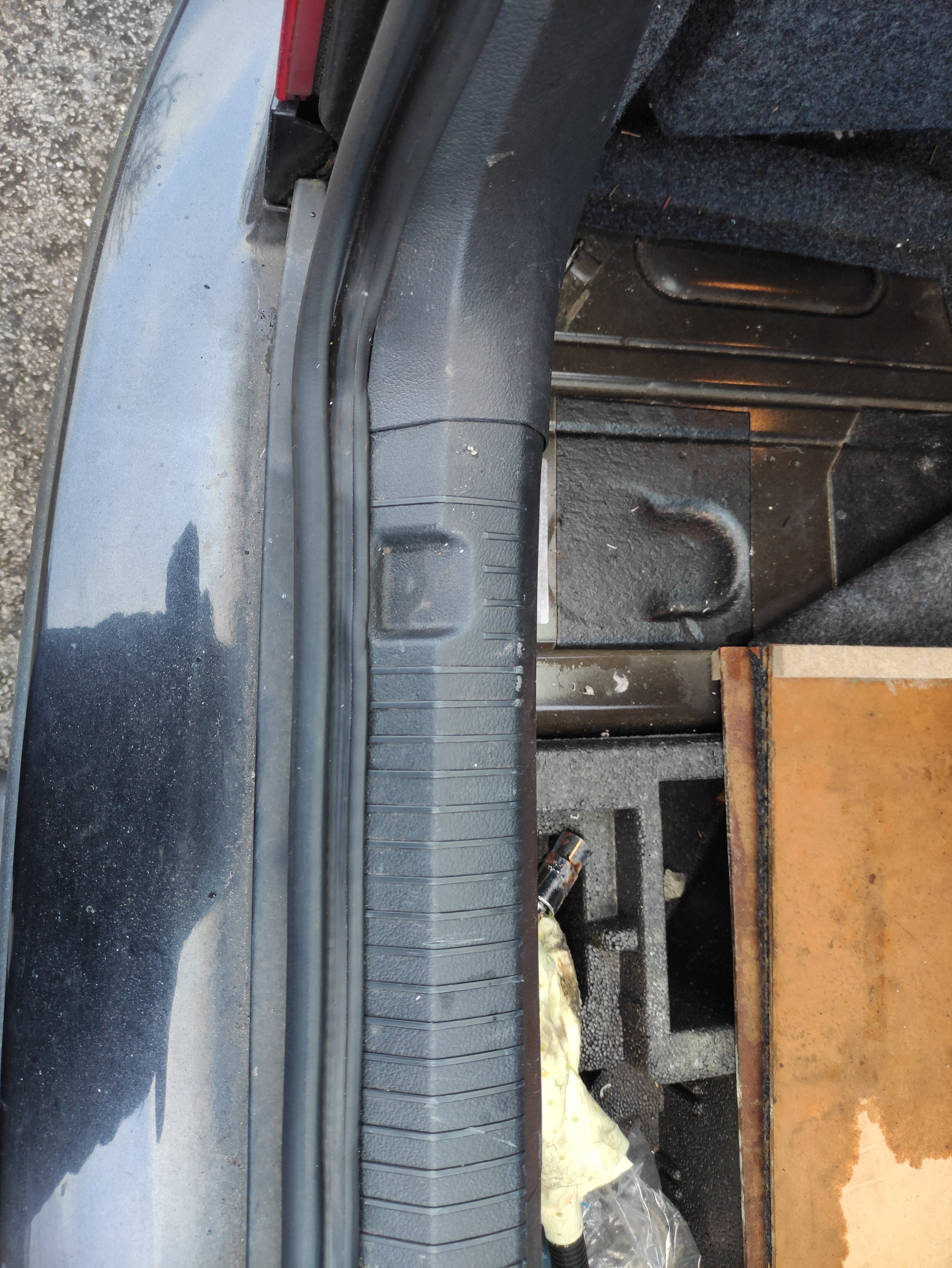

Interestingly, no idea why I've not noticed before but the boot seal looked really weird on the left hand side which is where water has been gathering the most.
I ended up pulling it out so it looked more like the right hand side, and it still doesn't sit 100% right in the middle, but god knows how long it's been like that for.
Hoping that's what it's supposed to look like with the rubber lip sitting over the plastic not jammed under it like some of it was. Thing is it's likely to have been like that for years though so who knows.

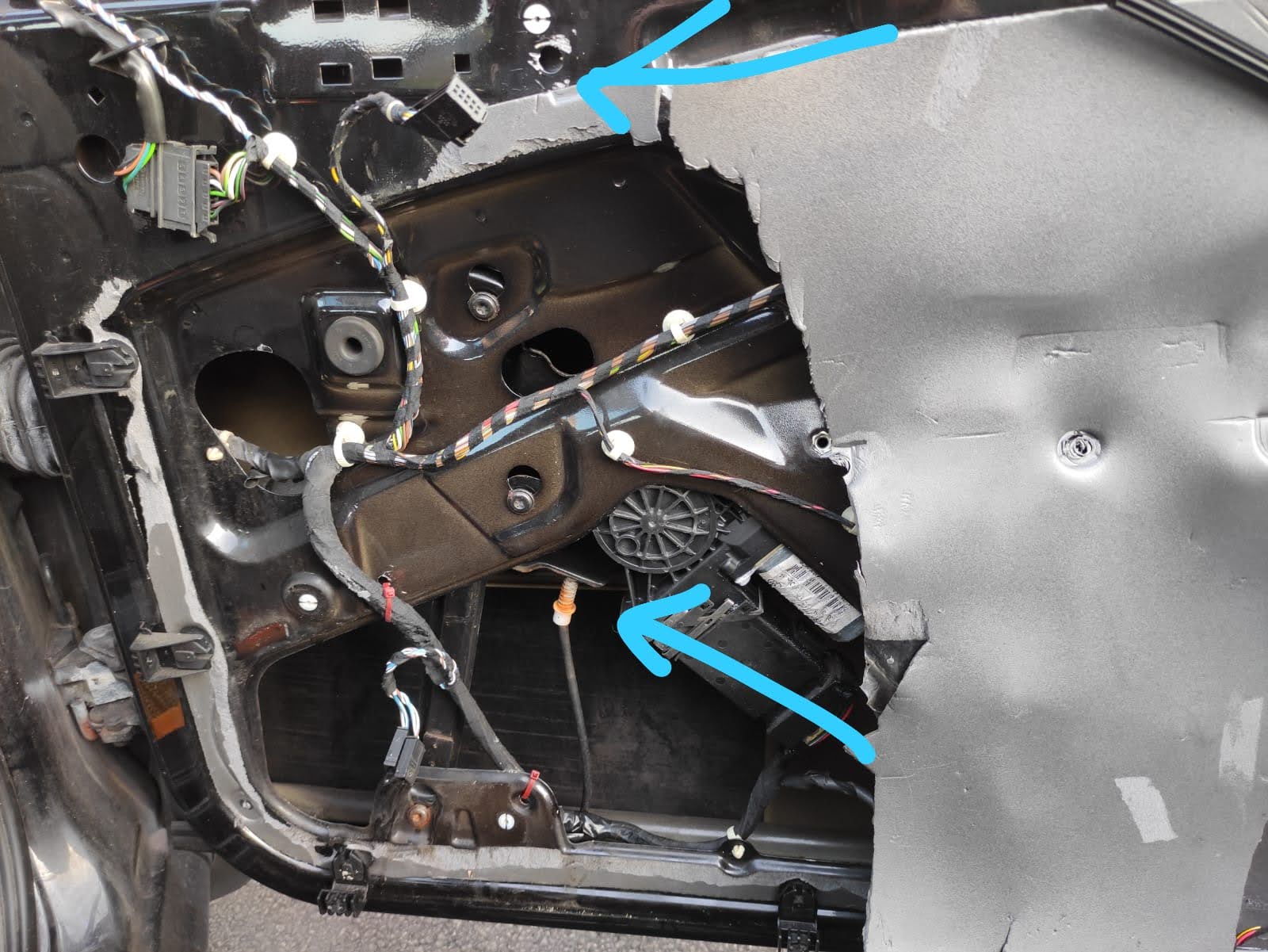

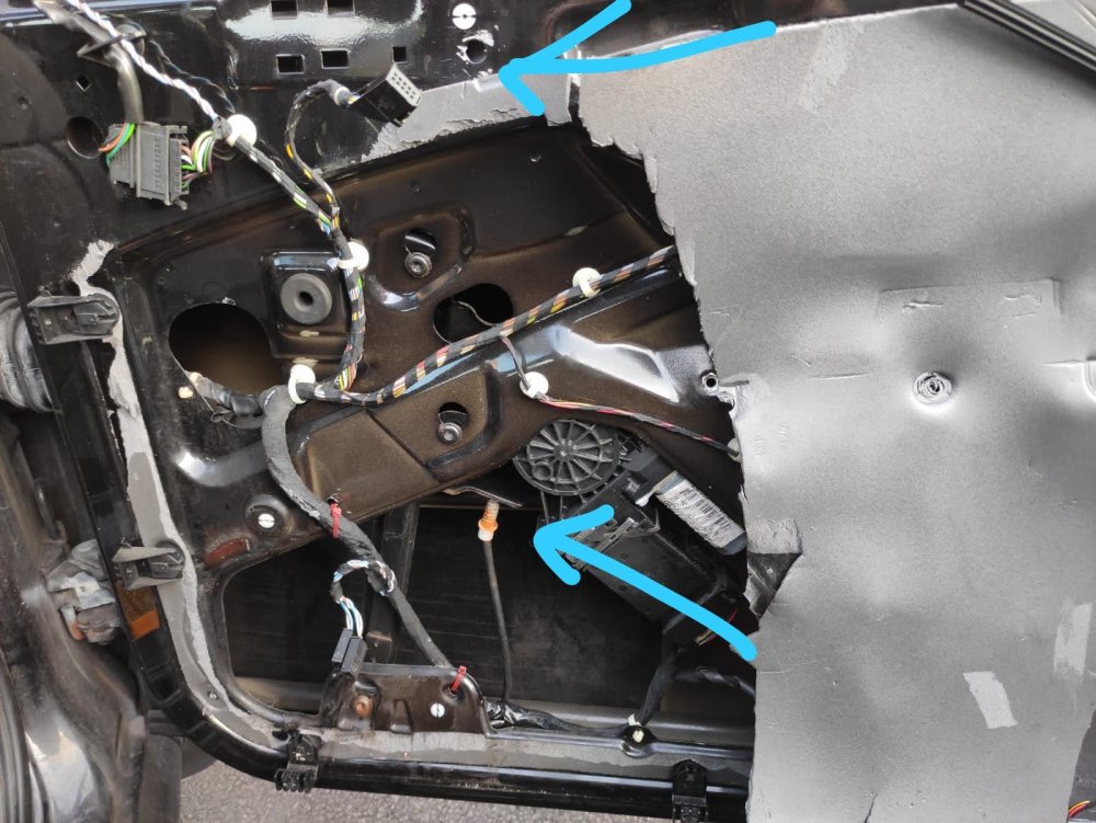

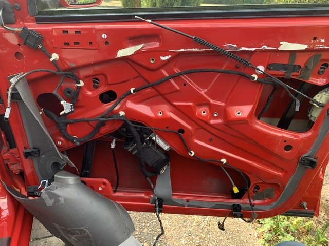

Got things dried out and have managed to get time to strip the door down.

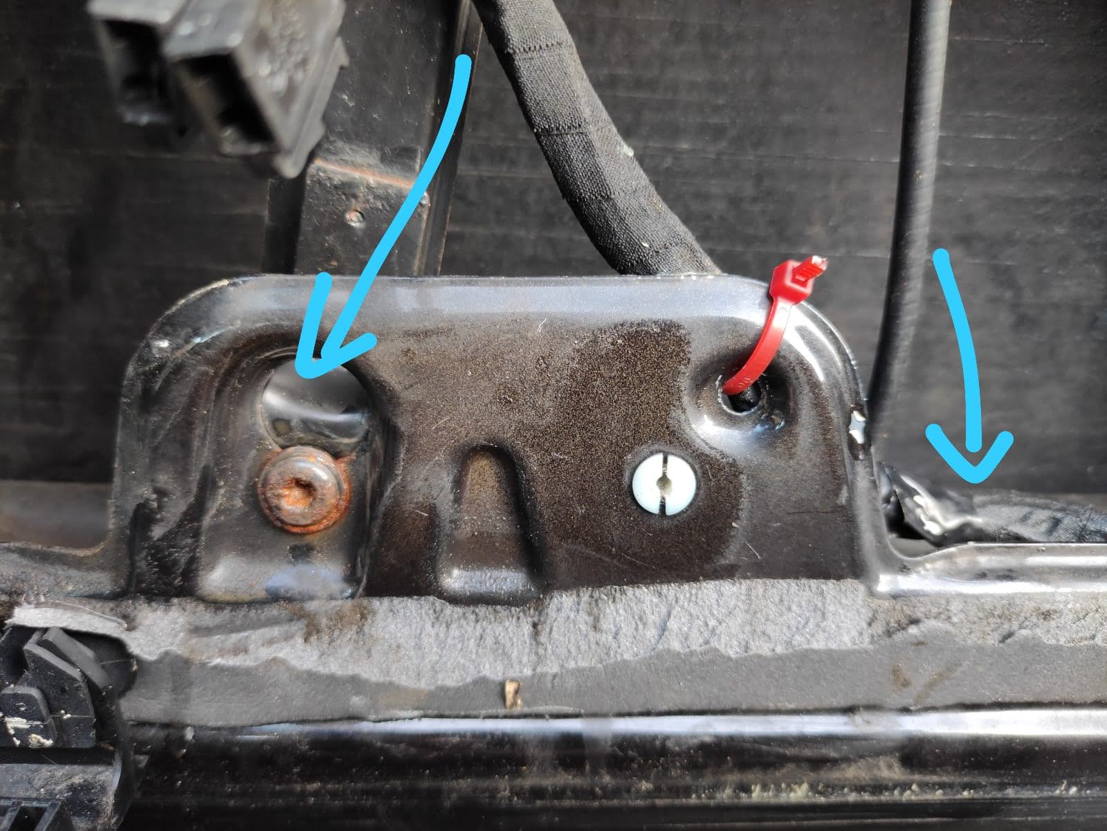

There was more of the panel film there than I thought there would be, but it was torn in two. The window regulator was swapped out last year and as you can see from some of the photos with blue arrows there is wet that's caused some of that replacement to corrode.
The cable near the red cable tie with the blue arrow was wet, and to the right of it I appear to be missing a clip. I'm going to see if I can get replacements, not convinced sealing it up will make much of a difference though.
Suppose the best approach would be to seal it then put a hose on the car before I reassemble the door? Only other thing I wasn't sure on was whether there should have been something in the hole toward the top of the door where the arrow is.

Depending on how far you want to go. I'd strip down the door loom and then retape it up, and then use oem tesa tape to wrap it all up.
I went through this when doing my looms (in my other thread), see here:
Well worth doing if you plan to keep the car for a while.
It seems that the water may have been catching on the metal and dripping on the to wire maybe?
Yeah, struggling to find the white clips local, was ideally wanting to get the red cable ties replaced with the proper fixings before trying to seal it back up. Managed to source some film, just wondering whether to use double sided 3m tape or not, what's what the guy suggested selling the film.

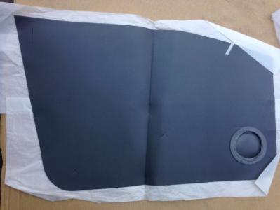

i wouldnt trust double sided tape.. itll be hard to get a 100% continuous bond with 0 gaps, and over time the water that naturally goes through the door (it will always and forever get passed the rubber strip at the window) will breakdown the glue.
i used 1500gauge dampproofing builders plastic sheeting and bonded it with pvc pipe jointing compound. all designed for long term water exposure.

no idea, but to be homest comparing the "clear" sheeting i used and the clear sheeting i took off the difference is.... the oem one is machine cut to the shape of the door, mine was stanley bladed to shape once fitted.
i also used duct tape to reinforce it around the cable holes..

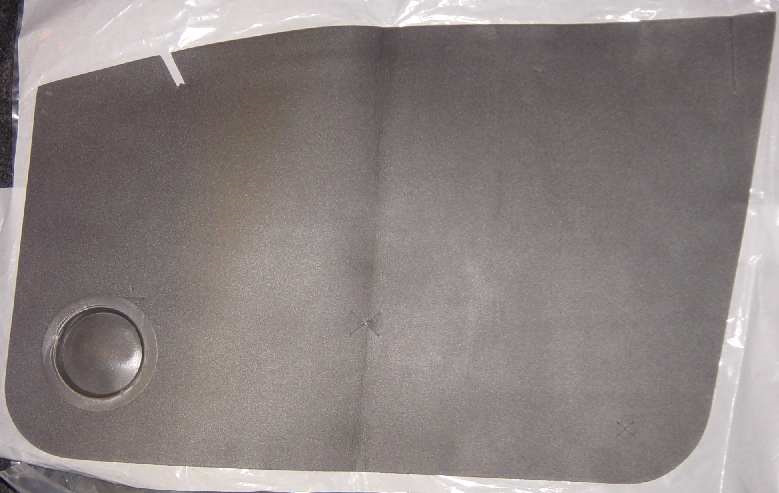

mine was a back door, but i didnt think the fronts were different? or is there an "uprated" foam version for the front doors???
  • Administrators
Yup, in my project link above.
Both my 54 and 55 plate have foam coverings.

Indeed they do relate to the RHD after checking. And as bonus, these are the foam version as I believe they don’t do the original plastic sheeting and change over to these quite a few years go.
1U4 868 395 F nsf
1U4 868 396 F osf
1U4 868 399 nsr
1U4 868 400 osr
