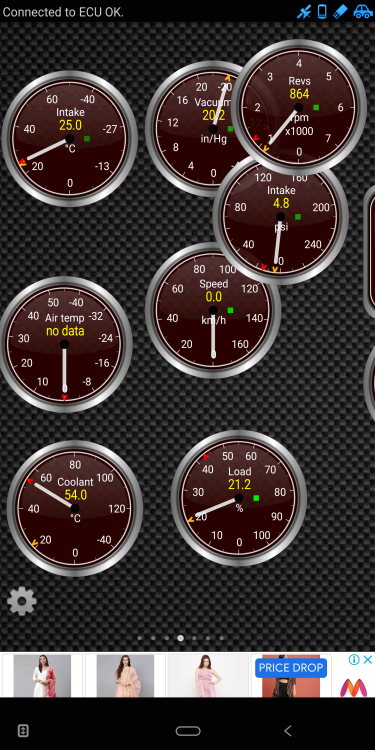

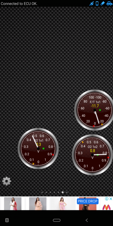

Here is the screenshot of toruqe readings when I started the engine if it can be of any help.

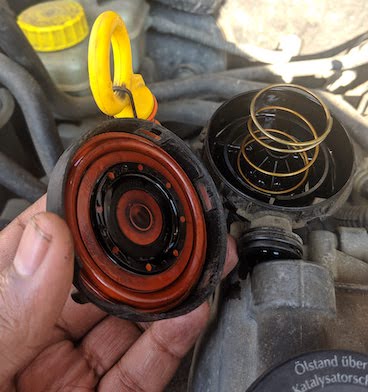

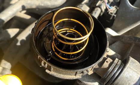

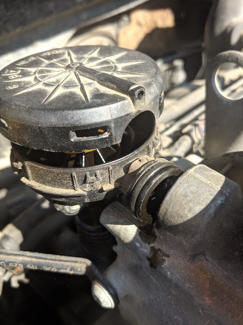

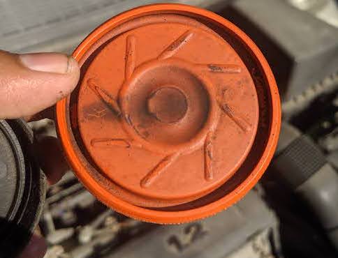

Today I got some time to remove and check the PCV values. below are the pics,
I dont think I can rotate the inlet hole as it wont fit :( :
The diaphragm was sticking to the cap guess it is not an issue:
The diaphragm  looks fine:
There is some oil in the bottom of the holder:
The diaphragm looks fine to me and I guess there was no much leak as from my earlier inspection, So is this could be any other issue?
