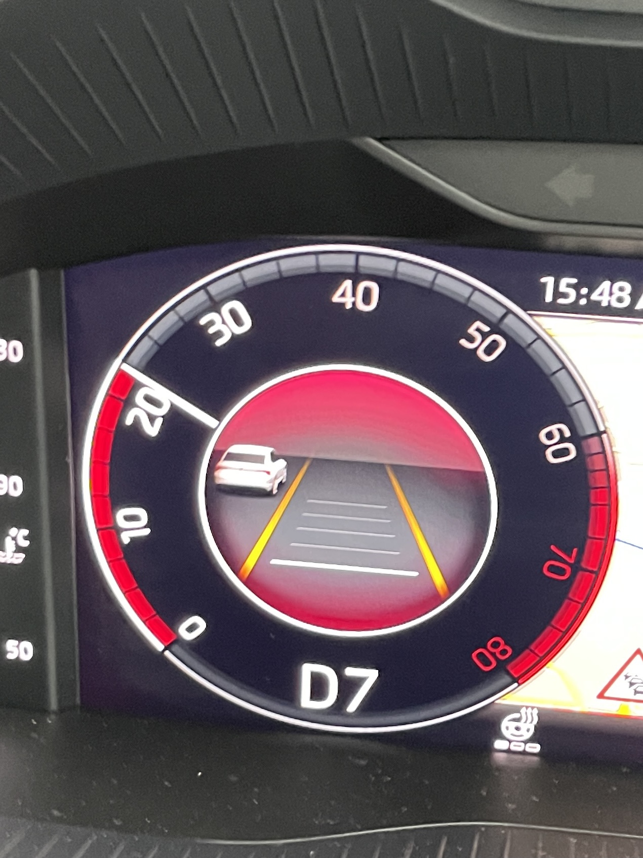

Yesterday while driving it reset the headlights to driving on the right and would not let me set them back, maybe not letting me as I was driving at the time, and also the road signs were displaying in KPH a few times.
On the return journey I checked the lights were set for left hand driving but on the motorway, with the ACC on, it was slowing me down when I was trying to pass cars, as if it thought I was undertaking not overtaking, see photo.
I have had it slow me down when I was coming up to a car and it was like I was going to undertake but the car image was on the other side of the display.

I had a similar issue with an Audi A6 a few years back, it would show roundabouts in the display the wrong way round, and randomly state distances in KM rather than miles.  Took it to Audi who suggested a map update as the tune of a few hundred pounds, I promptly refused and asked they check for a system update.  They reluctantly did this, and surprise surprise it fixed it!
If I were you, make sure you've got a picture or video (like you have) and then ask Skoda to check and update.... I don't have my Skoda yet, it's still being built, but once it's here I can check I've gone for the digital dash too!
You can turn off the undertaking restriction using OBD11 which mentions left or right side, so presume the side of the road setting overall is in there too.
But as newish dealer should be sorting this for you.
There must be a way to disregard recognizing road signs and assuming a change of country too. I could see how having MPH and KPH signs in the same country would be a bit weird for the car though.

I had the same problem. lights setting are correct - left hand traffic selected. But when on ACC car slows down even when I am overtaking from the right (am in Cyprus so we drive on the left side of the road).
restarting infotainment did not alter the result. Have a MY21 with MIB3...
