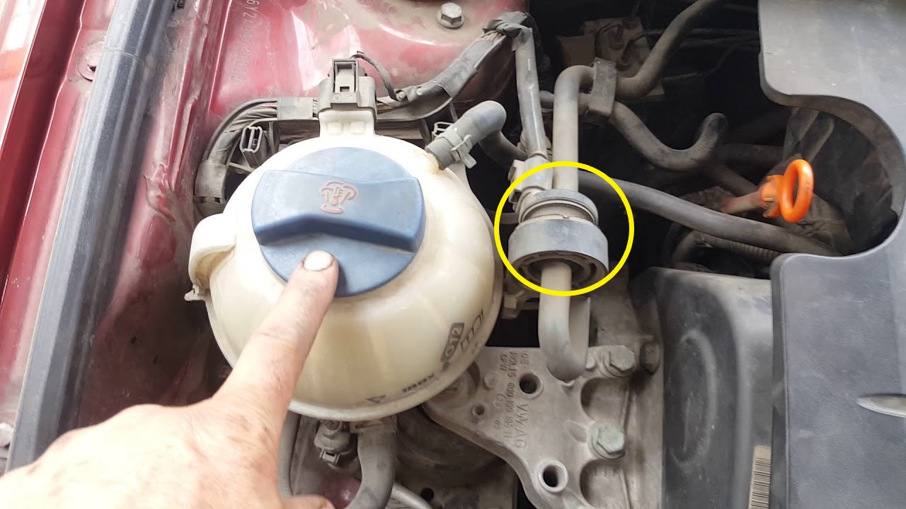

N80 evap purge solenoid valve is on the left. Wondering if it might be coming from that.
Does it sound anything like this?....
Thanks for the reply, it doesn’t sound like that it’s not a constant sound, and from what I’m finding it’s only on start up (cold engine) I’ll try and get a recording tonight. It’s a mk1 1.9vrs so quite a loud engine in fairness..... but it’s just a mechanical click sort of sound
